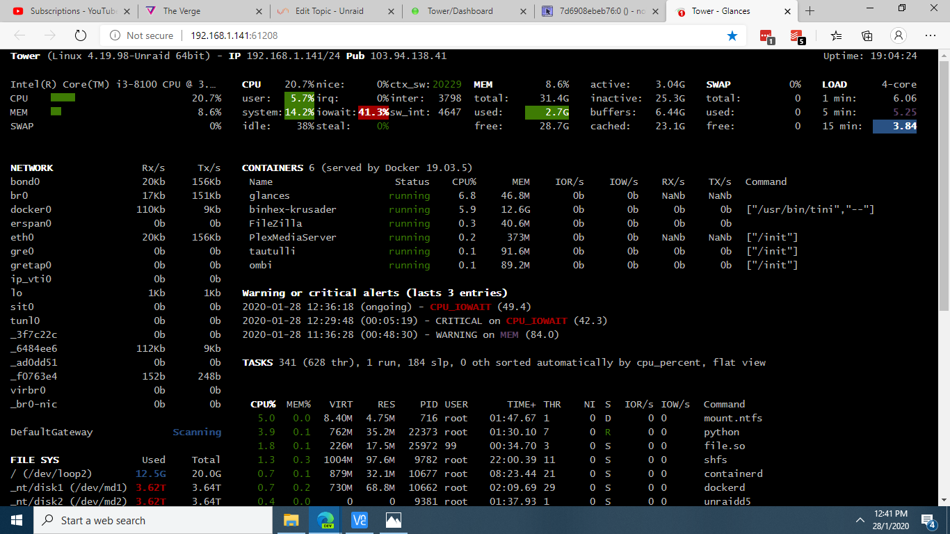

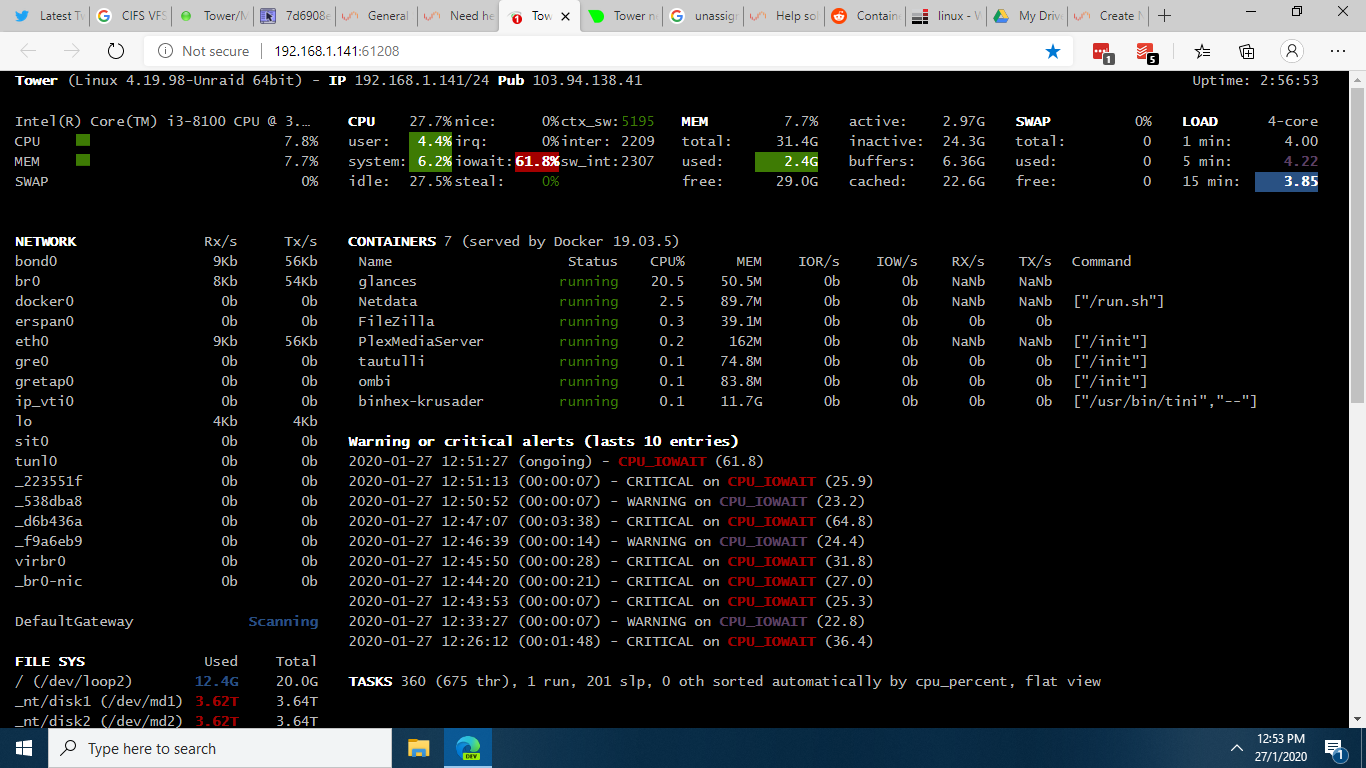

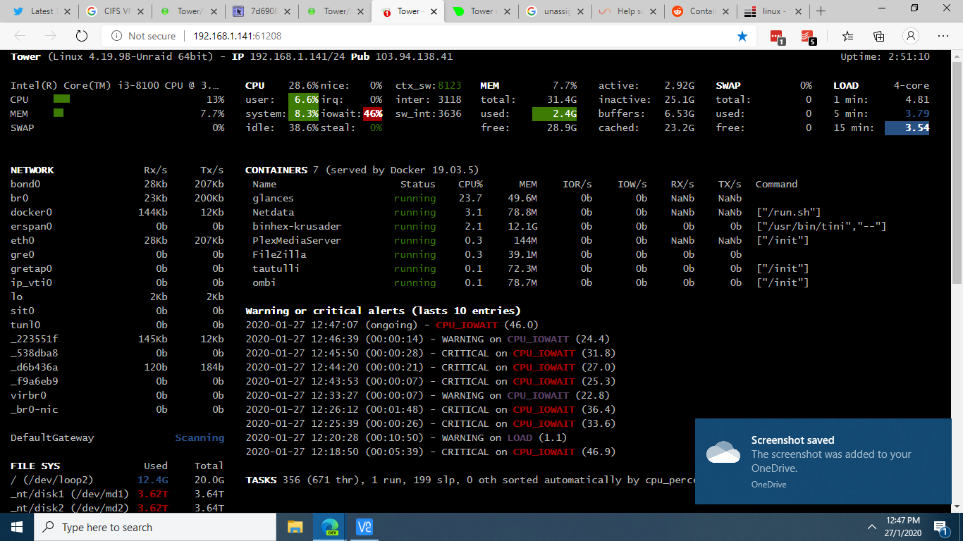

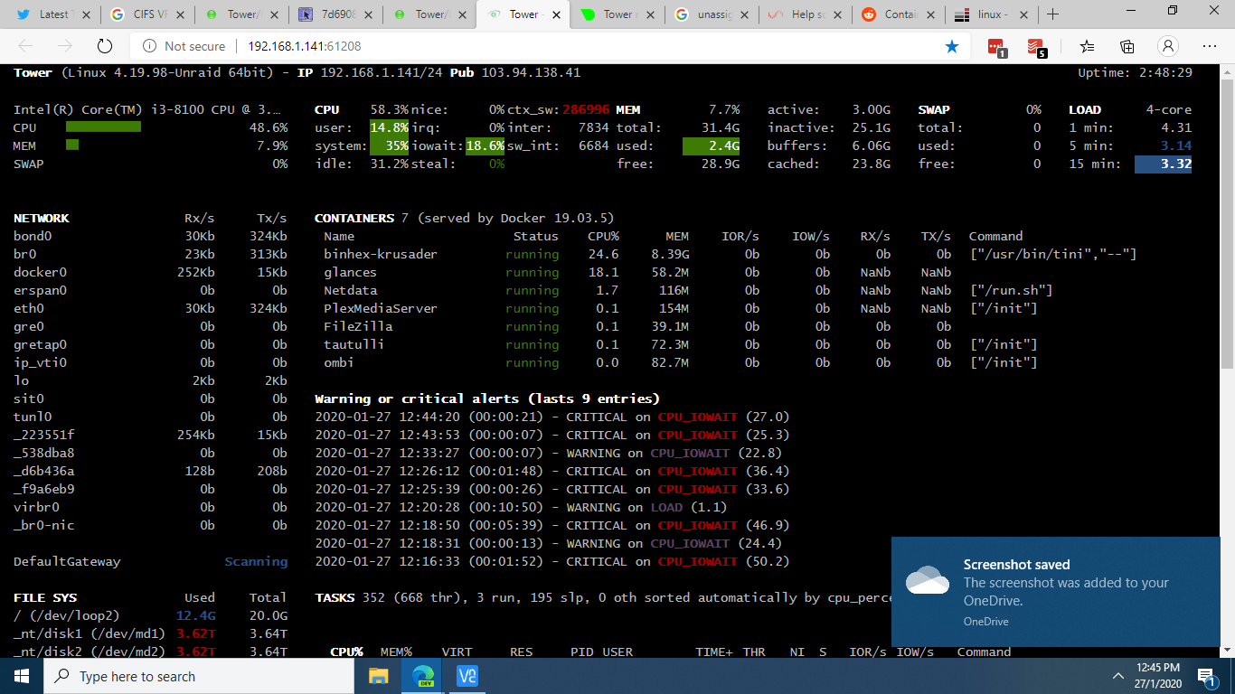

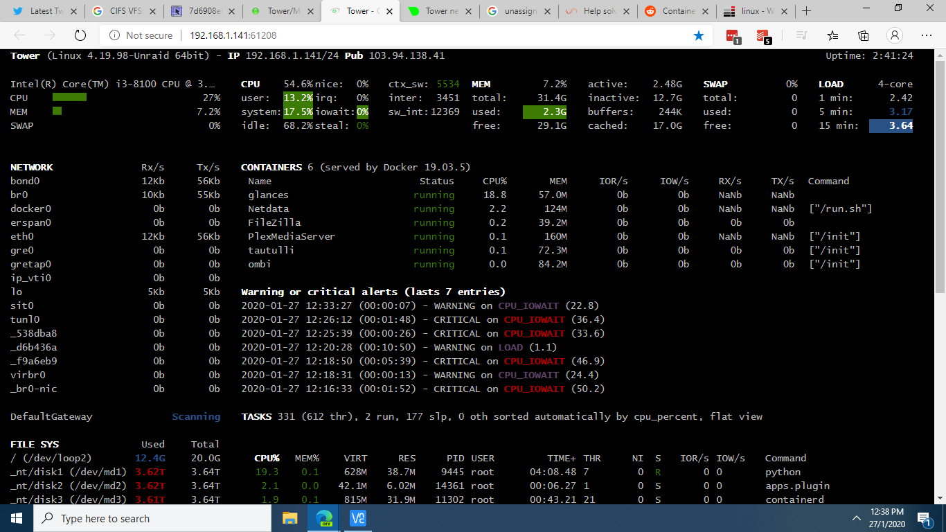

When I mount an External USB HardDrive via unassigned Devices it creates large IOwait
Before Mounting
After Mounting

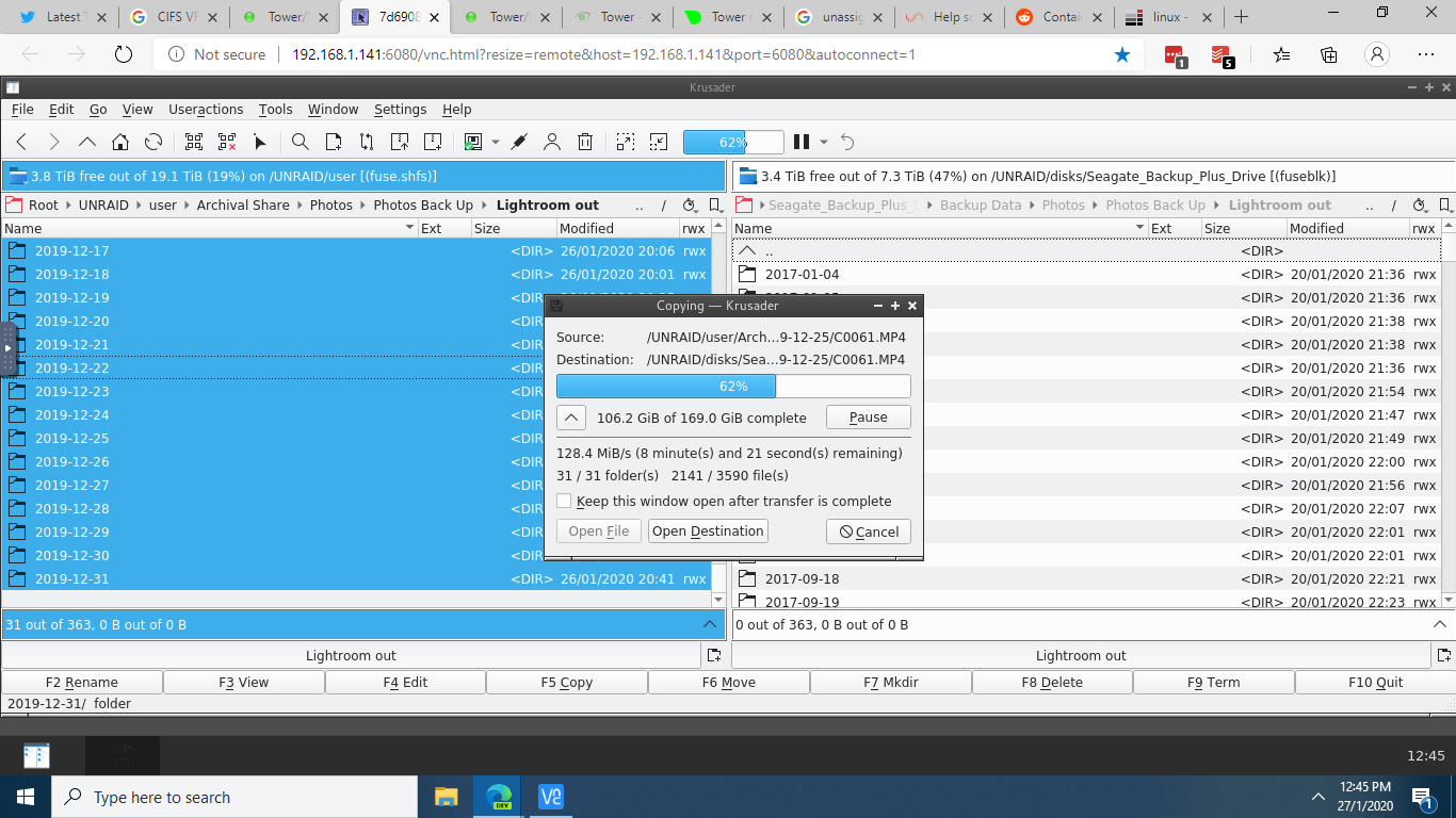

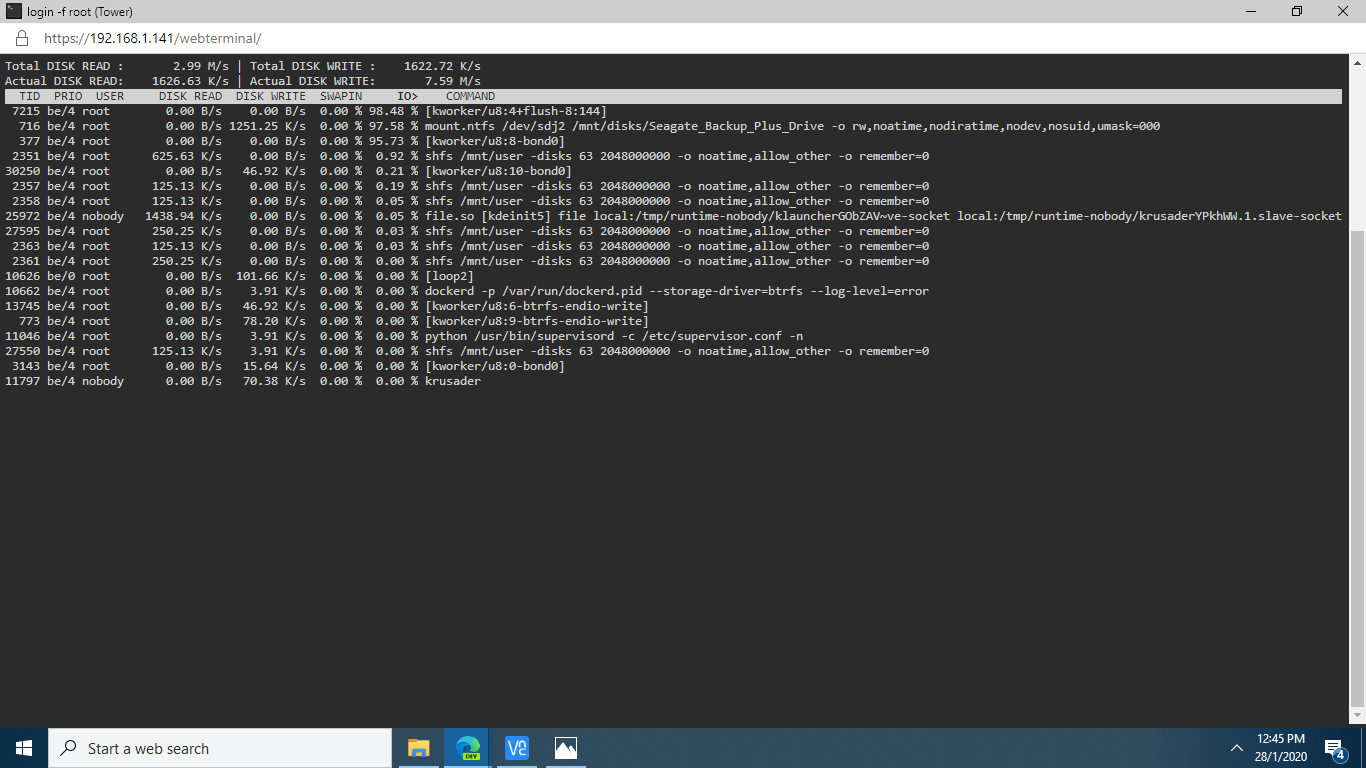

I'm mounting this drive to transfer some data from the unraid array to the External Drive using binhex-Krusader. These screenshots are from before I've started any transfers. Once I start a transfer it will copy at a good speed for a while
Then IOwait will go up and the transfer speed will crash
Even after I pause the Copy the IOwait times don't go down
When I dismount the Drive the IOWait goes down to Zero

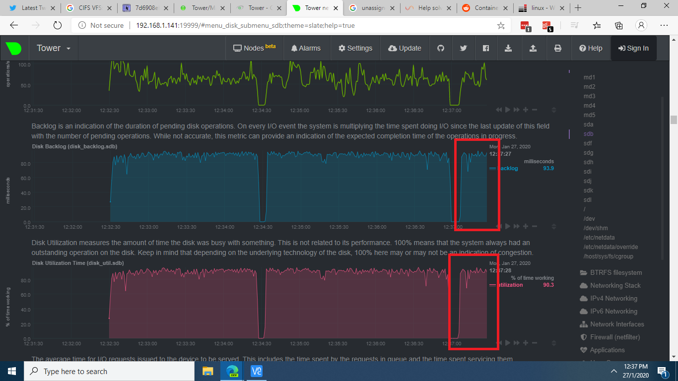

The backlog and drive utilization shoots up immediately when I remount the drive

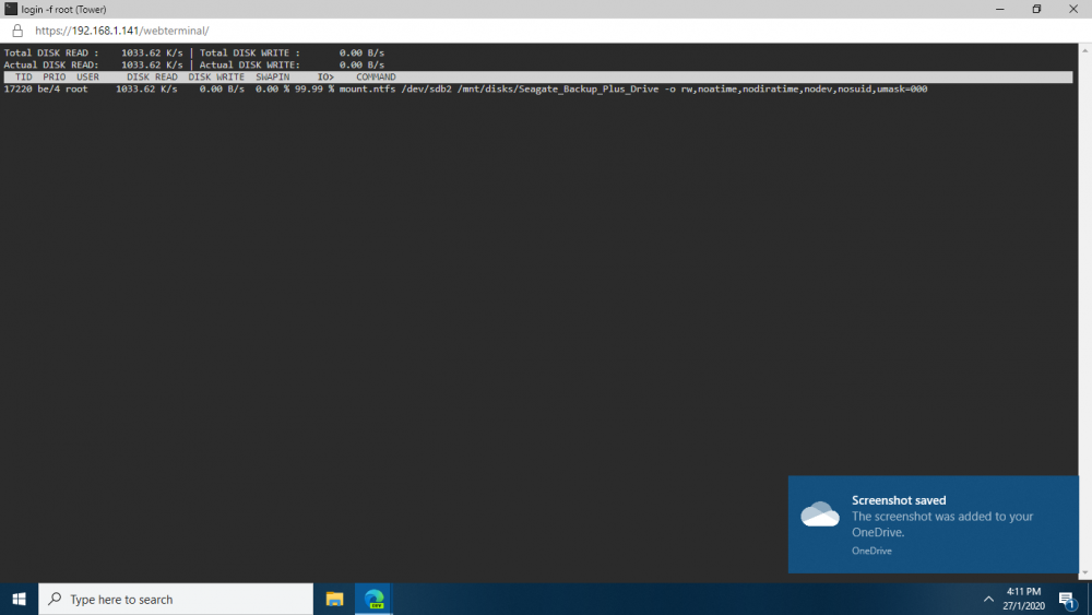

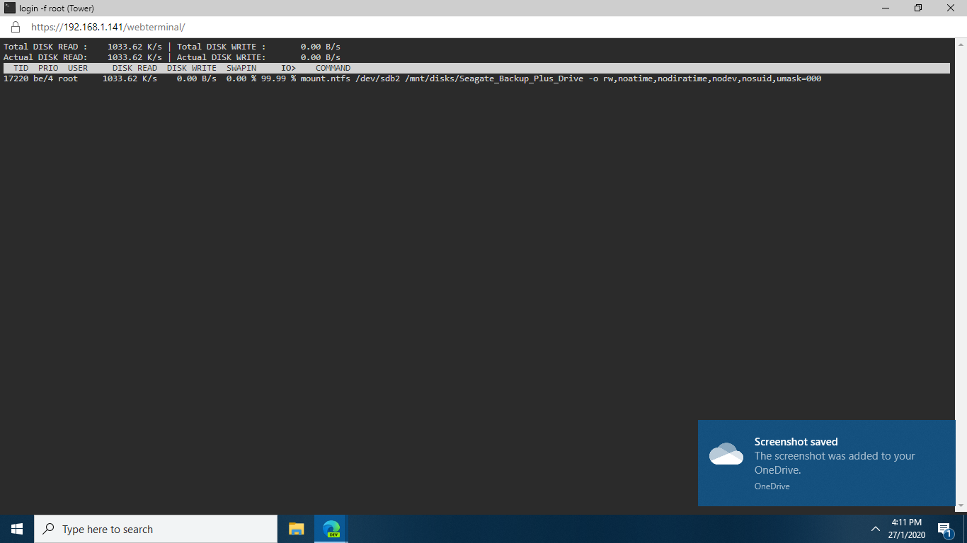

Edit :
iotop while drive mounted and with NO file Transfer(Not copying files with Krusader)
Edit 2:

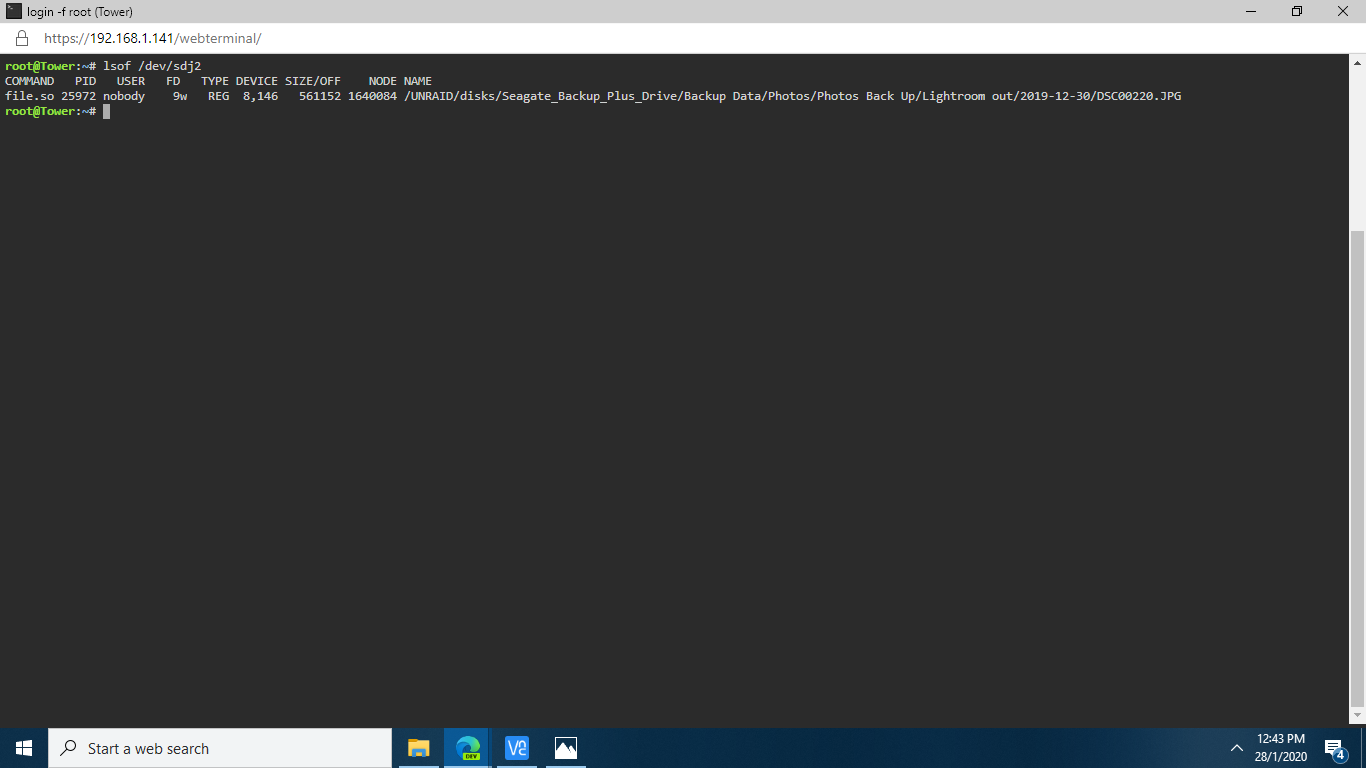

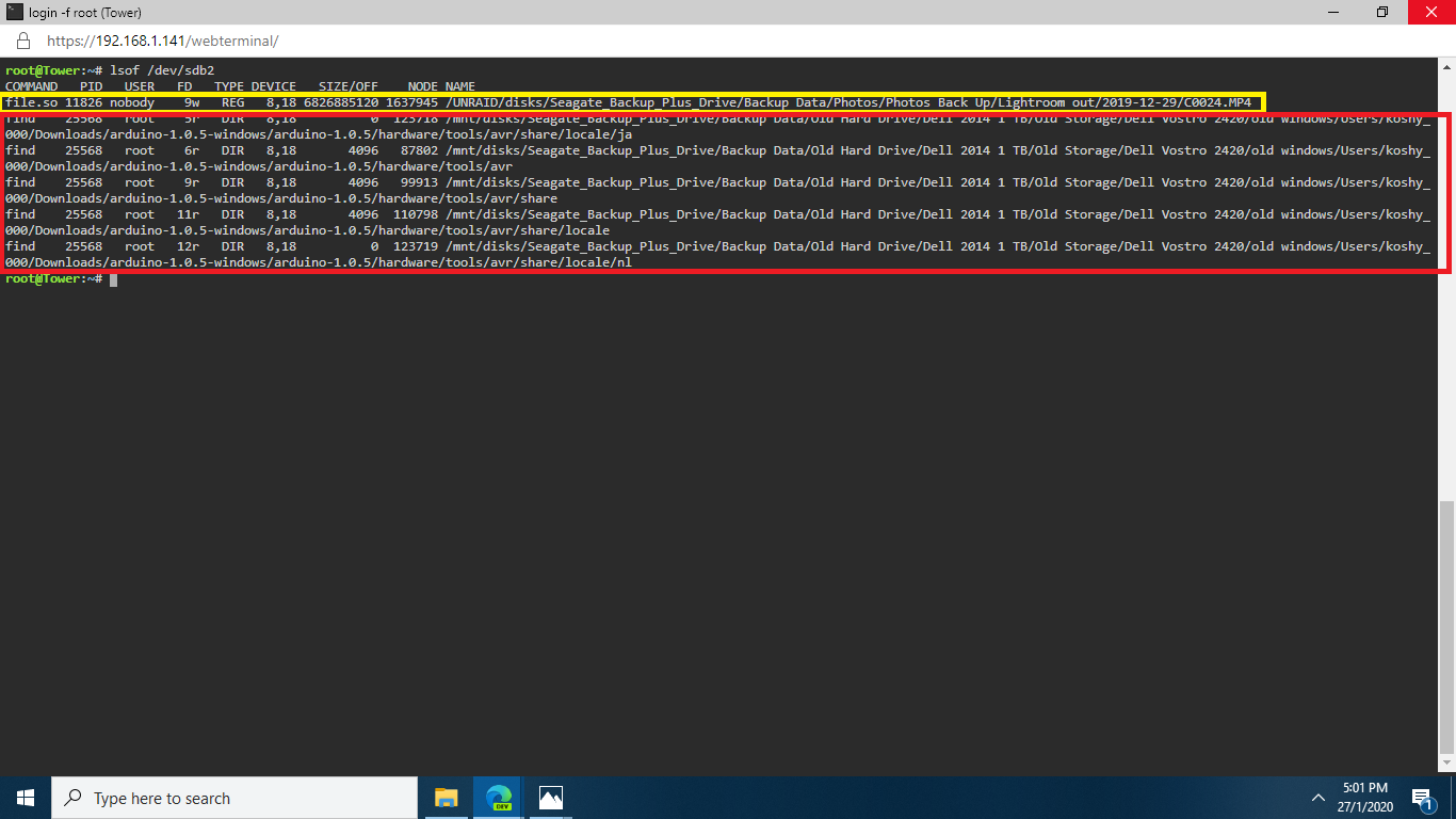

lsof shows unrelated files being accessed. The file that is being copied is in the Yellow Box, All the files in the Red Box are untreated to the Copy
Edit 3:
This is when no transfer is taking place. These random files are being accessed from my mounted external USB Hard Drive.
Edit 4:
It was dynamic cache dirs scanning the drive that was the problem. Thank you robobub [https://forums.unraid.net/profile/100006-robobub/] for figuring it out. I excluded the External Drive from the Cache Dirs and the problem is now resolved.

I think this was only a partial fix. I'm still getting High iowait and slow transfer speeds.[I'm getting faster speeds than before that is between 2 and 35 MegaBytes per second once it has slowed down earlier I was seeing speeds in the KiloBytes per second or even Bytes per second after it slows down and iowait is staying below 50% earlier I've seen it go to upto 65%]. I'm not getting hit with high iowait before transfers but after some minutes after I start a transfer the issue returns.
lsof isn't showing other unrelated files being accessed though
image.thumb.png.c16924fc4ea6f7b29cd906fcc8d17e7c.pngimageproxy.php?img=&key=e5eec7c5c933ca16
iotop
Edited by Koshy

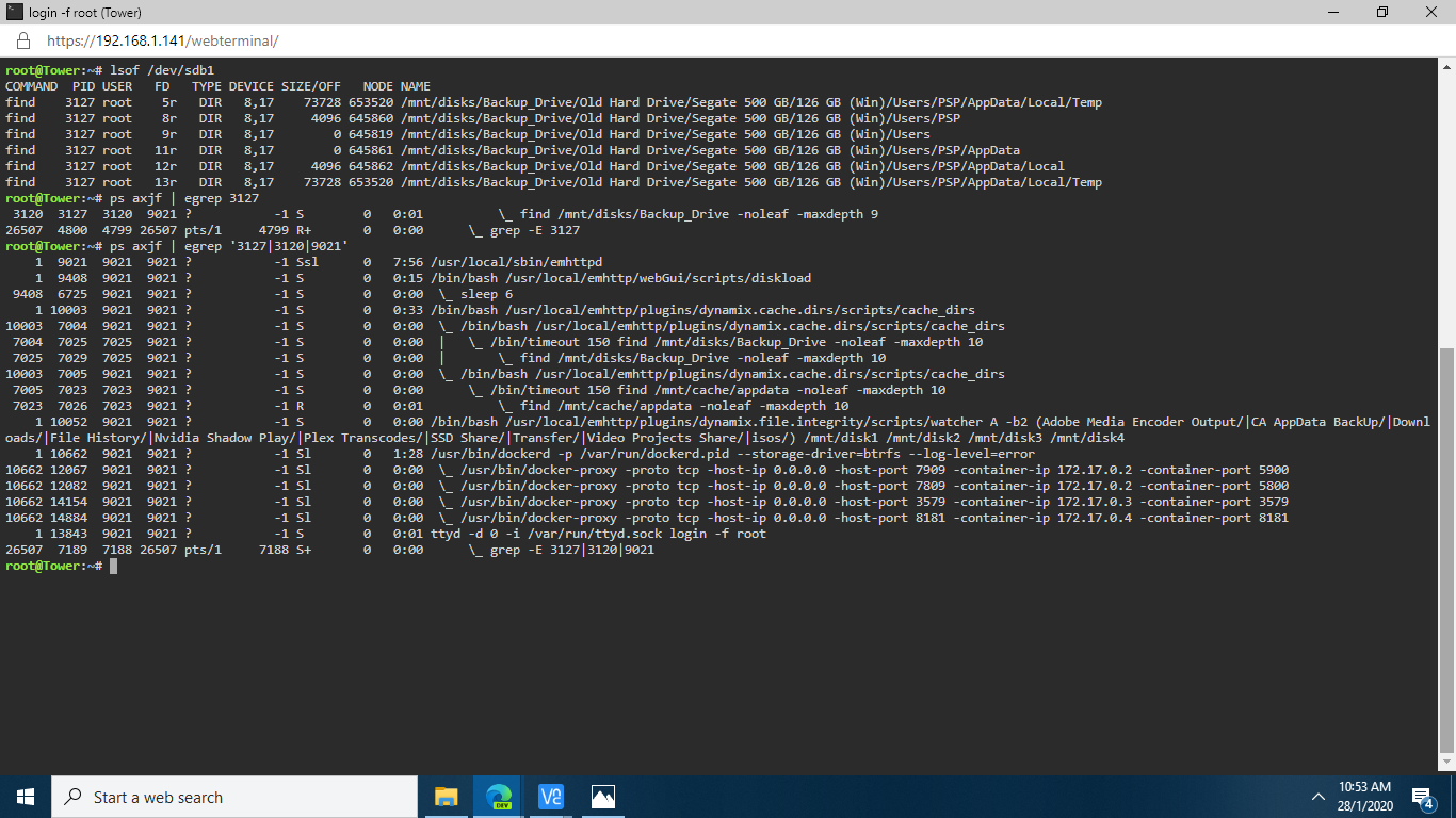

Something is scanning your /mnt/disks/Seagate_Backup_Plus_Drive with the command find with PID 25568 (the 2nd column in your screenshot, PID)
This doesn't show up on your diagnostics what process it is and what spawned it.
You can try to trace what was running by running
ps axjf | egrep 25568
The first 4 columns will list other processes associated with it, so then you add that to the egrep command.  If any of the columns are 0,1,2, I would exclude it as it is one of the root processes.
ps axjf | egrep '25568|<column 1>|<column2>|<column 3>'
The process number 25568 could change, so make sure to run lsof again to find out what command and PID is currently accessing it.

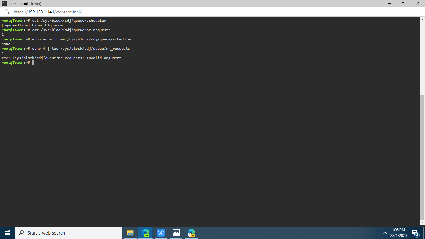

 Also, the command I listed earlier to change the schedulers doesn't work.  Forgot that you need to use tee if outputting to multiple devices.  Though of course what I mentioned earlier about finding what is scanning your drive is more important.
# Change all of them excluding the flash drive with sd[b-z], or enumerate specific ones with sd[b,c,e]
# note, changing scheduler will change nr_requests
echo none | tee /sys/block/sd[b-z]/queue/scheduler
echo 4 | tee /sys/block/sd[b-z]/queue/nr_requests

Here is what I got.

You can see what is launching that find process by going up a few lines: dynamic cache dirs plugin.
Add your external hard drive to the excluded folders path of that folder caching plugin
That Fixed it Thank You.
I get this when I try that
Edited by Koshy
cat /sys/block/sd[b-z]/queue/scheduler
cat /sys/block/sd[b-z]/queue/nr_requests
With that command you can check the values.
