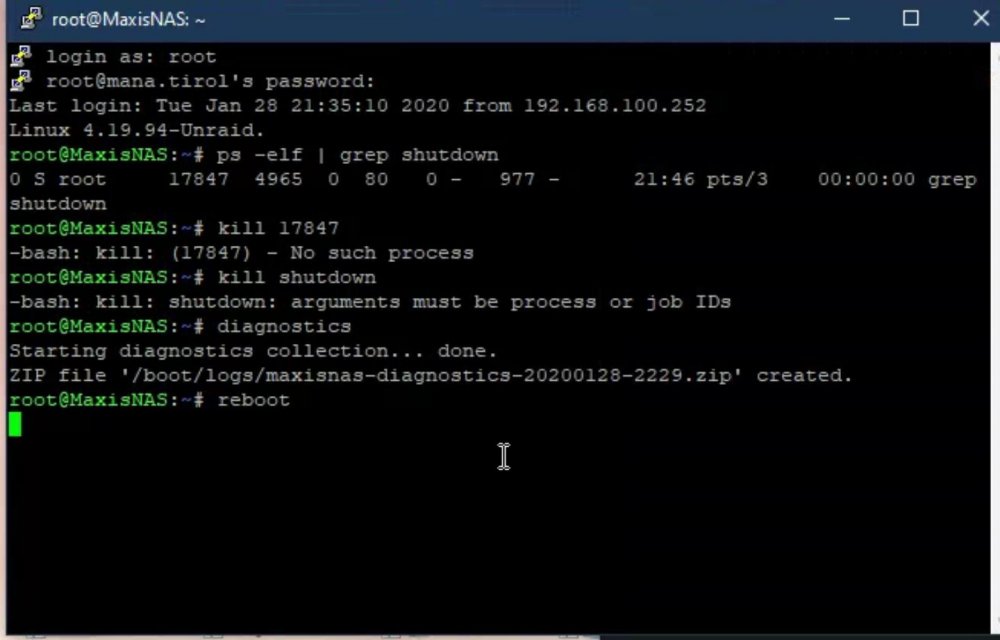

I tried to kill all open processes but can´t find the problem and also can´t get to the NAS in the next 2 days, so I have to reboot it from command line - which is still working.

So still no reboot from terminal possuble?
Type reboot if it doesn't work after a few minutes you'll need to force it.

Yes tried it via putty. I can do diagnostics, but not reboot.
Its stuck like this since yesterday. I tried to kill some processes, didnt help at all
