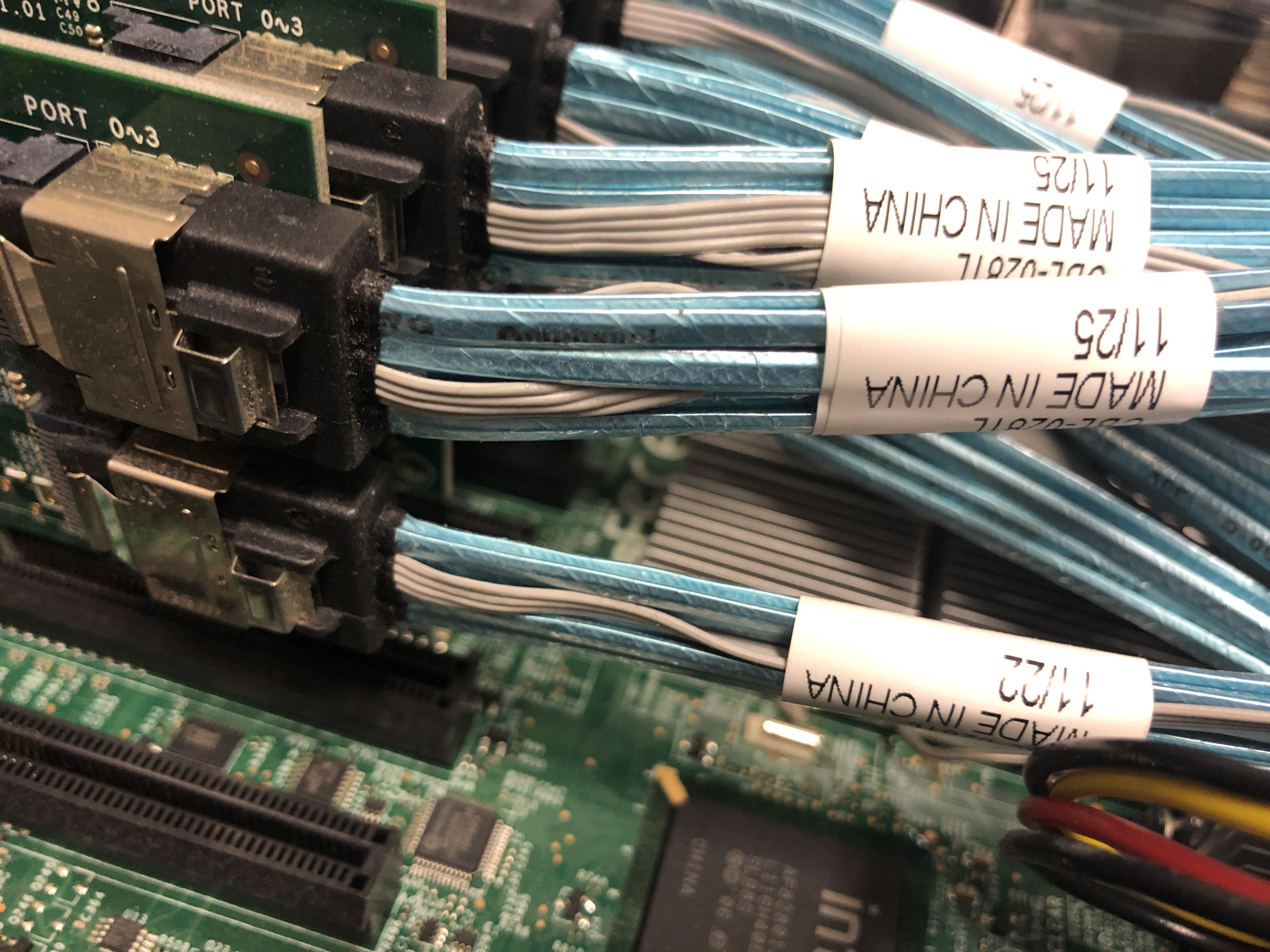

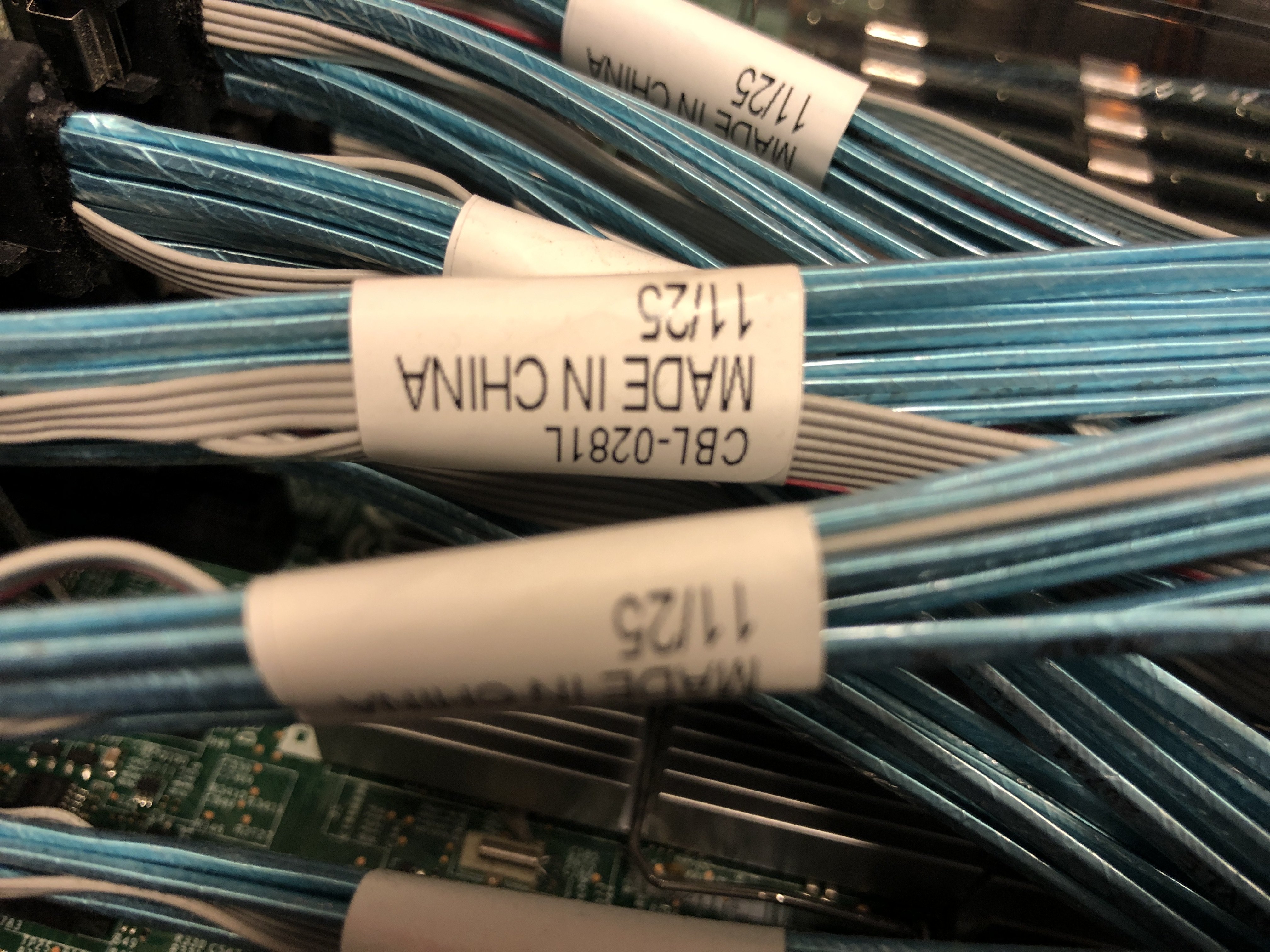

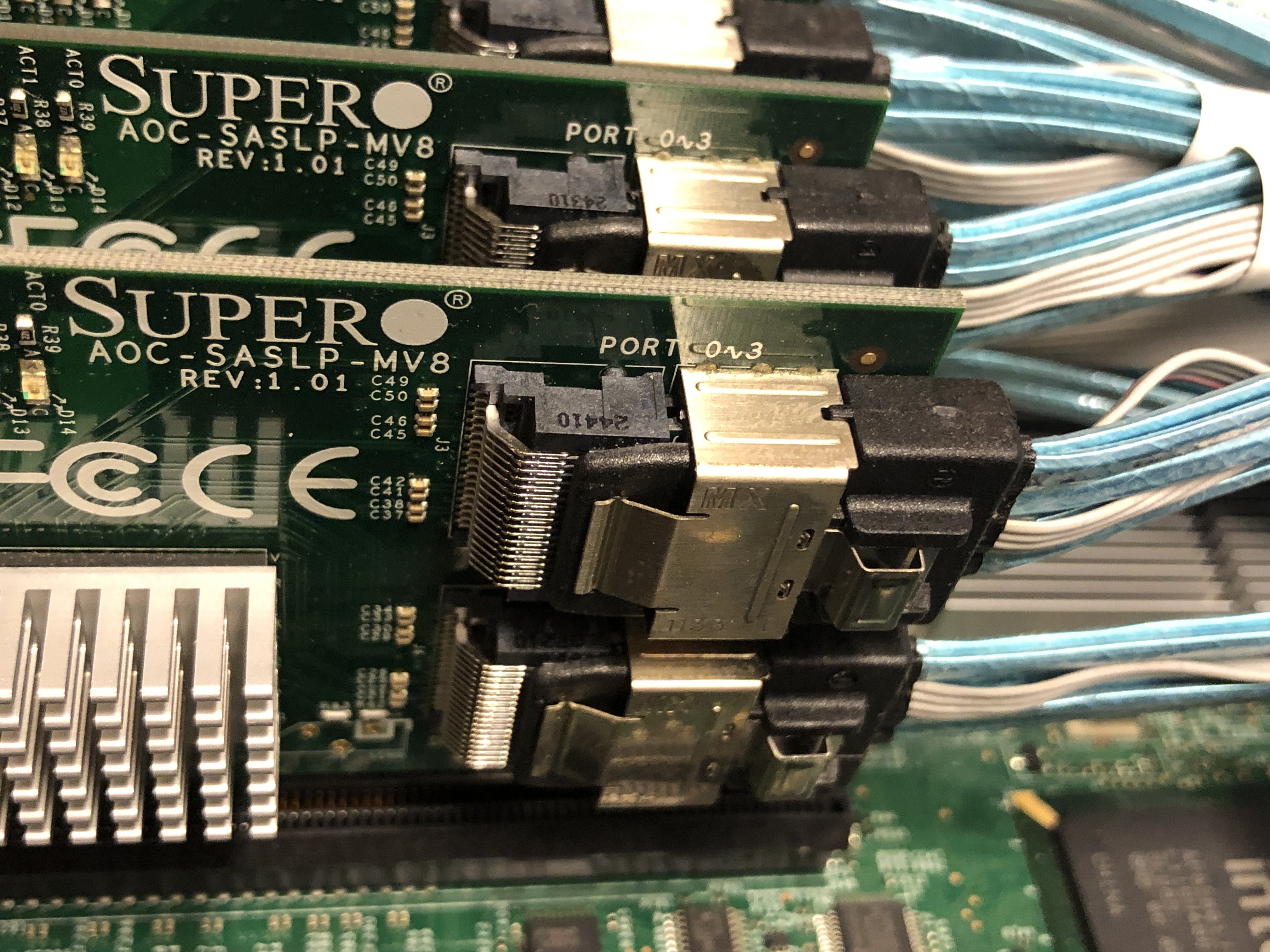

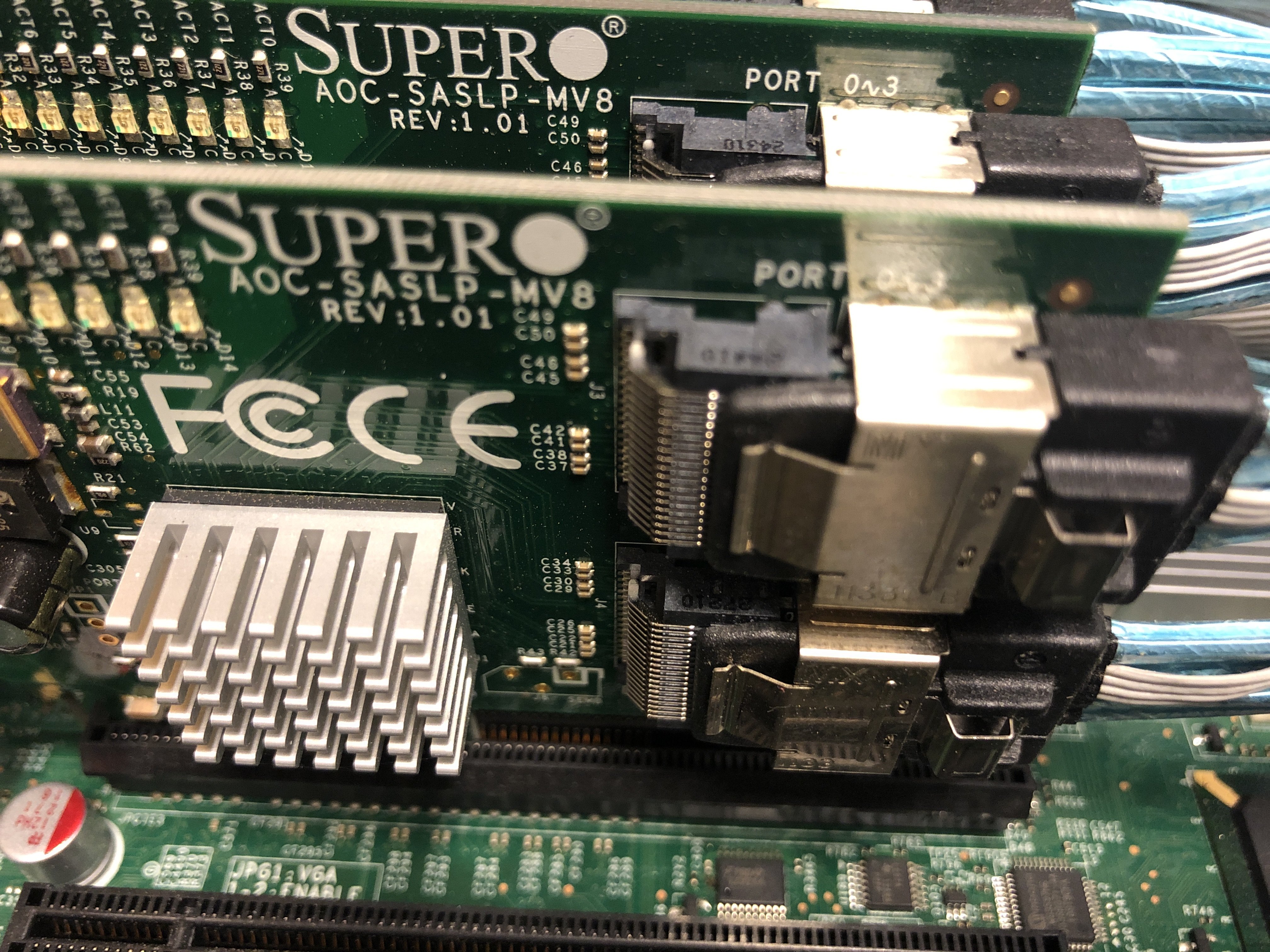

January 29, 20206 yr Author From what I can see I have these controllers, are they sff-8087 ? https://www.supermicro.com/en/products/accessories/addon/AOC-SASLP-MV8.php Add a few photos too here...
January 29, 20206 yr Author Reading a bit more - yes it seems they are SFF 8087 - which is great as the cables would be quite a work to exchange. It would have required me to disassemble most of the server... Edited January 29, 20206 yr by Kjetil
