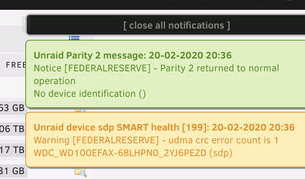

I got this error message on one of the discs that was unassigned (which was the disc number 22 in the server).
  • Replies 58
  • Views 4.6k
Shall I just start the server again and let it rebuild (with this error on disc 22) ?
CRC Errors are connection issues not drive issues. The counter won't reset, but you can acknowledge the SMART warning by clicking on it on the Dashboard. You will get another warning if the count increases.
Continue with rebuild
