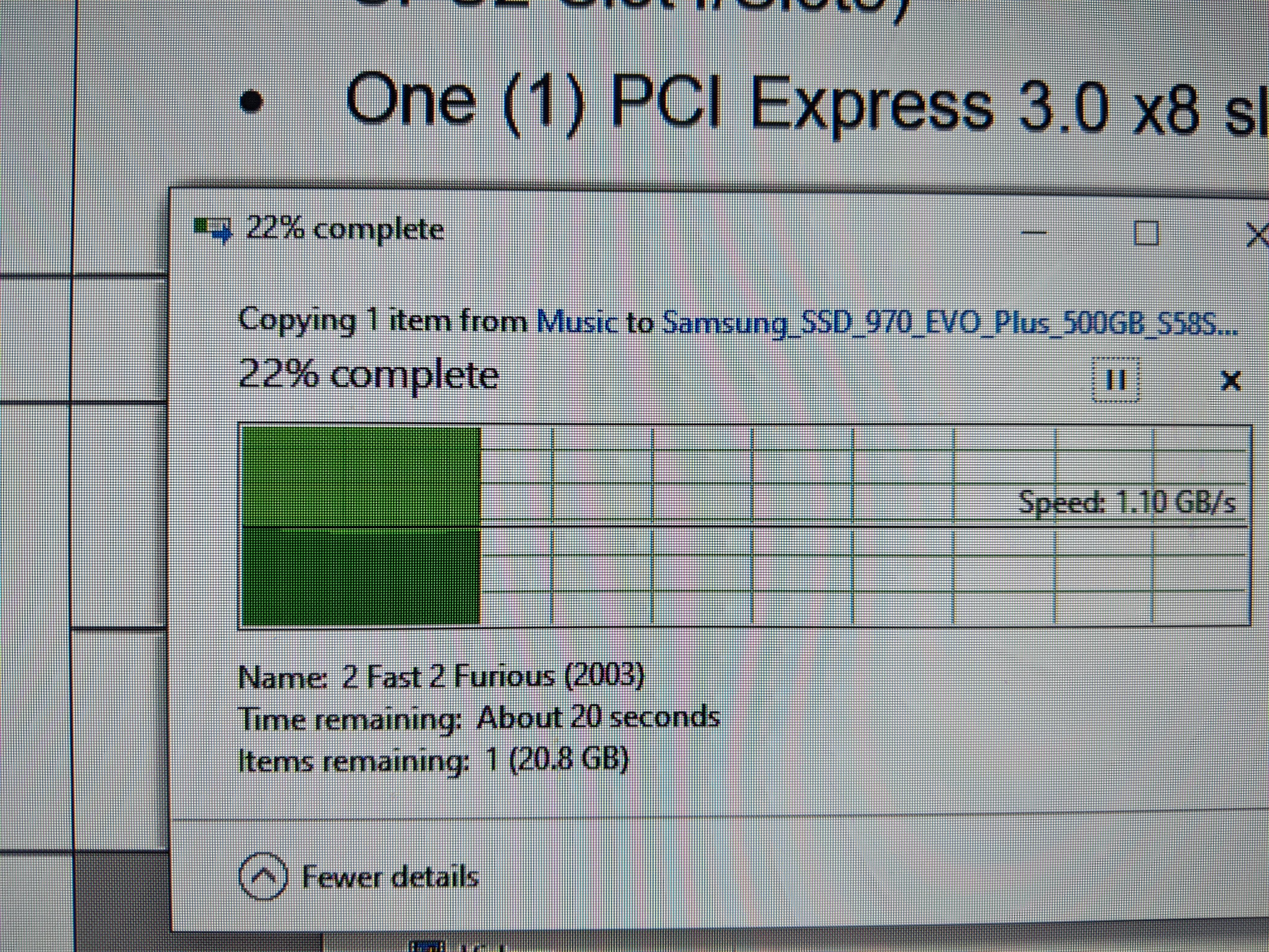

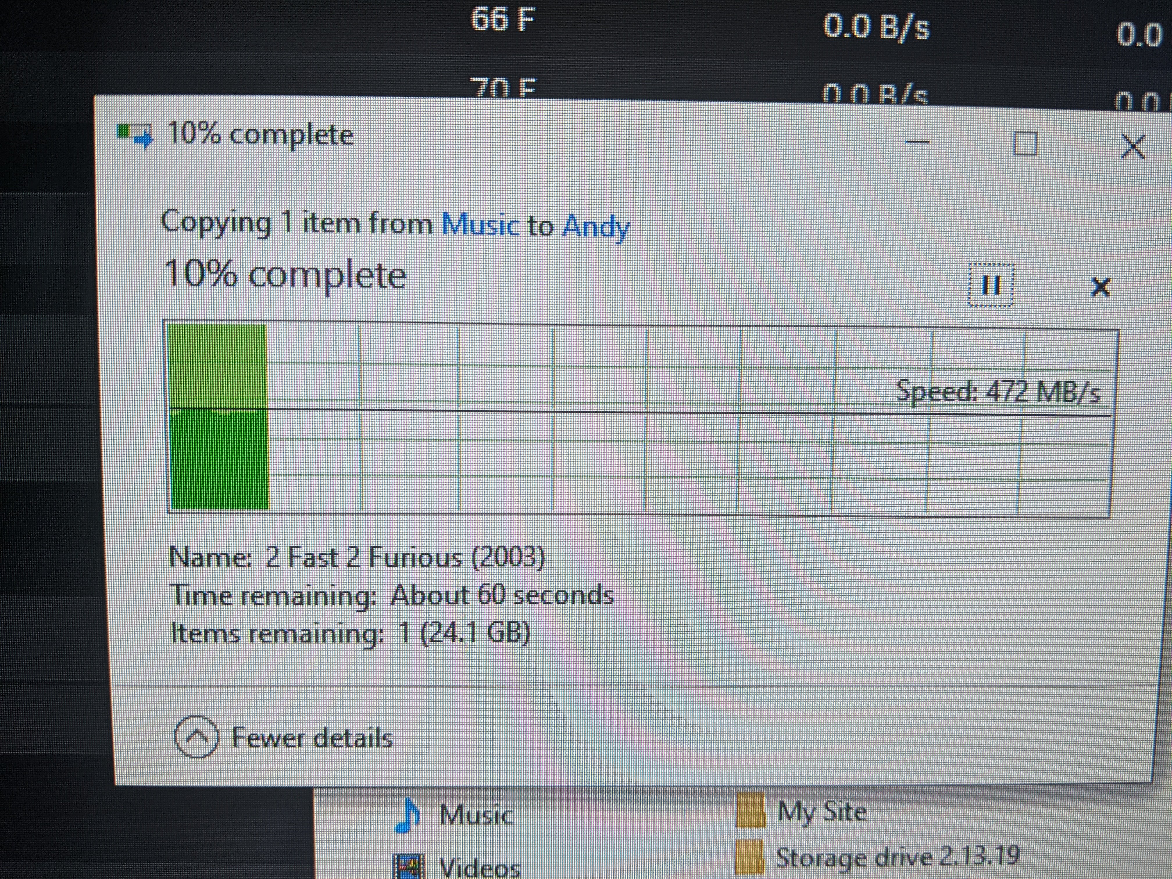

I have been doing some testing with the cache. Drive is a Samsung 970 evo plus 500 GB NVMe new on 1/25/2020. Data being transferred is on a very fast NVMe drive as well. Data is a 27 GB mkv file. The 970 not set as cache drive mounted and shared with unassigned devices the file transfers at 1.10 GB/s. Forget to mention 10 GBE network and Unraid version 6.8.2. I set the 970 to be the cache drive transfer same file I get the speed of 450-500 MB/s say 470ish MB/s. Also no other data on cache drive Docker and VMs turned off and only one share set to use cache only for testing. I remove from cache mount and share with unassigned devices plugin again bam right back to 1.10 GB/s. I also formatted btrfs when used under unassigned devices so file system was the same for both. attached Pictures of both speed. Does the cache really have near a 50% performance overhead? This would not be noticed on a 1 GBE, just a heads up for anyone thinking of going 10 GBE. Not that 450 MB/s is bad you just wont get the full 1 GB/s speed.
P.S. I apologize if this has been discussed already I spent two days here reading forums and couldn't find anything

It's shfs (i.e. the magic behind /mnt/user). Any io going through shfs won't exceed about 450MB/s (about 500MB/s for multiple streams from my own testing), which people won't notice for SATA SSD and HDD but certainly will with NVMe cache.
The way to have your cake and eat it (i.e. have NVMe in cache + bypass shfs for network transfer) is to access /mnt/cache/ directly. This can be achieved by enabling disk share or creating custom smb config.
Also, for cache = only shares (e.g. appdata, vdisk etc.), you should point the docker / VM paths to /mnt/cache instead of /mnt/user.
