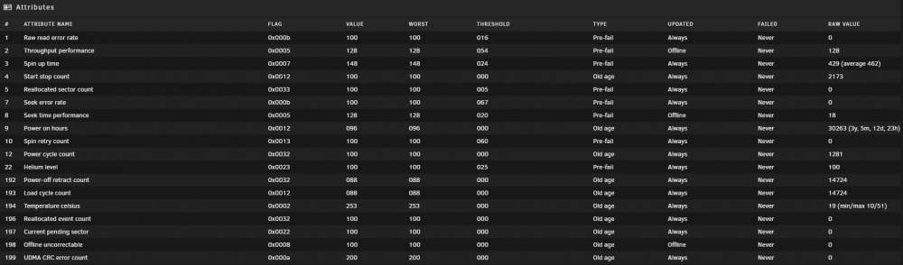

Looking at the smart data:

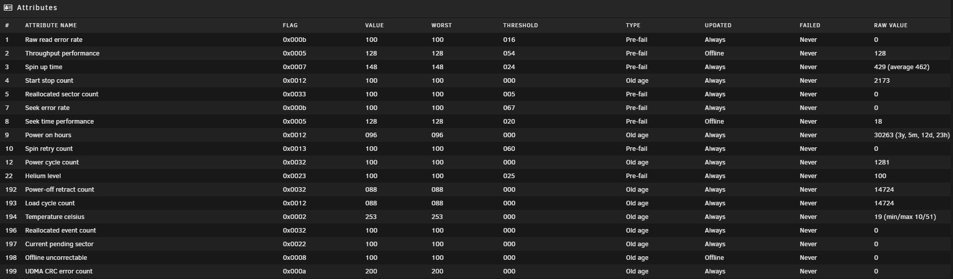

and on the overall status page:
Do I need to change some settings, since I didn't get a FAIL in the daily report?

Please post a full smart report of disk10, according to the screenshot helium level attribute is not and never was failing.

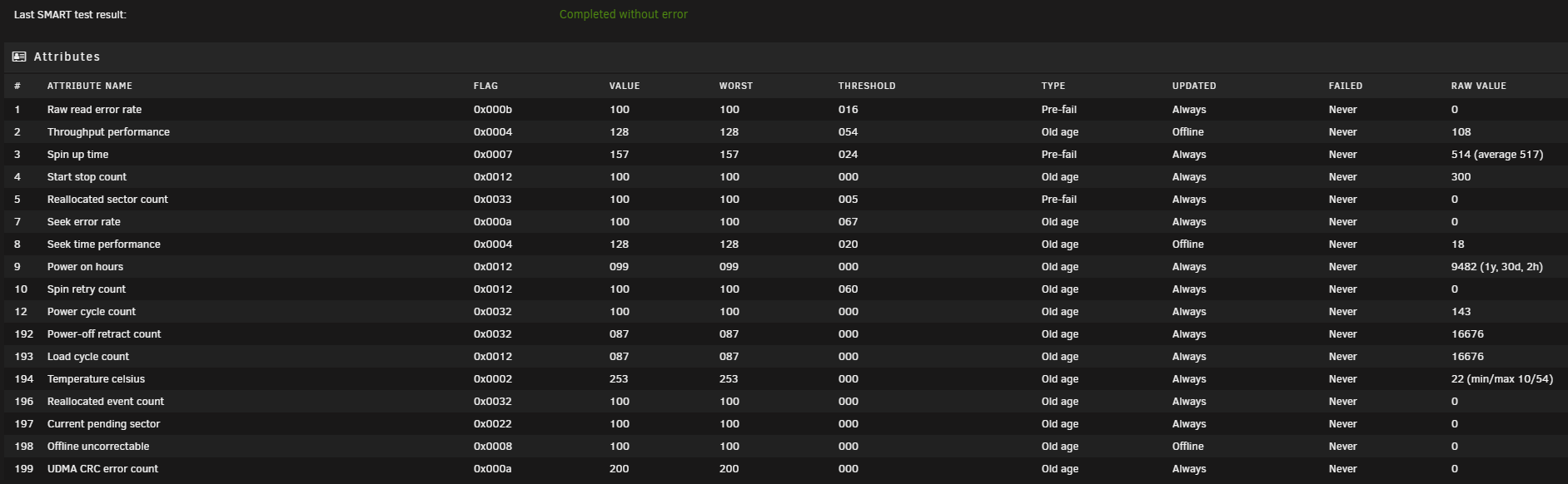

I just noticed that one of the WD drives same model does not show any Helium status on the SMART status?
It's not the same model:
WD80EFZX-68UW8N0 - 1st gen helium filled model
WD80EFAX-68LHPN0 - 2nd gen helium filled model
WD80EFAX-68KNBN0 - newer air filled model

Most likely, that disk look fine, unless there's a firmware bug which I find very unlikely.

Right! Same size not same model! - Should I be concerned about the type: Old Age?

No, what matters is if the attribute is failing on not, now or in the past, the "failed" column.
