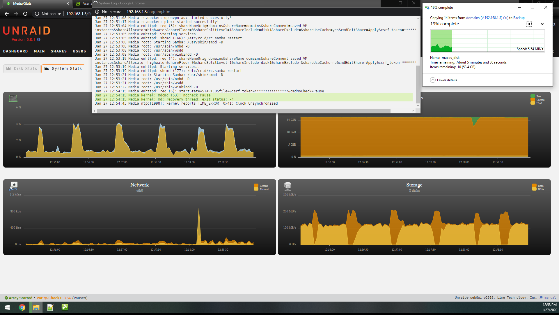

For a couple of weeks my server has been crashing, typically when there is a larger file transfer going on but it can also just happen unprovoked (perhaps mover running overnight, but there have been nights where it crashed and mover did not need to run). This happens with Windows File Explorer via SMB, UnBALANCE, and occasionally MC. I usually have zero issues copying from a share to my Windows machine, however the opposite as well as share to share causes crashes frequently.
There is also weird behavior where my file transfers have a consistent pattern of dropping down to 5.54MBps, periodically shooting back up to 120-150MBps. Usually when this occurs, I expect my whole server to crash at some random point through the transfer.

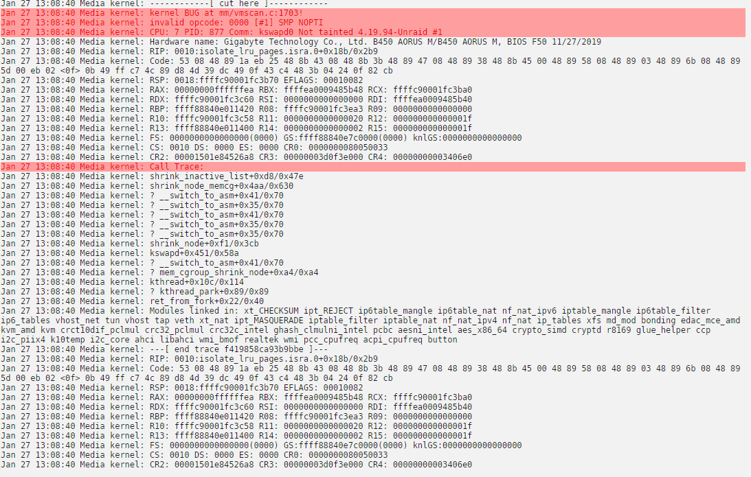

I'm unsure of what step to take next, I have attached diagnostics, two logs of when the crash occurred, and a screenshot of the behavior I was talking about.

Diags are just after rebooting, so not much to see, see here to enable syslog server/mirror, it might catch something more, still a couple of observations:
25 minutes ago, Jared24 said:
Ryzen 2700X
Ryzen on Linux can lock up due to issues with c-states, make sure bios is up to date, then look for "Power Supply Idle Control" (or similar) and set it to "typical current idle" (or similar), or completely disable C-sates.
More info here:
https://forums.unraid.net/bug-reports/prereleases/670-rc1-system-hard-lock-r354/
27 minutes ago, Jared24 said:
16GB 3200 Ripjaws
This a big no-no, don't overclock the RAM, some Ryzen systems are known to be unstable and even corrupt data, respect max speed based on config:
