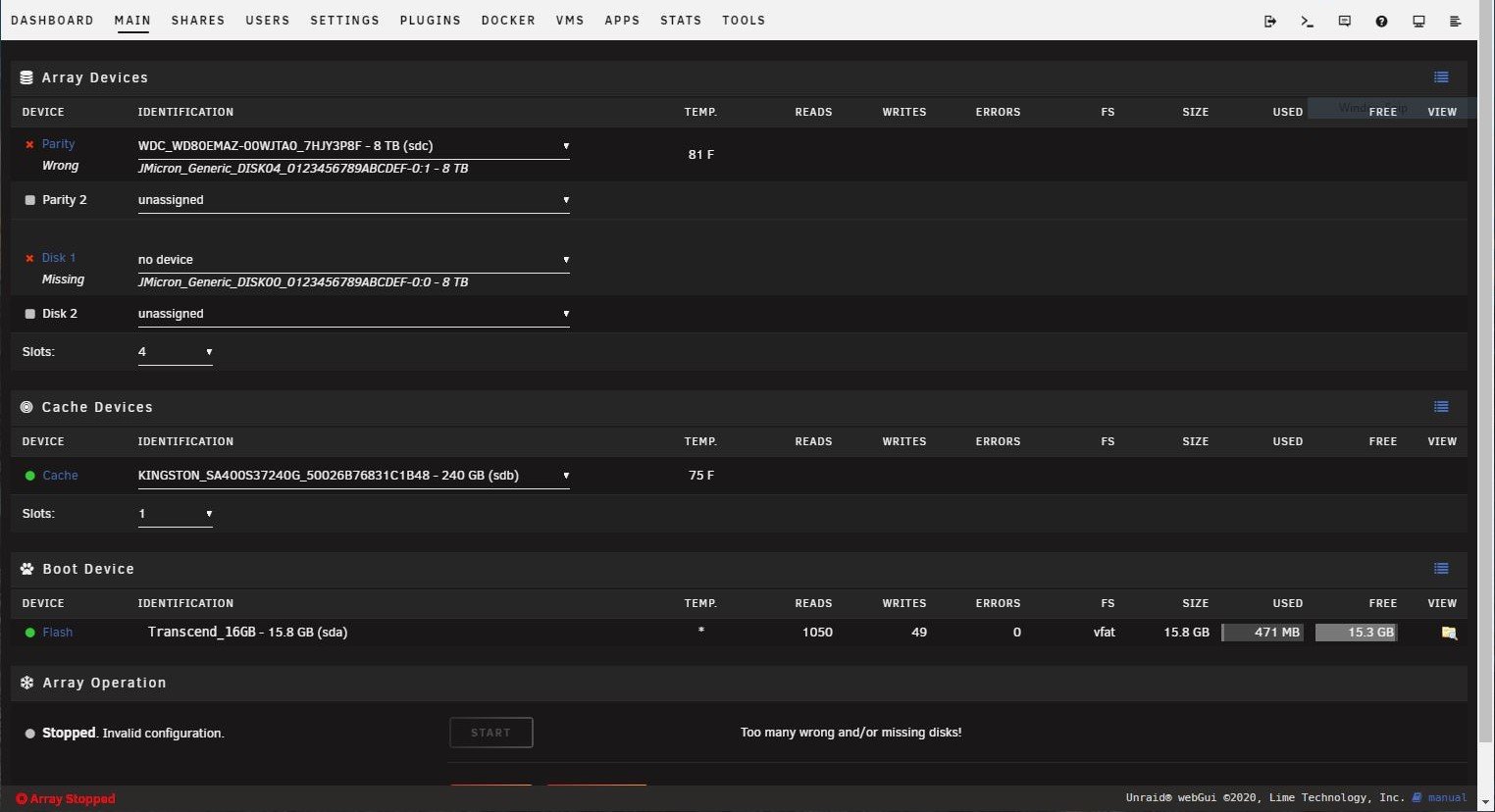

So I was wrong, I'm not seeing an error message per se,  all I'm seeing is "Wrong" with no indication as to what is wrong.
That's because the devices identification changed, if you know which drive is which you can do a new config and trust parity, but then can still have the partition problem.

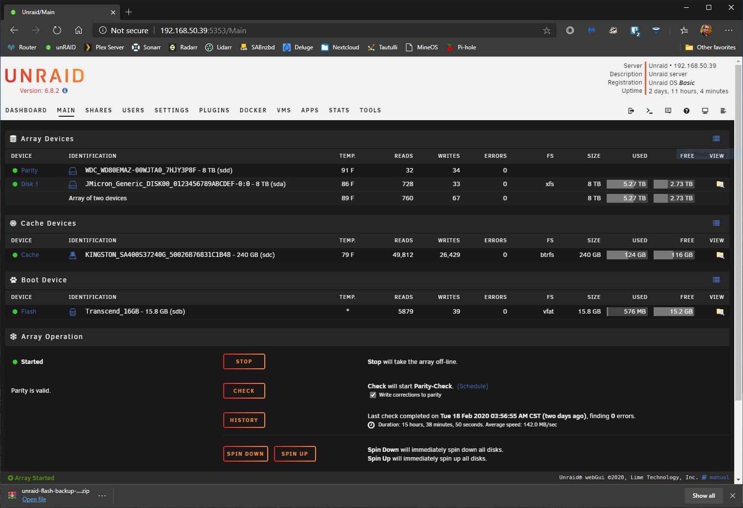

So yes... I'm still working on this. :)

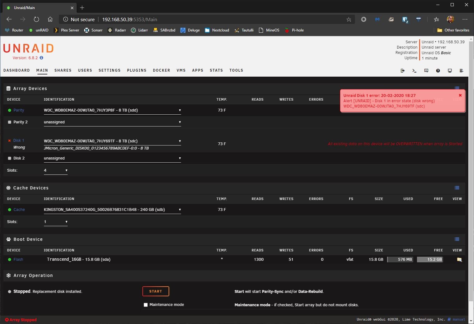

I've attached two screen captures, the first shows the array after I moved the Parity drive and had it do a 14 hour rebuild. As you can see it shows the proper drive name/serial. The main drive, the one that has all my media on it, shows that it will be overwritten. Obviously I'm very nervous in doing anything to the drive that might mess it up. Since the serial number on the main drive, the one that's in a USB house, shows a generic number and not the WD number like the Parity now does, if I just do a re-config will it see the drive and realize that it's been formatted for unraid and find all the files without it being erased?
Like mentioned above the correct procedure here would have been a new config, no need to re-sync parity. (Tools -> New config), but note:

So final report: I did a new config, moved the drive from the USB enclosure to SATA, started it back up and assigned the drives appropriately. Everything came back up fine. It has to re-parity, but I'm fine with that. I just didn't want to lose the data. I appreciate your assistance, tee-tee jorge.
