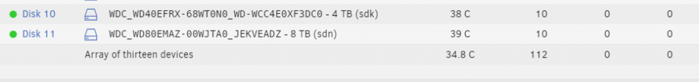

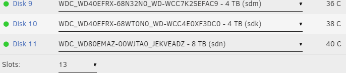

2 hours ago, heisenfig said:
I went ahead and ran the repair with the -L option.  Afterwards I restarted array in normal mode and the drive mounted normally.  Is it safe to assume this drive is perfectly healthy again?
The filesystem is healthy again, the drive always was, there may or not be some lost files, check for a lost+found folder.
Apparenly, that didn't work after all. The drive shows mounted on the dashboard.

After stopping the parity check and stopping the array.  This is the screenshots showing the drive is still marked as assigned to slot 13.  Attached output of "xfs_repair -nv".
Stopped array.
Running array in maintenance mode.
xfs_repair-nv.txt  Didn't show any errors on the drive this time.
Retarted array in normal mode. This drive is still assigned, and all the file are back on disk 11.
2020-02-04_0849
2020-02-04_0852
This is not the same outcome I had yesterday.  When I restarted in normal mode yesterday, the drive was still assigned but had a note on it that it was not mountable due to no filesystem. The only difference is the checkbox for the "correct parity" was check when the parity check ran.
Here's a new diagnostics after restarting the array.
nabit-diagnostics-20200204-0900_afterRestartingArray.zip
Hopefully, this is enough information to determine what is going on with this drive.
