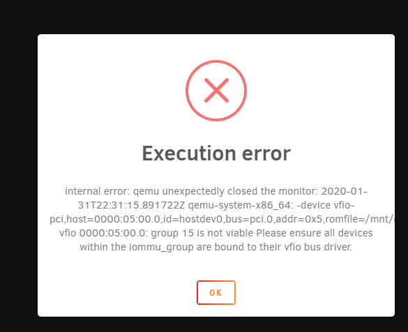

Hey its still not working...
I get this error message now
Thats my VM XML (

Cant boot the VM with this Config...
Thanks for the help!
