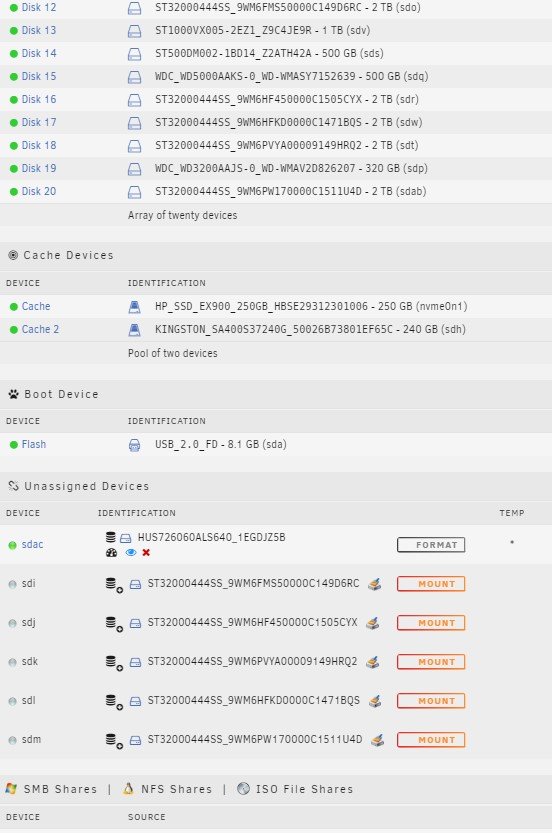

would someone like to help me figure out what idiotic mistake I am making now? I added 5 2tb drives to my array. I pre cleared them and then added them to the array,
with no issues. the next day all 5 drives showed up in unassigned devices again but with different id's. The array seems to be fine, I doubt if these phantom drives are hurting anything but they shouldn't be there and I'm enough of a screw up that having them there opens the door to some horrible operator malfunctions.
Any suggestions are appreciated.

Diags would confirm but that looks like SAS multipath related, Unraid doesn't support that, if you're using some kind of SAS enclosure with dual controllers connect just one to Unraid.
Yes, thank you. I am using an MD1000 with dual controllers I will research steps to use just one. Thank you

You just need to disconnect one of the cables, have just one controller connected to the HBA.
That was tough, step one. disconnect the second controller.
