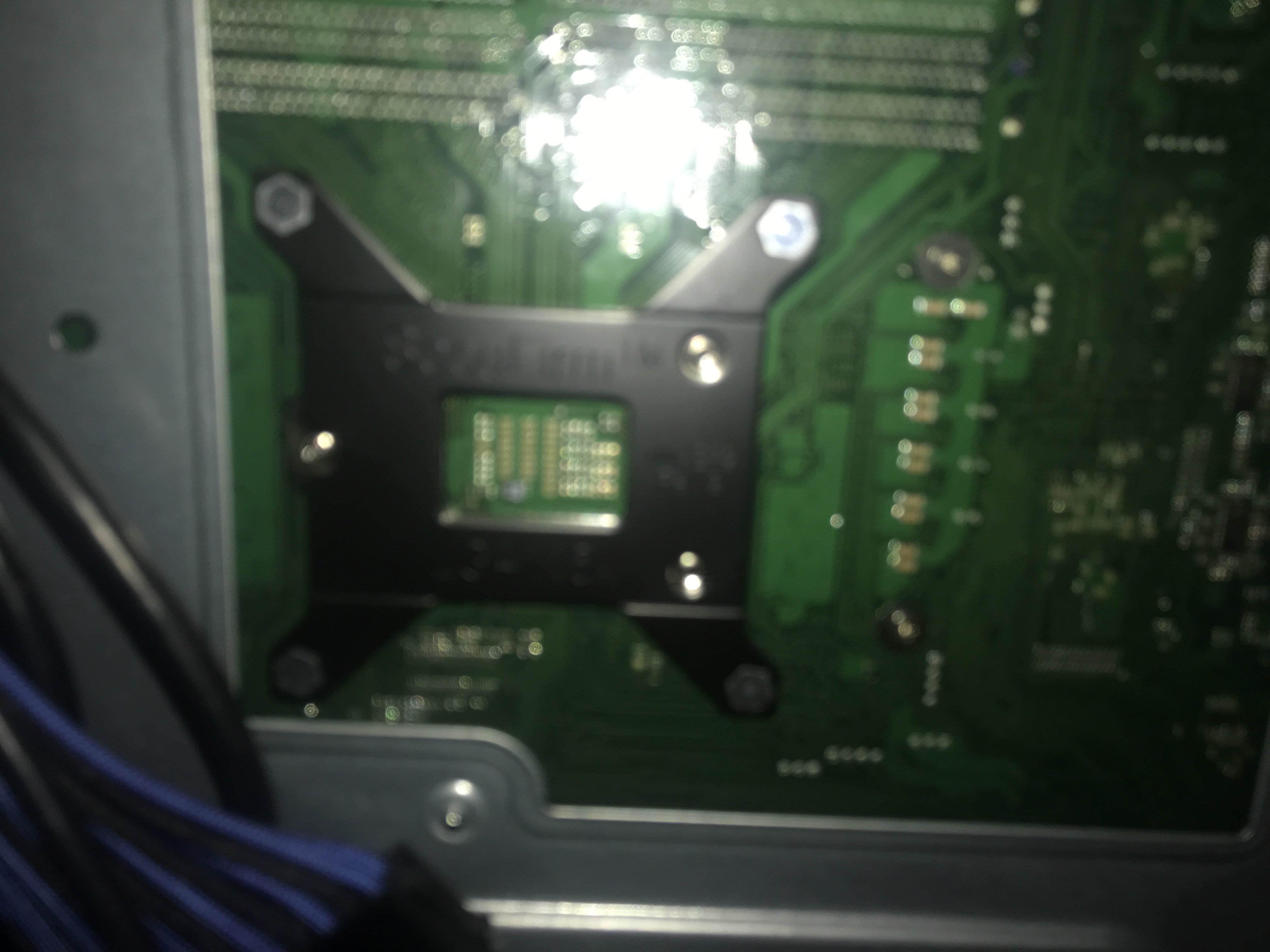

Hi all, I am looking into this asrock mobo.
Can anyone comment if there is a backplate on the rear of the mobo that would interfere with Noctua heatsinks, something like the NH-U9S or NH-D9L?
I read about issues with the X470 AMD micro atx Asrock version...

Hi, nas_nerd. I'm using the NH-U9S without issue with my setup (ASRock E3C246D4U and Xeon E-2288G).
Are you talking about some kind of plastic cover/heatsink over components on the MB by the I/O plate?
No, this board has none of that.  In fact I have the NH-U9S installed on my system with lots of room all around it.  I was even able to install a very large 135mm top flow cooler with no clearance issues at all.

Hi Hoopster,
I am referring to a metal backplate on the underside of the mobo. Some motherboards come with them to support the CPU bracket thing on the top side.
I was worried it would interfere with the noctua mounting system.
Oops, my bad, I completely misunderstood.
No, there is no backplate like that.
Here is the backside of the MB with the Noctua plate installed - sorry about the flash glare but it is dark back there :)

15 minutes ago, nas_nerd said:
Perfect! Thanks very much.
Just to be clear, there is a rectangular backplate for the CPU socket, but, the Noctua plate covers it without issue because of the cutout for the three screws and the slight raised area on the Noctua plate.
That might even work with the backplate in your picture.
Ah ok then. Maybe that is a standard thing for Intel 1151 sockets. The image I attached is actually the mini-itx version of what you have.
