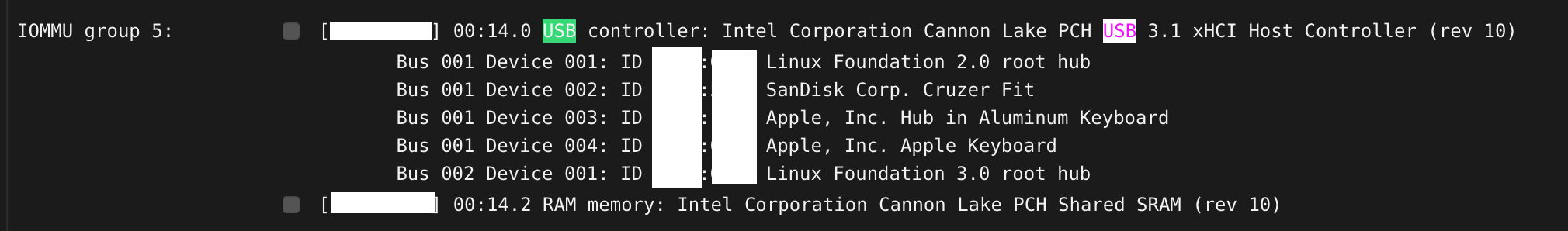

Hey @Hoopster I was curious since you've setup a VM are you passing any USB controllers through on the E3C246D4U? I'm trying to learn this currently and I think I'm coming to the conclusion that there is only one controller on the board. This is an issue since the unraid usb key is on this controller. Am I mistaken here or are am I understanding pass-through wrong.2070886958_ScreenShot2021-03-07at6_08_31PM.thumb.png.693f4694a0b09f649434fd699aff760e.png
You are correct.  The IOMMU groups on this board do not separate out the USB controllers as there appears to be only one.  If you want to pass through a USB controller, you will need to install a PCIe USB controller that should then be in a separate group.
I even installed a USB 2.0 card in the server connected to a motherboard USB 2.0 header for making sure I was booting unRAID from USB 2.0.  However, that is not a separate controller as all USB ports from the PCH are tied to the same controller.
Of course you could also try the acs override method to try and breakout a usb hub from the controller.
Edited by Hoopster
