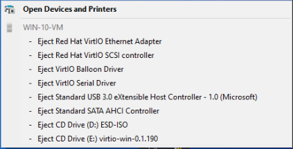

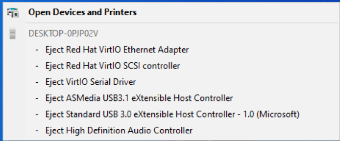

Server upgrades went well! The new USB card works well with this MB and in the VM. I did have one question though, do you see the same devices listed in the "safely remove device" section @Hoopster? How can I remove these from the eject list? Have I messed up the VM setup?
This is a fairly standard list based on the way VMs work.  Here is the list I see with a few additions:

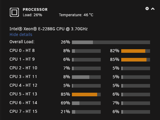

Whew, thought I may have messed up my template! Last question before I derail this thread any further. What are your temps like with the 2288G running a VM? I'm sitting at ~46C when my 6 core VM is idle. I feel like this is a bit too high for something like this. I'm so paranoid with temps and if I got good thermal paste coverage every time I build a PC.

Not directed to me, but I can share my experience with this CPU. It runs hot. Airflow and HSF will play a big role in keeping temps down, but this processor just has a high TDP. Even an idle Windows 10 VM seems to raise my overall CPU utilization by 5-15%, which subsequently increases temps.
Using the best HSF that your case can support would be my recommendation. I was limited by case clearance so the HSF I use is a little small for my liking, but still does an admiral job.
Personally I wouldn’t be concerned with the temp you mentioned just based on my own averages. I think an item that would be more meaningful is what are your temps at full load?
Thanks for all the help @Hoopster! I've learned so much from this thread and building this machine!
Mine idles at 30C, though have a Noctua NH-D15S on it (140mm fan).
I also am paranoid about the CPU temps...so you are not alone.
I am at 36C when both unRAID and the VM are idling; however, it does not take much to bump it up 20C and under high load, as others have mentioned, it can get quite hot.  I have seen temps up in the low 80s when all cores/threads are getting a good workout.

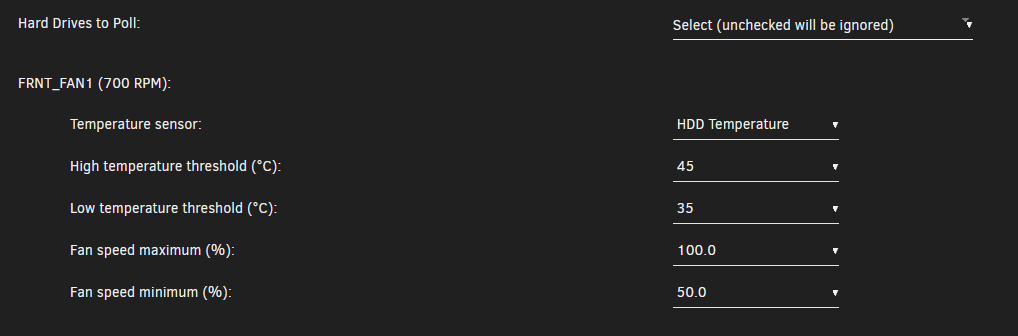

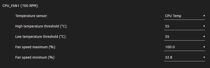

@Hoopster would you mind sharing a screenshot of your IPMI fan setup? I'm interested in your fan curves. I had to map mine out in a spread sheet to wrap my head around the settings haha.
Frnt_Fan1 and Frnt_Fan 2 are my two HDD cage fans and are setup identically.  On Hard drives to poll, I just have the HDDs selected as they are ones in the cages and I have deselected the SSD/NVMe drives.
The way my case is designed, the air from the HDD cage fans flows through the HDD cages and then is redirected back over the MB.  I have set the minimum HDD fan speed to 50% to keep air flowing back to the MB and it helps with CPU and PCH temps (nothing can fix the MB temp reading) to have air flow at at least 50% even when all HDDs are spun down.
CPU Fan settings:
