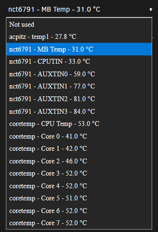

I have noticed that whatever AUXTIN3 (in the System Temp plugin) is reporting as its temp, the same temp is also reported in IPMI when it has whacked out.  When things are normal, the System Temp MB temp and IPMI MB temp are in sync.
I have no idea what AUXTIN3 is.  Do any of you see the same correlation?  They have both "cooled off" to 84C from 86C yesterday and 85C this morning.
image.png.bb1c5f2b098c561bff164fed39757836.pngimage.png.17dea7bb69a479ad36a3e45c16992ee9.png
Yeah, I would say that is the sensor that is showing the incorrect reading.  I see the same temp in unRAID and IPMI.

William at ASRock said the the BMC firmware team wanted to know what program I was using in Linux to show the system temp.  I have been giving them screenshots of the System Temp plugin drop-downs like we have been posting in this forum.
I explained to him that the plugin is just really parsing the output of the Linux 'sensors' command and presenting temps from which to select in the drop-downs.
I gave him screenshots of 'sensors' run from the CLI as well as a link to the Dynamix System Temp source code in case they wanted to look through it.

As far as I can tell, it is just a reporting issue.  For some reason, IPMI/BMC is apparently reporting the wrong temp as the MB temp.  Nobody's MB temp is really in the 80-90C range.
I do recall seeing once that the System Temp plugin was reporting 86C for the MB temp.  A reboot fixed that, but, it did not fix what IPMI was reporting.  It still claims 86C for the MB temp even though the onboard sensor says 29C.
The problem is that IPMI shows the high temp even when Linux/System Temp plugin is showing it correctly.  It appears that IPMI will sometimes latch onto the AUXTIN3 temp rather than the actual MB temp.  That's what ASRock is looking into.

32 minutes ago, Burizado said:
My MB says 27.8C in the Dashboard, but I don't see any sensor in IPMI with that reading.  I am not sure where the unRAID Dashboard is pulling the readings from.
It looks like you have the MB temp reading coming from the acpitz sensor?  That's the ACPI Thermal Zone sensor that is usually "somewhere near the CPU socket" and is often unreliable.  It can be reporting a constant temperature that never seems to change.
If you have the System Temp plugin installed, the dashboard will display whatever temps are reported from the sensors you have selected for Processor temperature and Mainboard temperature.
In the System Temp plugin drop-down, does it not show an nct6791 MB Temp sensor you can select?  That is far more accurate.  IPMI/BMC does not care about acpitz, but, it should care about nct6791 MB Temp although it often appears to be latching onto AUXTIN3 instead.
Ah ok, I did see it move a little but never very much, or often.  Yup, I do have that, and it is lower that the other one. lol.  Thanks for the info Hoopster.  Always learning something new. :)
