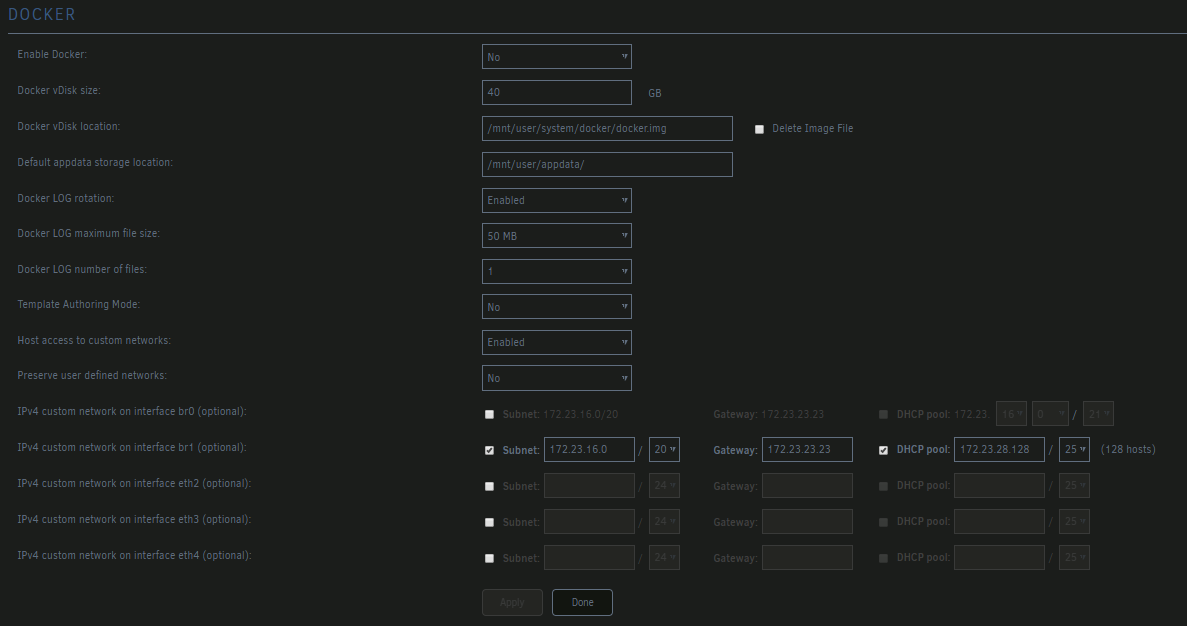

I try to use my new NIC with docker like it's describ :
https://forums.unraid.net/topic/62107-network-isolation-in-unraid-64/
and https://forums.unraid.net/topic/54882-630-how-to-setup-dockers-without-sharing-unraid-ip-address/

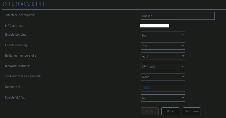

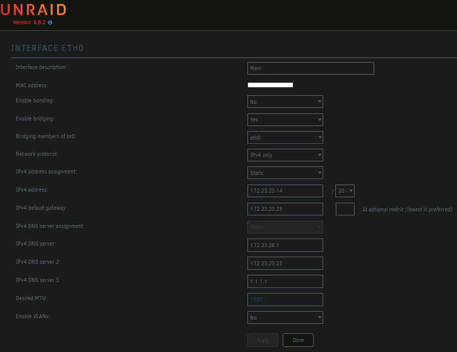

my Ethernet config
MainScreen.PNG.660eda4615fac3521d683cc40ed12d59.PNGSecondScreen.PNG.18214596bbc85439ab47dfcf6ca58a18.PNG

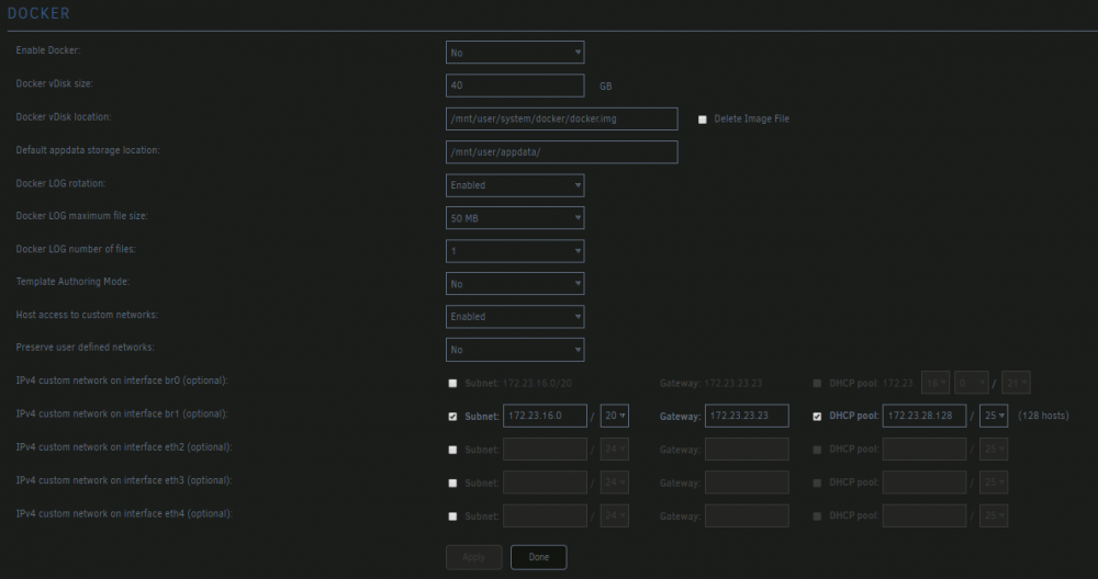

my Docker config
But when i active Docker i can't see my unraid server i can't ping it
Do you have any suggestions ?
Thanks

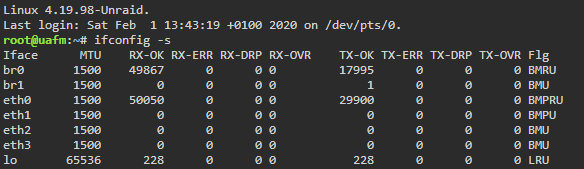

What is the output of
ifconfig -s
Btw you do realize 172.23.23.14/20 means any address between 172.23.16.x to 172.23.31.x ?
Edited by bonienl
yes i knows i can use 4096 address with this i think it's enough ;)
Thanks a lot
Did you start the docker service?
I am missing some interfaces. Can you provide diagnostics, see Tools -> Diagnostics
no it's true, it is not started.
If i start docker in this configuration i can't access to my server
diagnostics-20200201-1830.zip
There is no connection (cable) detected on br1 (eth1) and the link is reported as down.
Try a different cable and different port on your switch/router.
Ok, it's work well now thanks ( sry i'm beginner on docker/unraid )
