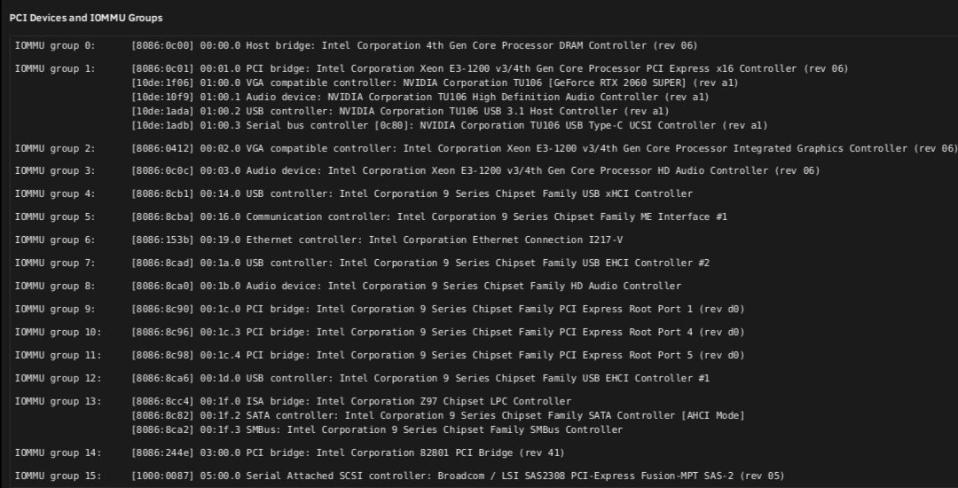

Please see image of my iommu groups:

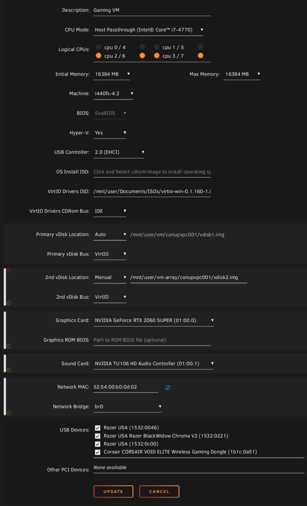

Virtual Machine configuration:

Doubt if ACS override will help here, but it won't hurt.  The problem is that your video card also includes a USB controller which must also be passed through to the VM.
Hmm and how would I go about passing the USB Controller of the GPU to the VM as that doesn't look to be an option within the GUI. I'm guessing I will need to switch to XML view and add it?
