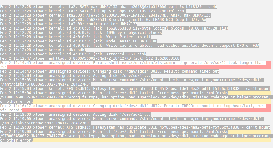

Tried to do that, didnt seem to work. Here's the disk log after the attempt
UD is timing out, try it manually, on the console type:
xfs_admin -U generate /dev/sdk1
And post any errors.
yup ...
Log inconsistent or not a log (last==0, first!=1)
empty log check failed
xlog_is_dirty: cannot find log head/tail (xlog_find_tail=22)
ERROR: cannot find log head/tail, run xfs_repair
