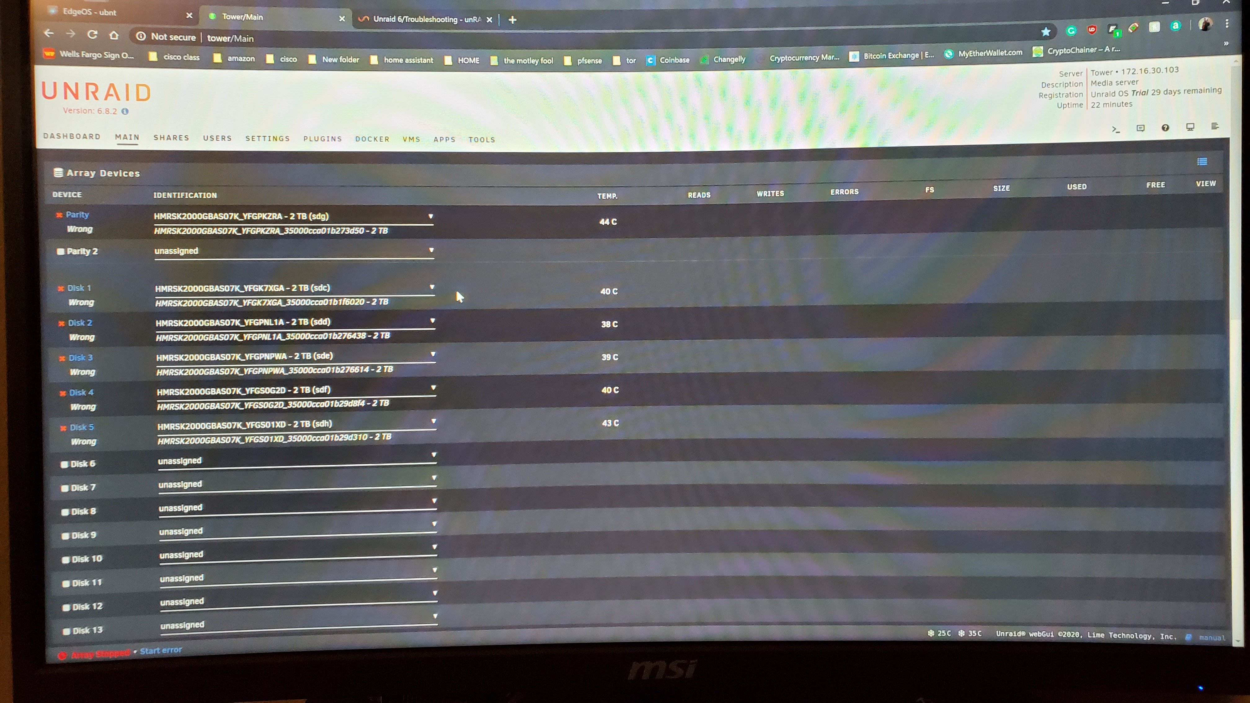

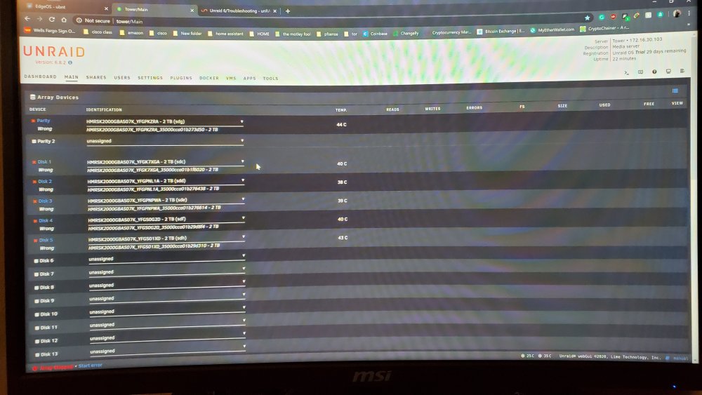

Hello I'm new I recently got unraid on my server no problems then I had to move my   server so I had to shut it down I stopped spinning the hard drives and then I shut it down when I went back to turn it back on I can't assign the hard drive anymore not sure what to do not that familiar with this somebody could help would appreciate it

Everything is plugged in it shows all the drives and just finished a preclean disk no problems were found
You've switched controllers / firmware of the HBA they're plugged into.  They are all being reported as a different serial number.
Either switch it back, or do a tools - new config and reassign them appropriately.
