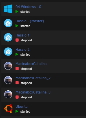

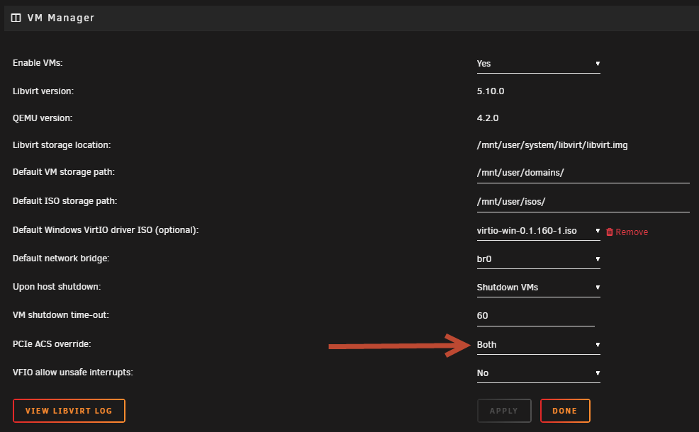

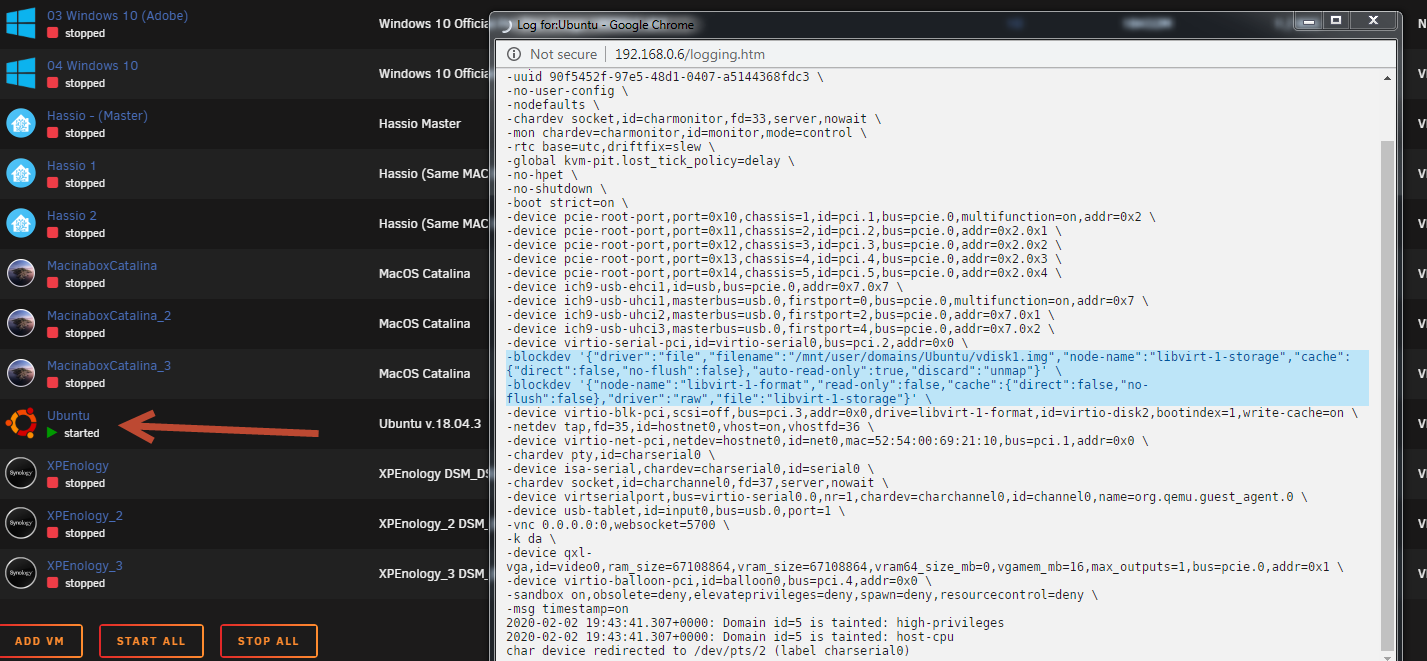

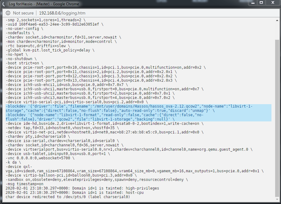

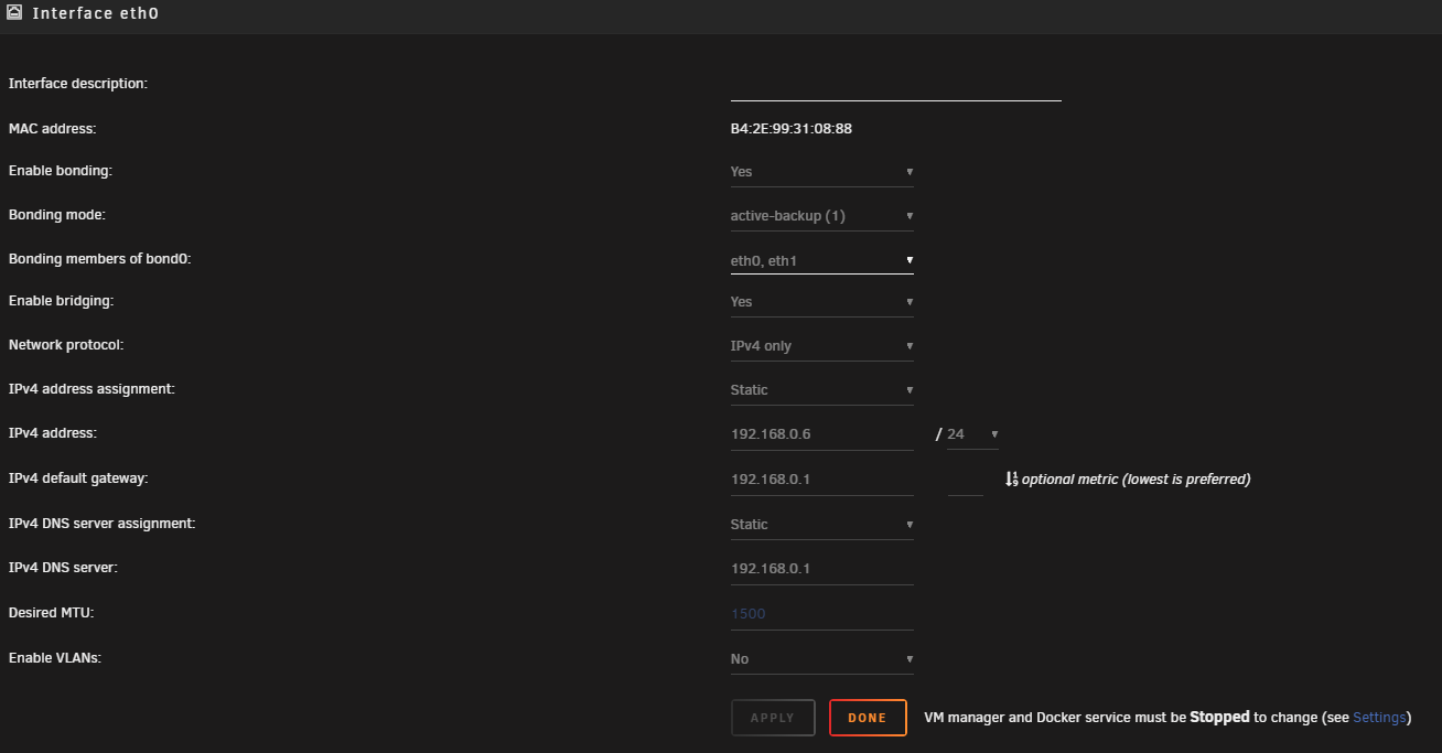

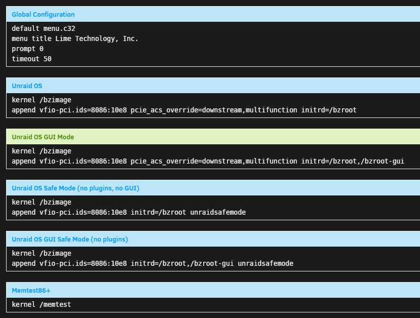

February 1, 20206 yr Hi All I have been moving a lot of data around and had to disable VM/Docker and anything that could write to the Array while moving files Now after starting VM service again (Several reboots) I cant connect to any of my VM's VNC gives I have enabled turbo write and I disabled PCIe ACS override (Only used it for my Nvidia card and I don't use the passthrough anymore The network is back to "Default" I removed the 4 NIC card for a Pfsense project But the network looks ok, and works for my Dockers... If I look at the logs for one of the VM's I see I can't understand why its not working anymore (Might just be a stupid newbie error) Any help is much appreciated - last migration from Synology UPDATE: Any repair mode - If something got broken? (Its everyone of my before working VM's that just stopped working?) Is ACS forever if you first enable it then it has to stay? I am sure this isn't a misconfiguration of the XML because all of the worked before Edited February 2, 20206 yr by casperse
February 2, 20206 yr Author I enabled the ACS mode again: No change? I am running 6.8.1... Diagnostic file attached - I never thought VM would be so sensitive to changes (Dont know what broke it?) These all worked fine before: diagnostics-20200202-1740.zip

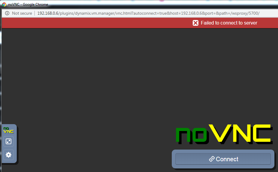

February 2, 20206 yr Hi there, So it sounds like the main issue is that the web-based VNC client we have built into Unraid isn't working for you, but do your VMs start ok otherwise, you just can't "see" them through VNC? If so, please try downloading a VNC client such as RealVNC and see if you can connect to your VMs using that. If so, we have at least ruled out the issue of the VMs themselves. Another thing to try is a different browser to see if an ad-blocker or something else may be getting in the way. I'm going to review your diags here as well and will repost if I find more in there, but these are some good starting points to debugging the issue.

February 2, 20206 yr Author The picture in my first post like this BTW I just remembered I followed the guide and added my 4 NIC's to be used in the future for Pfsense but have not selected any of them in any of my VM's Could this be what is breaking all the other VM's - seem like a missing network connection? I was told to add the line for any boot option I use (GUI and without) (Docker works and I have internet just not VM) I cant remember if it worked before this changed might as well try to remove it again and see if it change anything? (I have tried anything else) Edited February 2, 20206 yr by casperse

February 2, 20206 yr Author 2 minutes ago, jonp said: Ok, I still don't think you're understanding what I'm asking. There are two steps required to connect to a VM over the noVNC client. First is to start the VM, the next is to open the VNC connection. So what happens when you start the VM? Does it actually start (meaning the red square next to the icon turns to a green play symbol)? Sorry yes they all start - just tried 4:

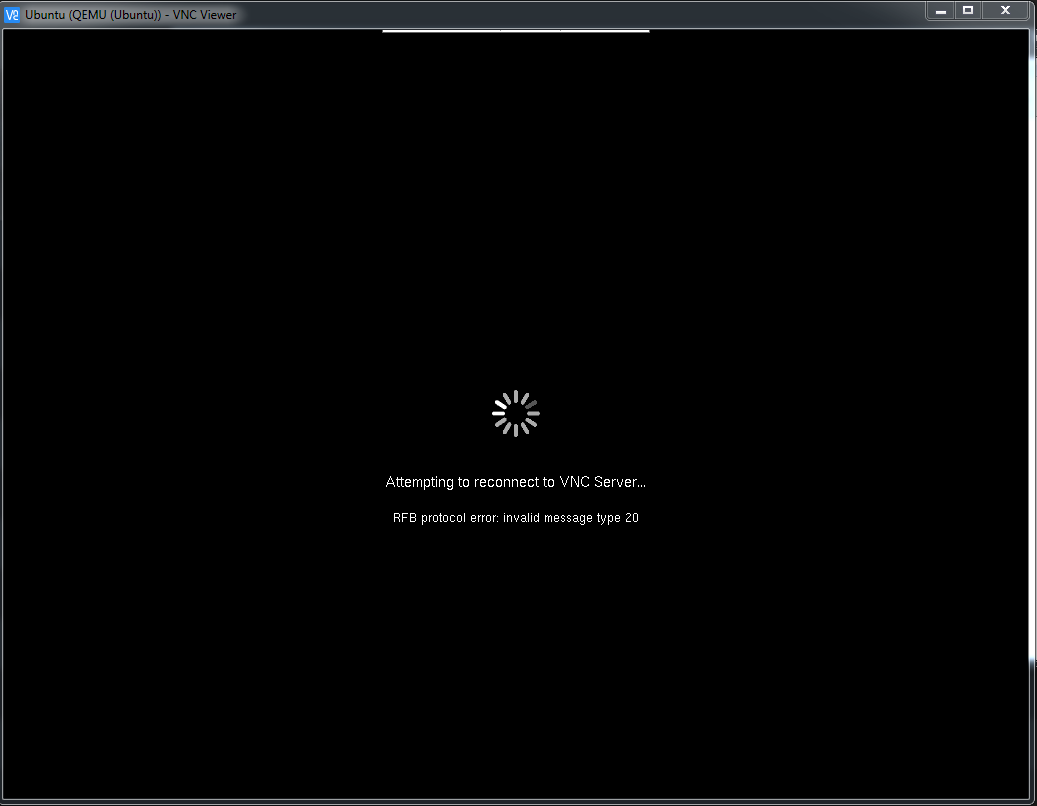

February 2, 20206 yr Ok, if they are started, then this has nothing to do with your VM configurations. A started VM is running, but if VNC is failing to connect, something else is amiss. This could be a browser issue or otherwise. I previously asked you to test something that you haven't responded to yet: 49 minutes ago, jonp said: If so, please try downloading a VNC client such as RealVNC and see if you can connect to your VMs using that. 51 minutes ago, jonp said: Another thing to try is a different browser to see if an ad-blocker or something else may be getting in the way.
February 2, 20206 yr Author 8 minutes ago, jonp said: Ok, if they are started, then this has nothing to do with your VM configurations. A started VM is running, but if VNC is failing to connect, something else is amiss. This could be a browser issue or otherwise. I previously asked you to test something that you haven't responded to yet: Sorry no same problem - Also some of the VM's like hassio start their own webpage gui and that is not working either Real VNC
February 2, 20206 yr What IP address did you use for trying to connect? The IP should be that of your Unraid server and the port should be 5900 or greater (depending on which VM you're trying to connect to).
February 2, 20206 yr Author 2 minutes ago, jonp said: What IP address did you use for trying to connect? The IP should be that of your Unraid server and the port should be 5900 or greater (depending on which VM you're trying to connect to). Server IP:5900 Thanks for all your help, I will try to do a roollback tomorrow (I can not reboot the server before then...) And remove any changes I did the last couple of days... (didn't really do big things) Getting late here need some sleep - Again BIG thanks for your time I really appreciate it !!!

February 5, 20206 yr Hello, I'm going to register here and need help. My VMs are running! But the internal VNC player no longer starts. I can call the VMs via an external VNC player. How do I get the internal VNC up and running again? Thank you
February 6, 20206 yr Hello, it is apparently the Broser (cache?). However, did I clear Chromium's cache and it still doesn't work? In contrast, Firefox and Opera display everything correctly. Does somebody has any idea ?
February 15, 20206 yr Author Update: I tried so many things and honest don't know what caused this? But my VM's are running (The few that didnt was caused by some network DHCP problem and I mistakenly thought that was related to all my VM's not working) Short version I have my VM back but I can only connect to them by Firefox (Like other reports above) - Chrome in VNC seem to be broken (New update?) also listing the VM page seem to take much longer time than on Firefox? Docker is still working fast and show all dockers quickly so only on VM page
