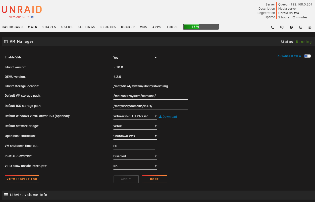

VM page just shows animated waiting graphic
I recently removed some disks and added some new ones and moved stuff around.  In the process I borked my one VM I had running and decided to start fresh.  I've gone into the VM Manager and changed the storage locations multiple times now, and I get it to start and there's no indication of any problems.  I've set libvirt storage to locations under /mnt/user/system and to a physical drive, /mnt/disk4/system and it creates it in either place, but no matter how many times I enable/disable VMs and delete that image and have it recreated when I go to the VMs page I just get that wavy graphic and there's nothing I can do there.
Is there some way to do a reinstall of the VM manager or is there some VM manager plugin I should install?
Anybody have any suggestions?  I just want to run a single Linux VM.  I have no opinions on any of these settings and will put anything that is recommended there.  I have changing all three paths to /mnt/user and I've rebooted multiple times.

I removed that line and changed the size and rebooted and no change.  I also moved libvirt back from /mnt/user/ to /mnt/disk4.
