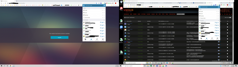

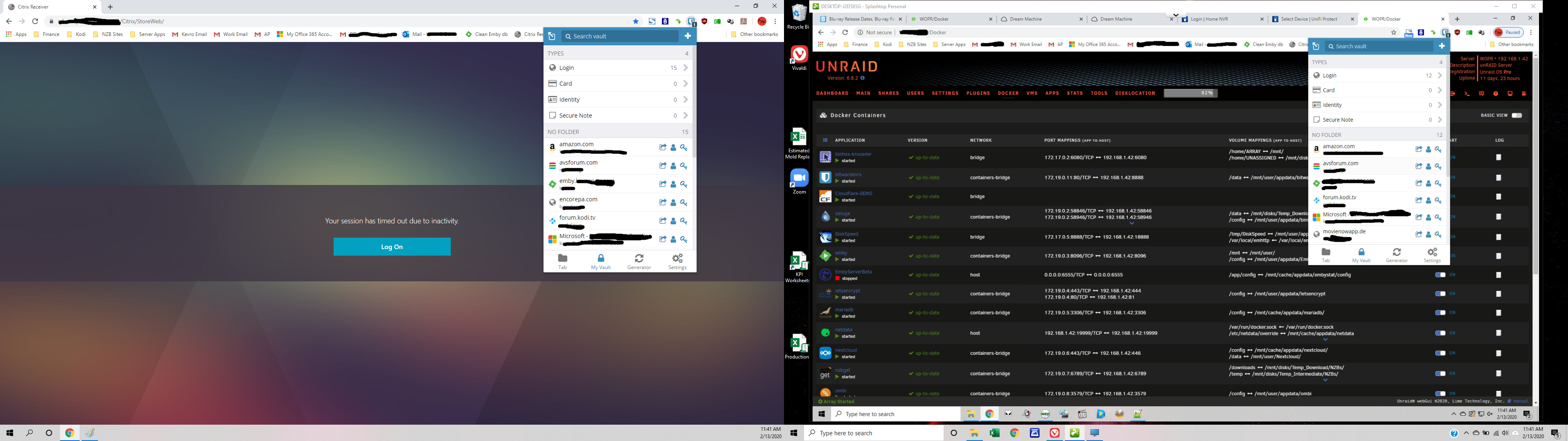

This isn't working as well for me as the old container/install.  I use the Chrome extension most often and there is a 2-3 second delay when I click on the Bitwarden extension icon and it opening.  Also If I add a login on one computer it doesn't show up on in the Chrome extension on another computer unless I logout and log back in.  I never had either of those issues before.
I have attached the log.  Also a screenshot.  On the left it shows the Chrome extension on my computer here at work.  The left shows me remotely connected to my home computer and you can see it's Chrome extension shows fewer logins saves.
log.txt
Edited by RockDawg
Ok, so it sounds like a reverse proxy issue. Can you post yours?
