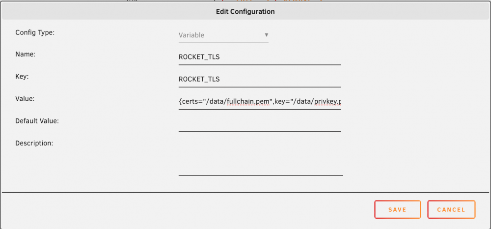

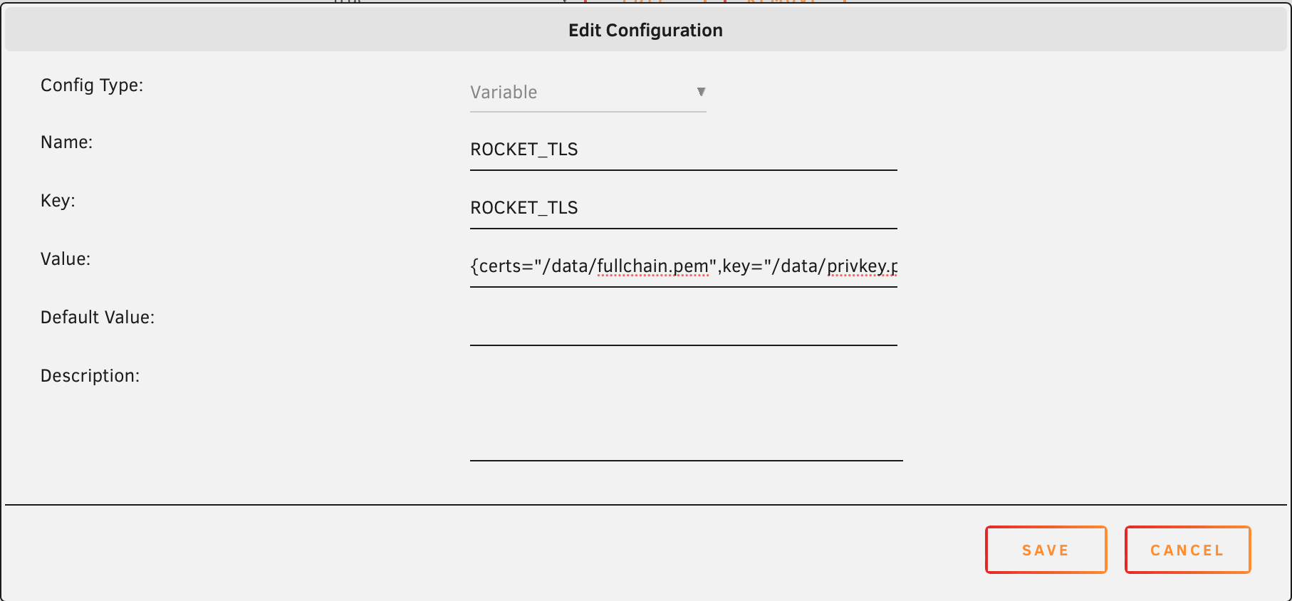

I am trying to add a new YUBIKEY 5NFC to my Bitwarden. I am told I need to globalSettings__yubico__clientId and globalSettings__yubico__key in the global.override.env file located at ~/bwdata/env/. Not sure how to get to that. Noob....
Looked at this posting...
Any help is greatly appreciated.
Got it resolved by adding in custom variables in the docker config

12 hours ago, crusemm said:
So what's the resolution?  It was working, then it wasn't (with that error) then it was working again, and now it isn't again.
You need to access Vaultwarden via secure connection with a valid certificate, that's it. It won't allow you to connect to it via http.
