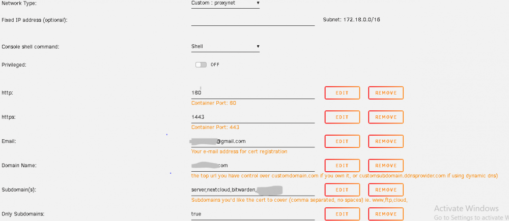

Hi I posted this already but in a wrong thread.
I have issues connecting to bitwarden using my domain.
I used to use duckdns for domain and it didn't work so I decided to have my own domain to try and see if bitwarden would work.
first, I know that Letenrypt is set up right with my domain name and subdomains, the log connected to all my 2 subdomain Nextcloud, bitwarden. I . made sure the Cnam is set right spelled right...
Second, my duckdns is set up right since my Nextcloud is working following Spaceenvador's Video
for Bitwarden,  i set up the network to custom,  just like Nextcloud.
I tried 2 different config files in letencryp for bitwarden, one with spaceinvador file and i left the  container name as original with bitwardenrs
of course i alway restart my dockers.

now the weird part. when i use http://bitwarden.mydomain.com it will direct me to nextcloud i don't understand why?, when i stop nextcloud and try again i have error 502 Bad Gateway nginx/1.16.1
i am able only to connect locally with bitwarden i dont know what am i missing. this was the same using duckdns as domain
second i tried the default config which  what was in letenrypt and change .sample to .conf and i change the container name to bitwarden.

Thanks for sharing mine was a little different as you see above, i tried your config file and i have the same thing. i know this is not Letencrypt help thread but i believe it is the probleme. what did you set your port 443 and 80 in letengrypt. please see this my Letenrypt docker and let me know if it is the same i have follloed SpaceiCapture.thumb.PNG.d2bedc60064f5468b49d15d9c379d89f.PNGCapture.thumb.PNG.d2bedc60064f5468b49d15d9c379d89f.PNGnvador set up
On 5/1/2020 at 6:05 PM, ssinseeme said:
Thanks for sharing mine was a little different as you see above, i tried your config file and i have the same thing. i know this is not Letencrypt help thread but i believe it is the probleme. what did you set your port 443 and 80 in letengrypt. please see this my Letenrypt docker and let me know if it is the same i have follloed Spaceinvador set up
Mine is same as yours. What port are you using for nextcloud?
Try port 443. I know spaceinvader says to change it, however that is the only way I could get mine to work as well. It was weird as it didn't make sense to me because I changed the port in the conf files, but it was like it wouldn't listen to what I was setting. It was like there was another setting somewhere defining which port nextcloud was listening on. I also left the bitwarden on the default port too. I was able to get both working.
Did you change anything else. Because I change d the port from 444 to 443 in Nextcloud docker and it giving me Error 502 and nginx 1.16.1. Did you change the config file to your localIP:444 to 443?
for bitwarden port 80 default will not work. It fail the compile. ! Could you share screen shots. Thanks.
