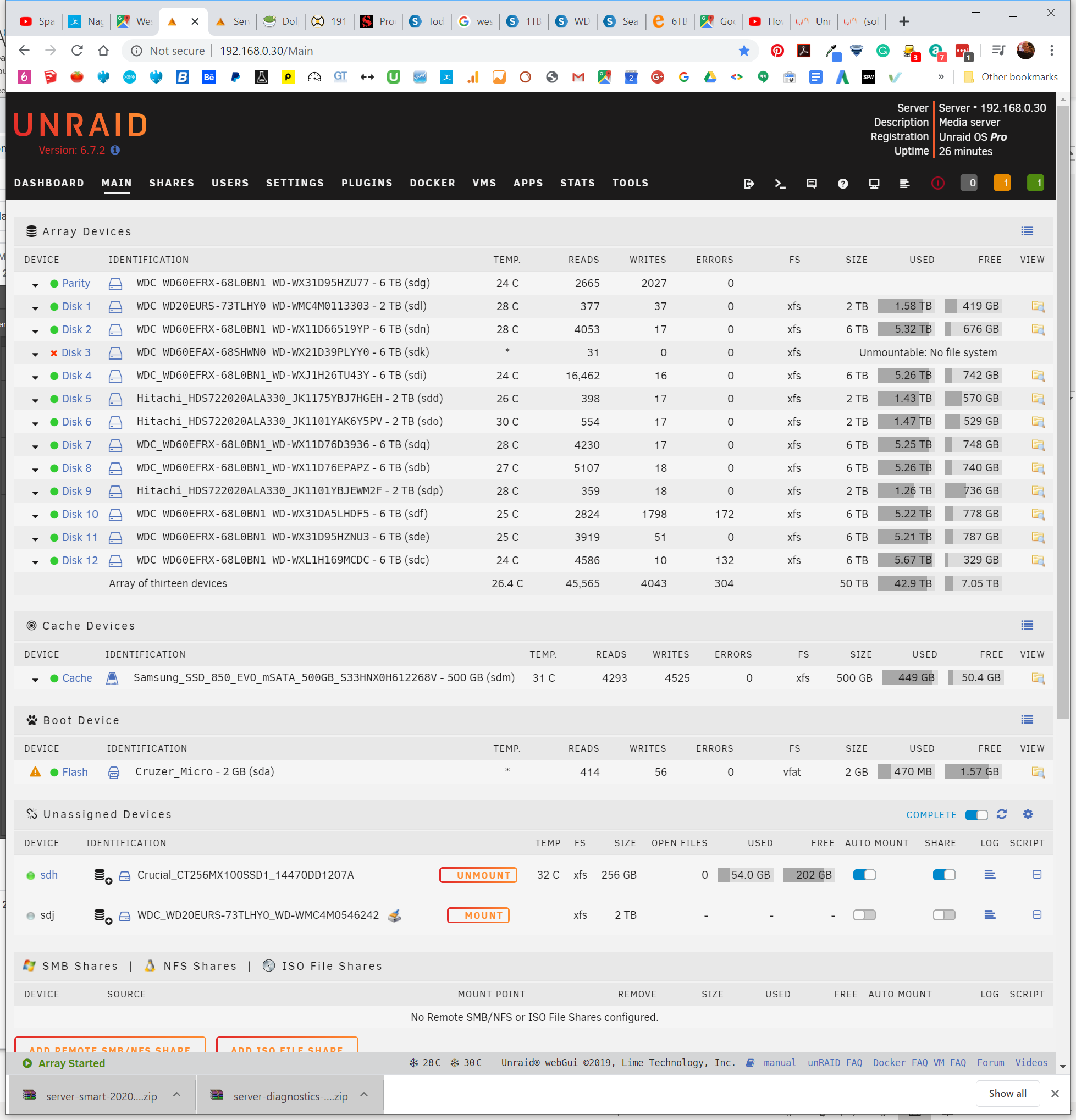

Hello,
I woke to this message from my server this morning, it runs 24/7 so there was no unsafe shutdown etc.

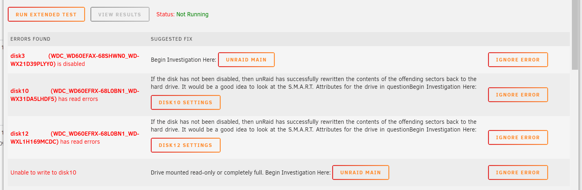

I also have some messages in Fix Common problems about failing to write to two other drives which seem to be running ok.
Running Unraid 6.7.2.
Any help gratefully received.
Thank you.
Adam

There were read errors on disks 10 and 12, and both look like an actual disk problem, though possibly an intermittent one, since disk3 is disable it can't be emulated correctly with errors on more disks, hence the filesystem corruption, reboot to clear the errors and check file system on the emulated disk3, check if there are more read errors on the other disks.
Even if there are no more errors for now on those disks I would recommend using a new disk to rebuild disk3, in case it happens again resulting in a corrupt rebuild.

More read errors on disks 10 and 12, run an extended SMART test on both, not possible to fix the filessytem or rebuild disk3 while these errors persist.
There are also errors with disk3, but these look like a connection problem, check/replace cables, or if you're plan to rebuild to a new disk disconnect it.
OK, disks appear to be fine but you're still having controller issues, disk12 dropped offline:

Just start the array and check data on disk3
Ok, sorry for the questions but disk 3 has been unassigned this whole period so when i select the correct disk it shows a blue square and says 'New Device'. I assume if I start the array now it will have to rebuild?
Yes, but like mentioned I would recommend rebuilding to a new disk.
Ok, I will put in a new disk.
Is it worth hanging onto the old disk 3, maybe running a preclear to see if it is ok or should I bin it?
Thanks.
Disk3 looks healthy, I suggested using a new one just in case something goes wrong during the rebuild, so you can still copy the data from the old disk if needed, after this is resolved you can reuse that disk however you want.
Fantastic, thanks so much for you patience and help.
All sorted now, thank you!
