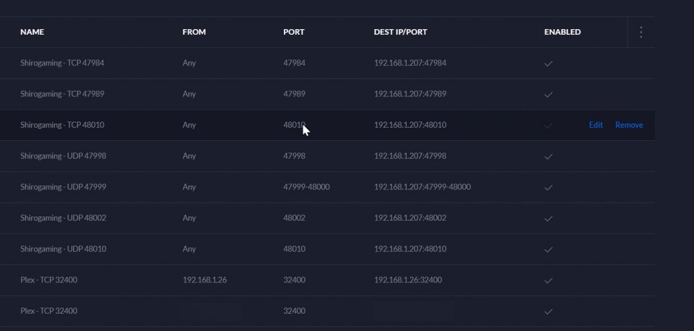

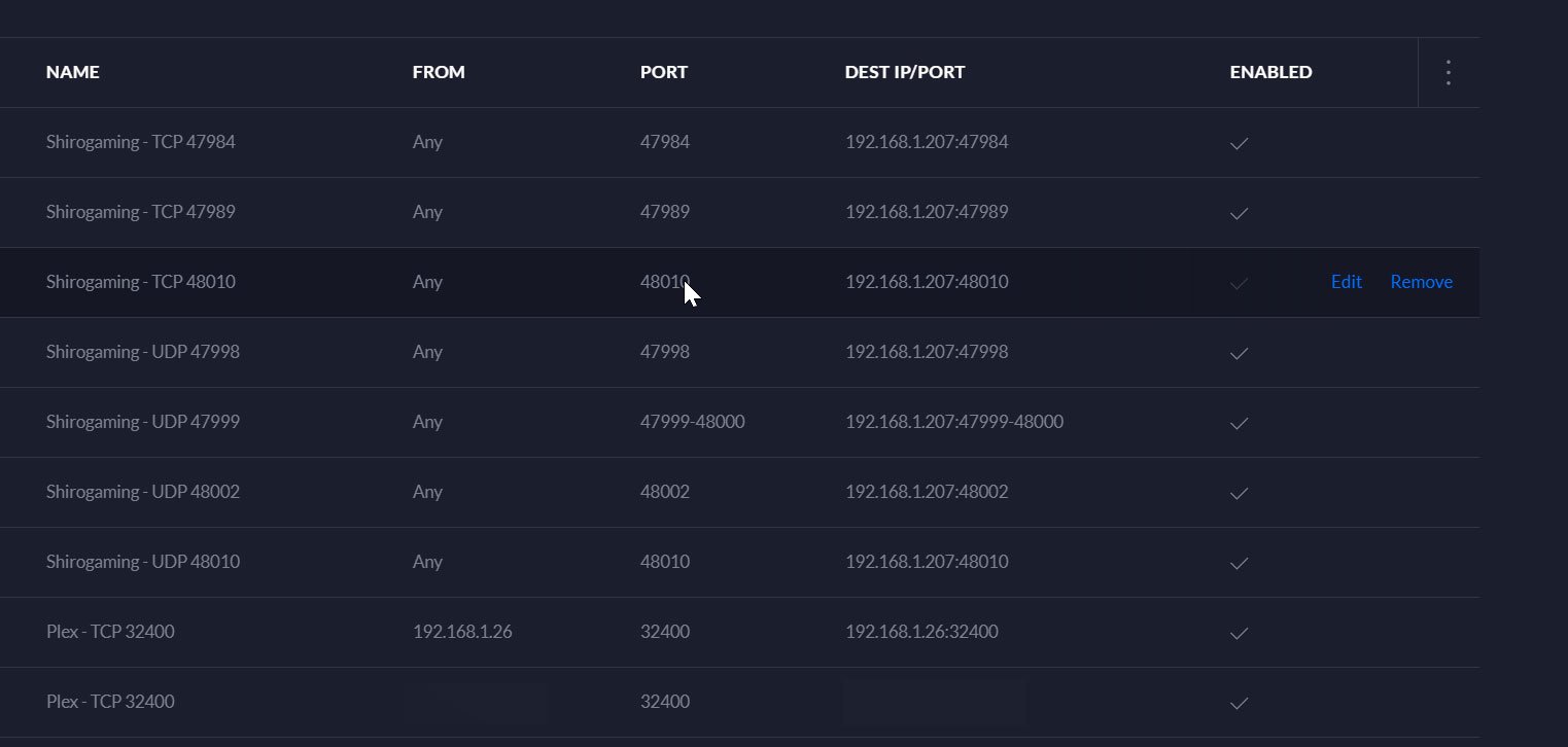

I have setup my Unraid server but I can't reach Plex docker and Moonlight Streaming (via a Windows 10 VM) from outside the internal network. I've put in the correct ports for port forwarding inside my network controller (Unifi), but still can't reach either Plex or Moonlight Streaming from an external network. I have a public IP and I've checked with my ISP and I am not behind a CGN. What am I doing wrong? My internal IP for Unraid is 192.168.1.26, my internal IP for Windows 10 VM (with the Moonlight Streaming) is 192.168.1.207. Attaching two picture of my setup. 1) The network settings in Unraid and 2) the port forwarding settings inside my network controler (Unifi)

The Plex port forward rule doesn't look right.  It should be:
From:   anywhere
Port:     32400
Forward IP:  192.168.1.26
Forward Port: 32400
Protocol: Both
From:   anywhere
Port:     32400
Forward Port: 32400
Protocol: Both

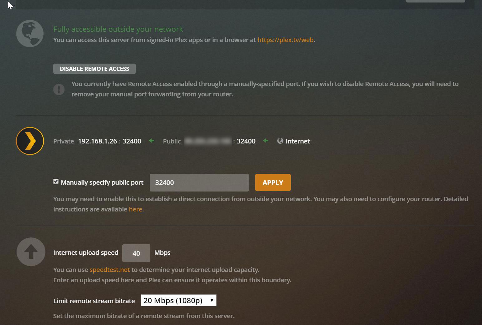

Changed it and removed the other one regarding Plex. Still no success. Plex has given me the info that it is 'Fully accessible outside your network' from the start (even before I made the change you just suggested) but it is still not fully reachable. Plex relay is working at a maximum at 2 Mbit/s and has worked from the beginning. I've checked my mobile devices and none of them are supposed to throttle or limit the stream because of cellular data.
