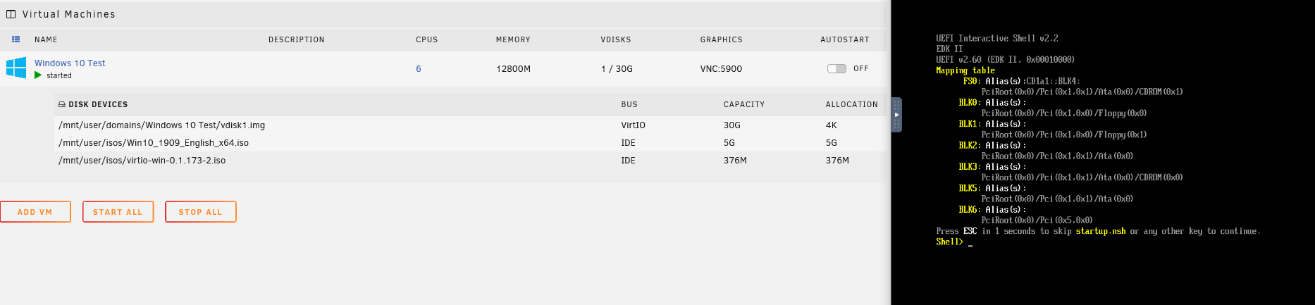

Just built my first unRAID server, got it up and running, was following SpaceInvaderOne's video on setting up a windows 10 VM as a daily driver.
I got VM's enabled, setup my first VM with my win10 and virtio isos and hit start and nothing happens.  No window pops up,  it just says the VM is started but then nothing else. If i hit VNC remote I just get taken to a UEFI Interactive Shell screen.
Shouldn't a window be popping up showing the Win 10 install process on my vm?
Any ideas as to what I'm doing wrong?
I believe most people got around the UEFI boot screen by using an up to date iso downloaded from m$.  Alternatively, you can also do something (commands very much off the top of my head and probably wrong
fs0:
cd \bootx64
bootx64.efi
I downloaded the iso Friday. On the shell the only directory in fd0 is an empty efi directory
What I see when it's running (vnc window on right)
Log from when i start it:

Ok, I just wasnt getting into the VNC fast enough to see and "hit any key to boot from..."
Damn do I feel like an idiot!
