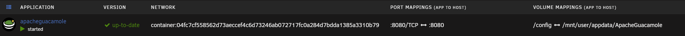

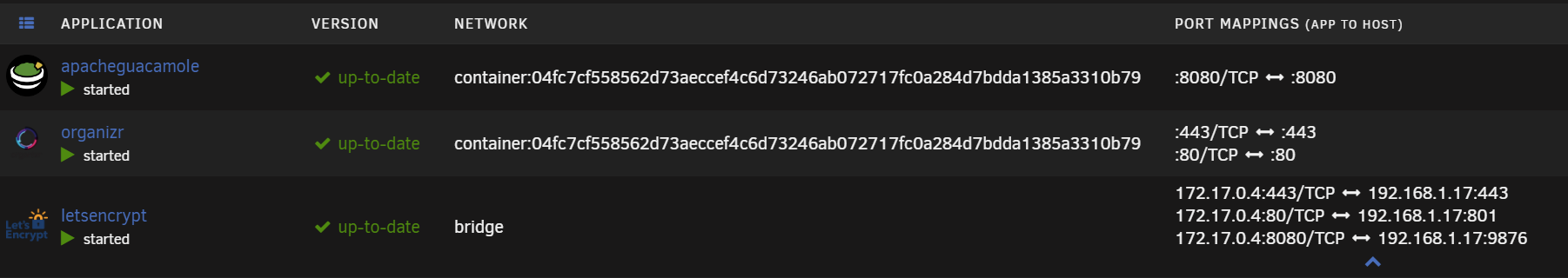

Ok I think I have it working now. Removing the ports still left the port mappings and I changed my apacheguacamole letsencrypt config to point to the bridge IP address of letsencrypt and it seems to be working.

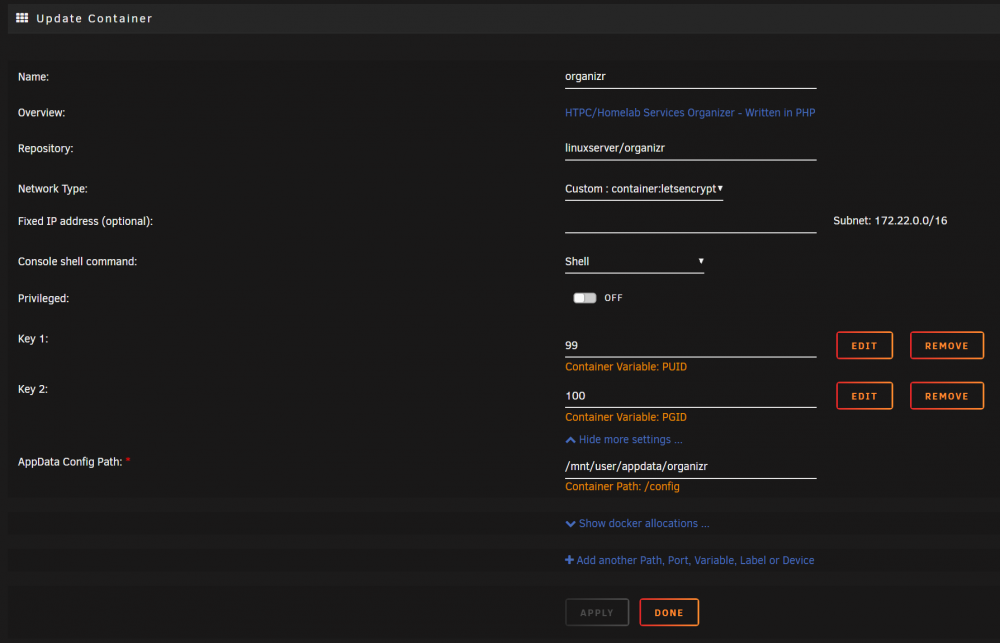

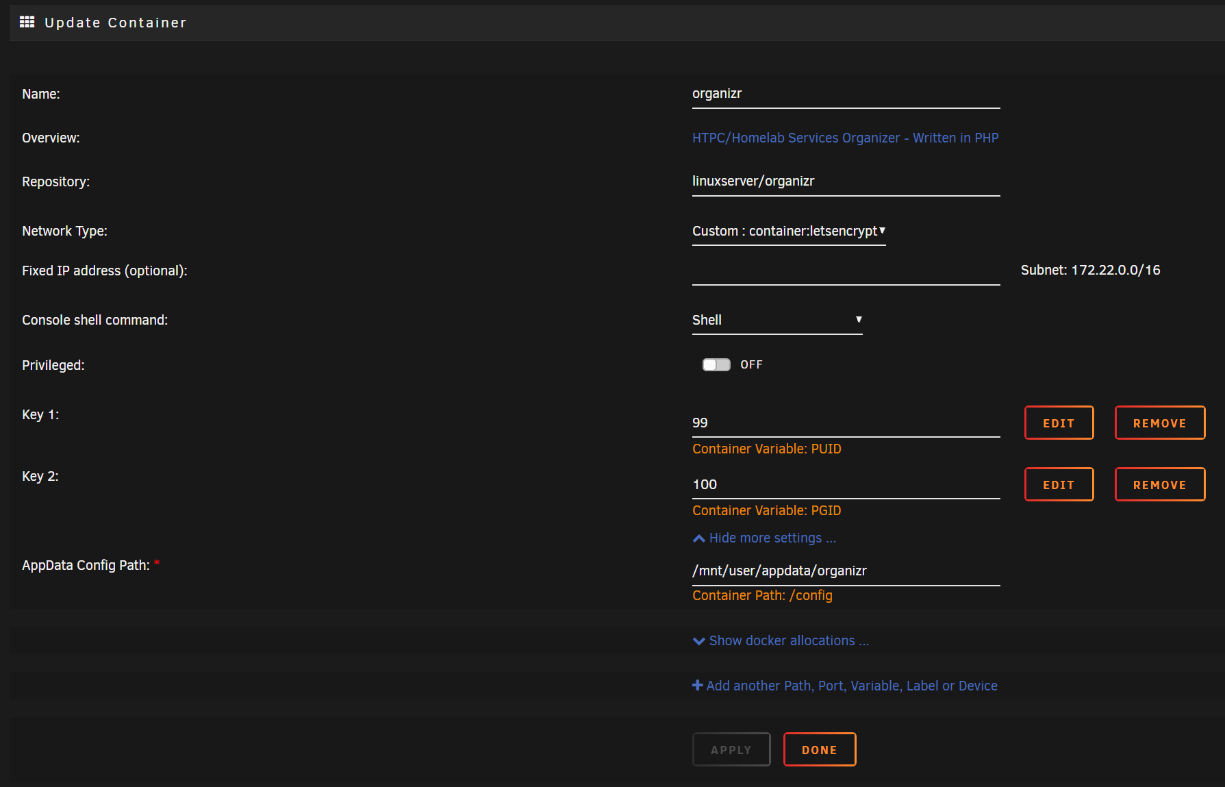

I have a new question though.. apacheguacamole uses port 8080. I have another docker that also uses port 8080 by default. How do I change the default mapping to allow both of them to work?
As an example:
Organizr uses the same internal ports as letsencrypt. So when I try to point towards organizr it goes to letsencrypt. I don't have any ports set up in the container so how can I change the default ones shown above?
