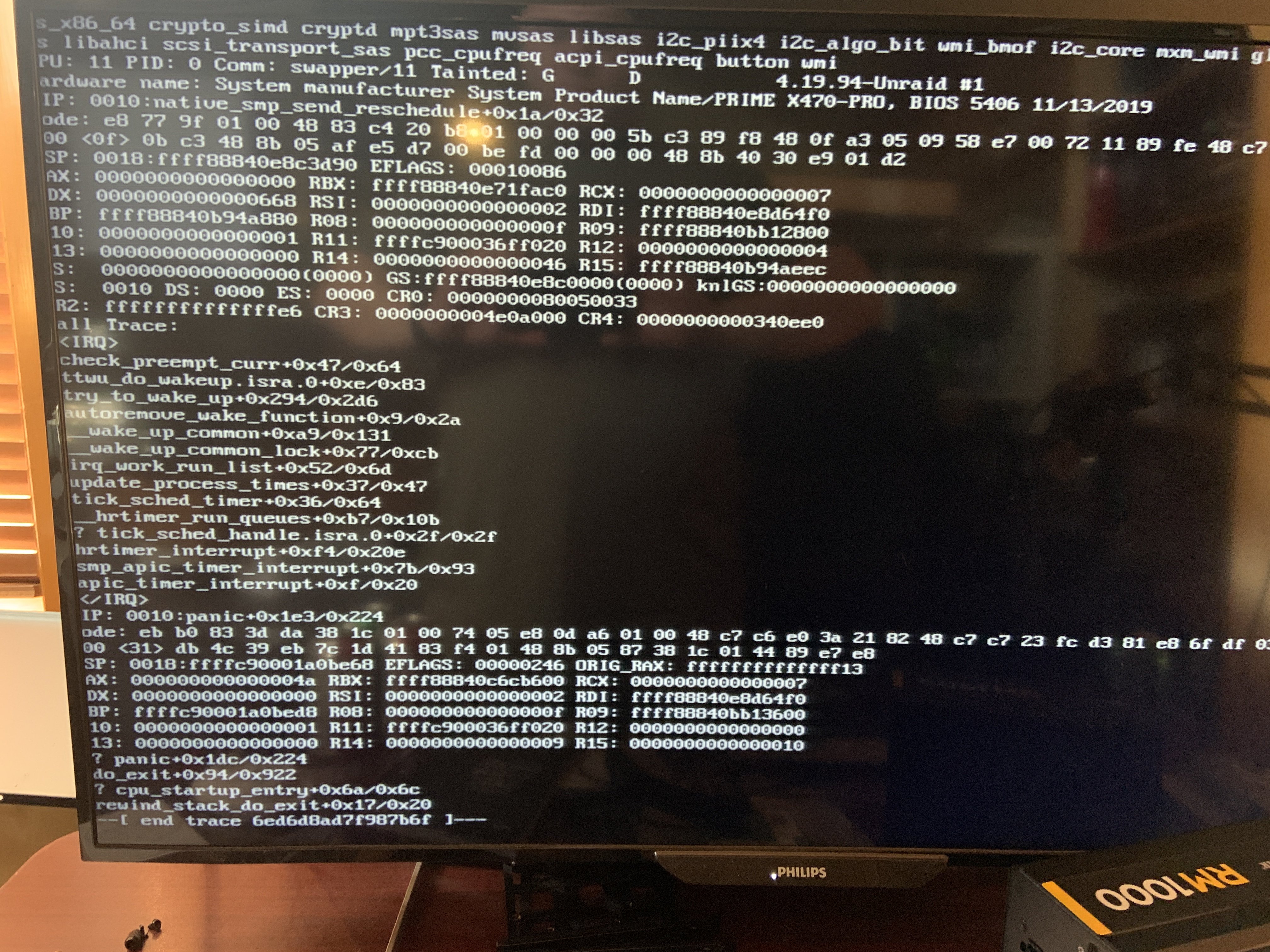

My machine locks up randomly, never running for more than 2 or 3 days. I had originally thought it was related to my pi-hole docker, it seemed to produce the problem more frequently when I was running docker.  However, with that disabled my machine still crashes. I can’t ping the system or reach any share. When I had the GUI enabled it would be completely frozen at the login screen. A few times I had been logged into the system and was running htop full screen, it would also be frozen, requiring a hard reset. System stability is so bad, I can start the computer in the morning and within a few hours it has locked up.

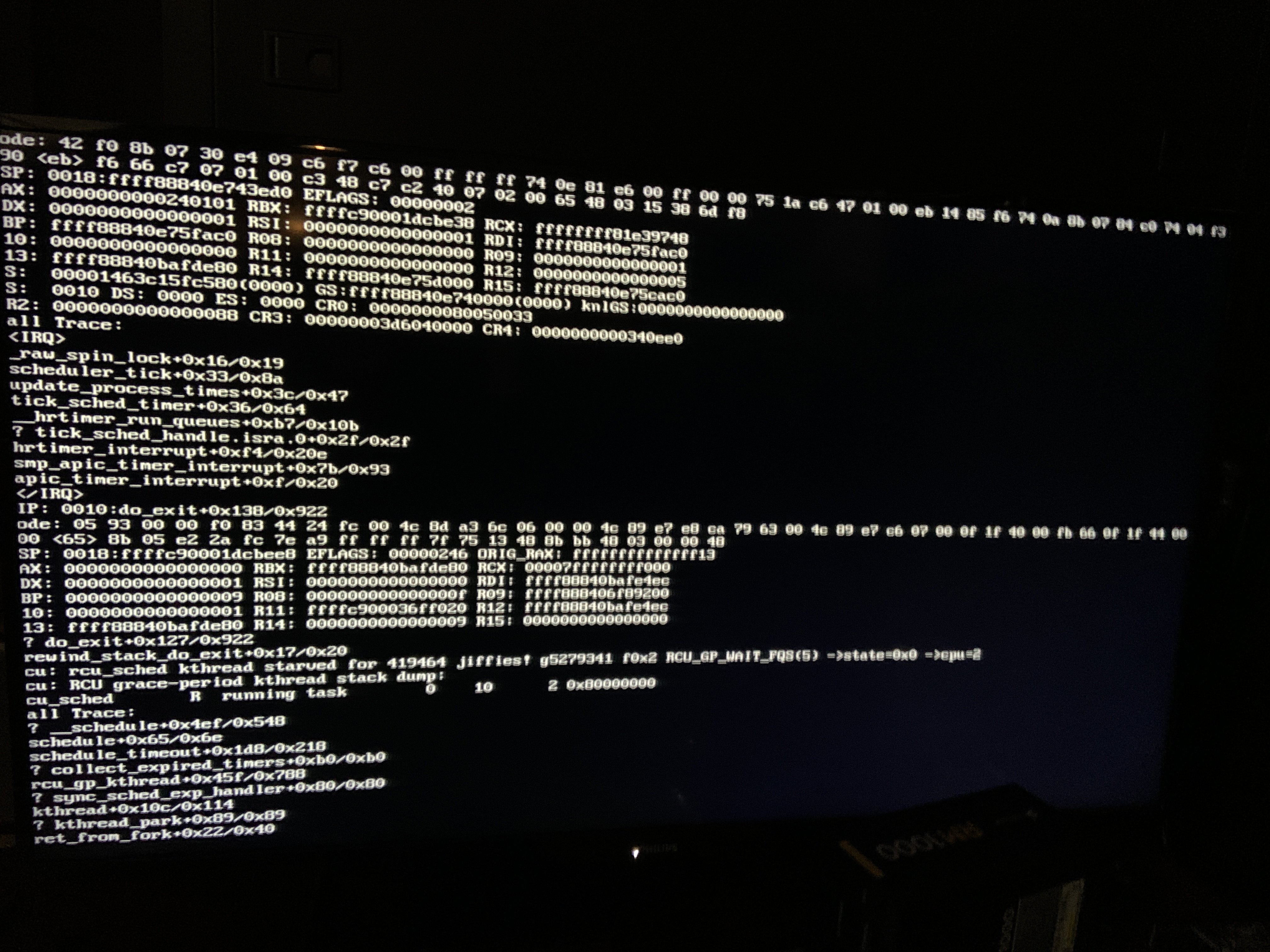

I’m attaching two photos of what displays on my monitor when the system locks up. I’m also attaching 2 diagnostic files, 1 from just after rebooting from a lockup (6.8.1). The second one is after my update to 6.8.2, I'm not expecting either log to have any big revelations, I think the photos of the screen might lead me in a better direction, if I knew what they meant.  I'm at a complete loss here, and would love if someone could help me diagnose my problem.

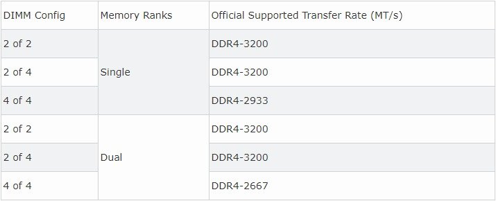

Ram: G.SKILL Ripjaws V Series 16GB (2 x 8GB) 288-Pin DDR4 SDRAM DDR4 3600
Don't overclock your RAM, it's known to cause stability issues with some Ryzen system, even data corruption, respect max speed based on config:
Also look for "Power Supply Idle Control" (or similar) on the BIOS and set it to "typical current idle" (or similar)

4 minutes ago, Alex.vision said:
Could you tell me where that Ram chart came from?
Some website that was reviwing 3rd gen Ryzen, don't remember exactly which, but they are the officially supported speeds, anything above that is an overclock.

Difficult to say for sure the crash looks hardware related, at least it doesn't point to any specific driver/module.
Hmm, ok, I have an Identical system, I can try swapping all my drives over to that one and try to narrow it down to hardware or hw incompatibility if that seems like a viable option.
Before I can change out all of the hardware to test the above hypothesis im trying to duplicate the data to another server.  I strt the system and then intiate a transfer and see how much data can be pulled before it crashes.  I just looked at my transfer and noticed it had stopped.  So I logged into the  web page, which displayed.  I got three notifications about plugin updates, and when I clicked the plugins tab, the system refreshed to a blank page with the header still showing and the chrome busy icon in the tab.  I quickly opened a terminal and tried to pull info from the syslog.
