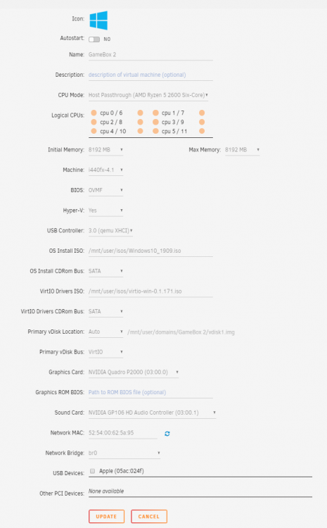

  • Swapped the 970 with the Quadro P2000 (in the third PCIE slot) in VM settings yeilds a boot, and seemingly working system. installs GForce Experience and P2000 drivers without issue
    • Total VM performance was very lackluster (no surprise its only a P2000 but even VNC performance was better)

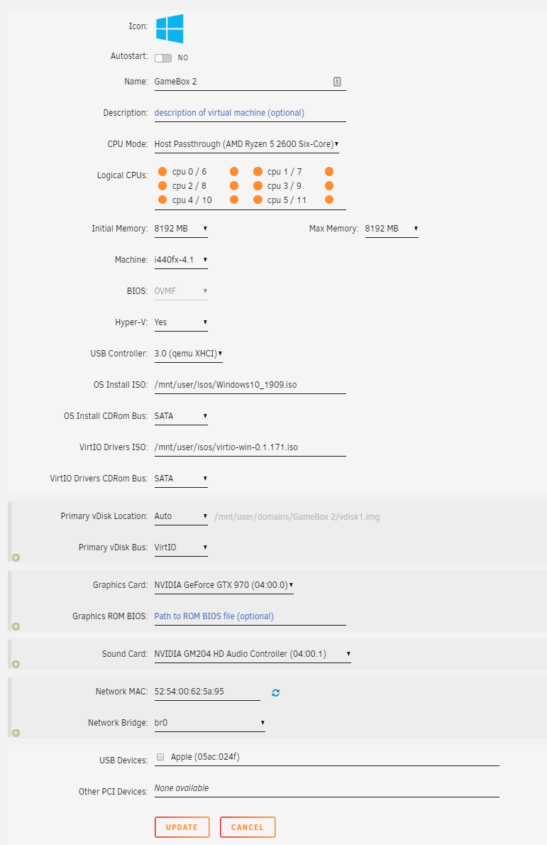

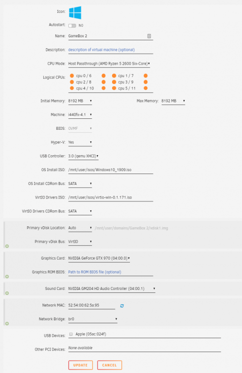

  • Booted VM with GTX 970 SC (No VBIOS) after installing nvidia GForce with the P2000
    • system boots to 640x480 with exceedingly low performance; cannot change resolution in windows display menu, a slideshow basically
    • system hangs after loading windows, does not install drivers from windows update
    • attempted to install 970 driver via Gforce experience; unable to view the entire window so Driver installation is impossible
    • system shut down while attempting this, restarted still at 640x480 but with significantly better performance

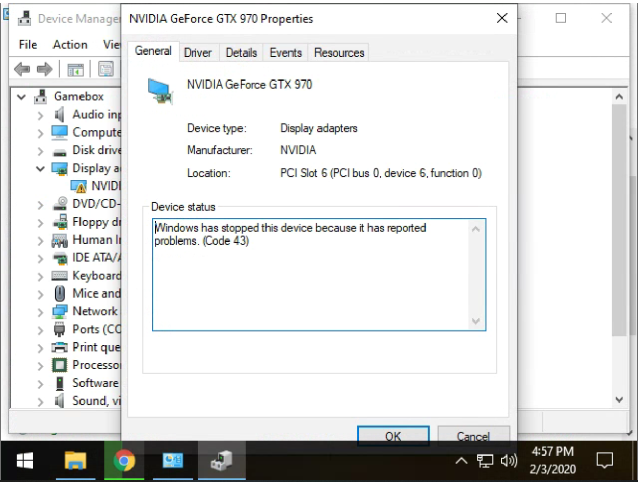

    • Code 43 on 970 in device manager (well shit)

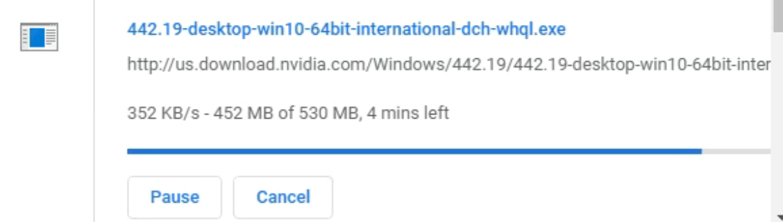

    • started downloading driver manually via Nvidia website (thanks Nvidia for throttling the download to a trickle in favor of your Gforce Experience installer)

    • read up on error 43 via This Link

Specs of VM when attempting to run the 970SC:
XML of 970 SC:

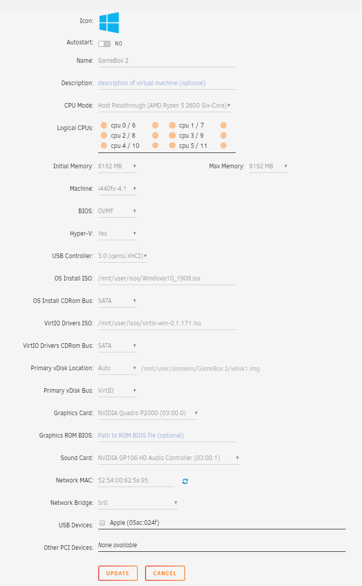

Specs of VM when running on P2000:
XML with P2000:
