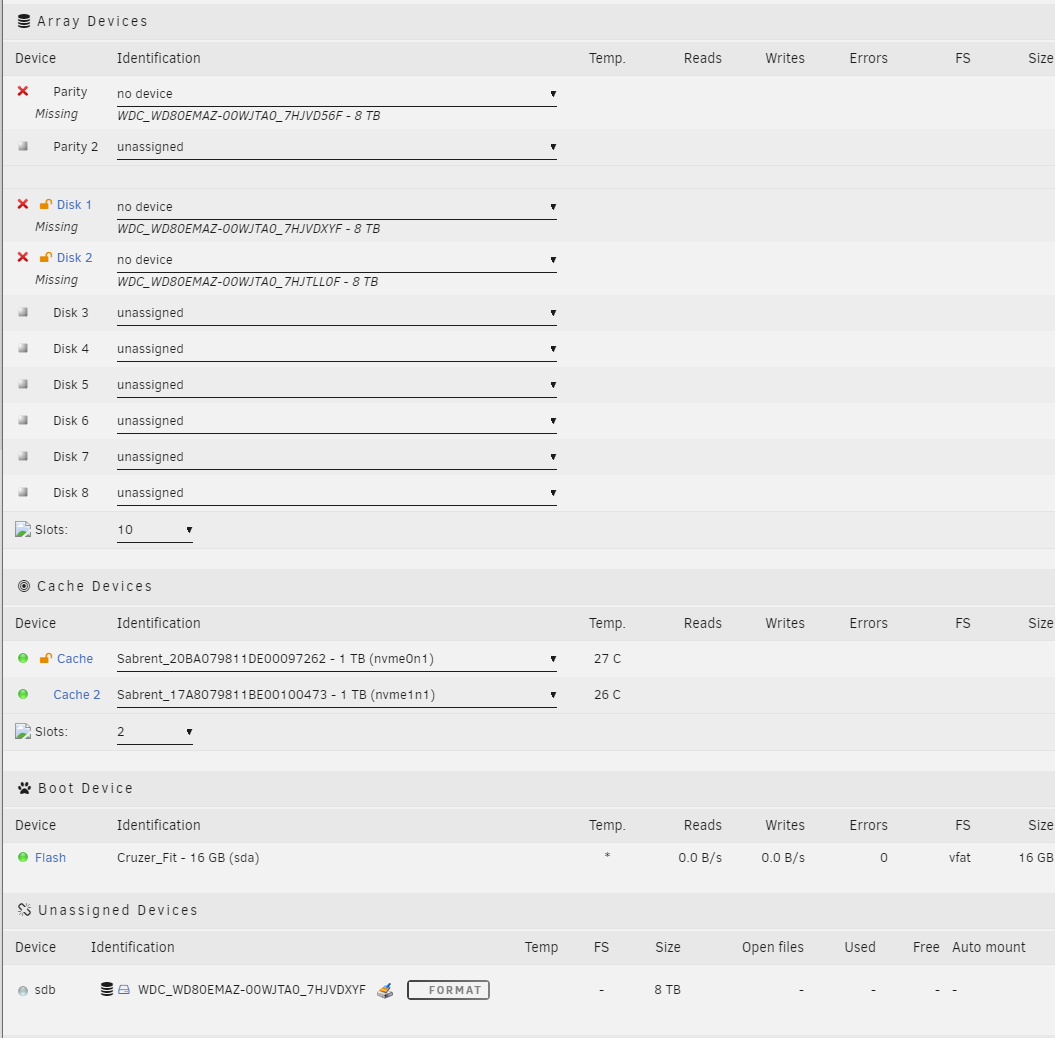

[UPDATE]  All drives now show up in unRAID as Unassigned Devices. Three 8TB WD white drives. They are showing as "missing" under Array Devices and can not be added back? Pleas let me know if you have a solution

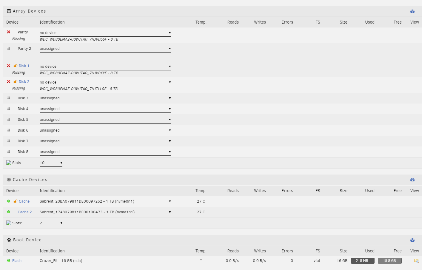

So I rebooted but my disks are not showing up. Any ideas what's going on?
Is this a hardware issue? I have an external LSI SAS card that's been controlling the disks in a DAS.
How do I check the status of the LSI card?

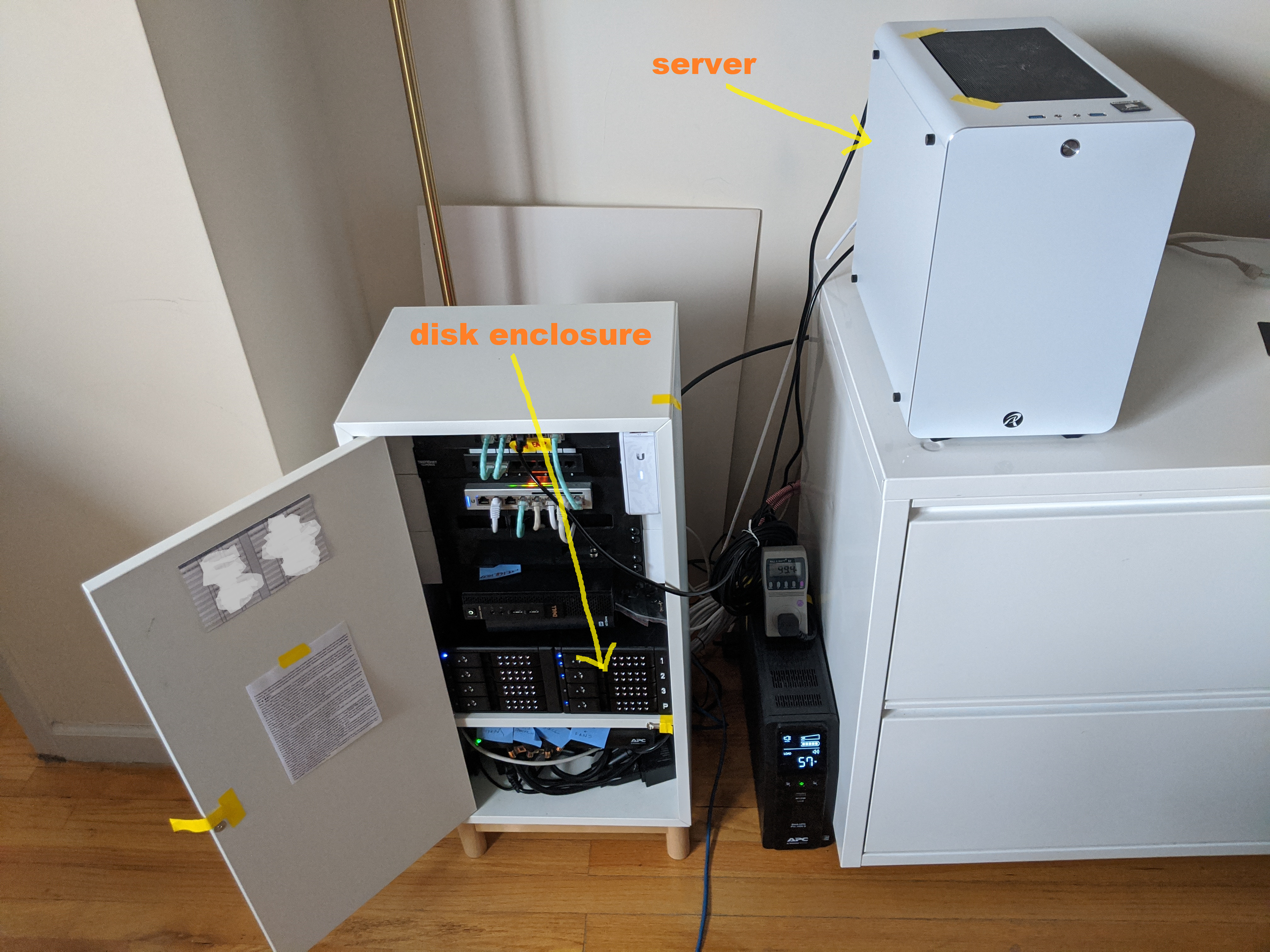

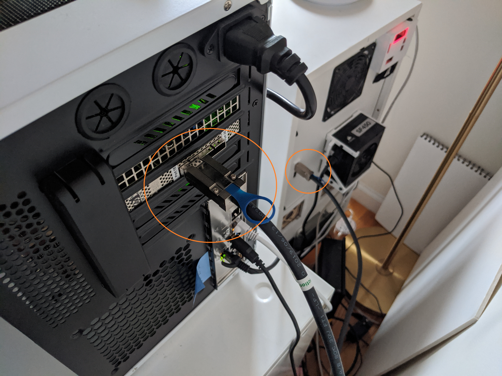

Here is the the server and enclosure cabinet side by side:
Here is the 8088 cable going from the HBA in server to the cabinet (you can also see the PSU) :

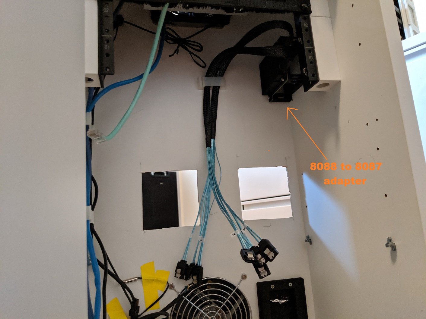

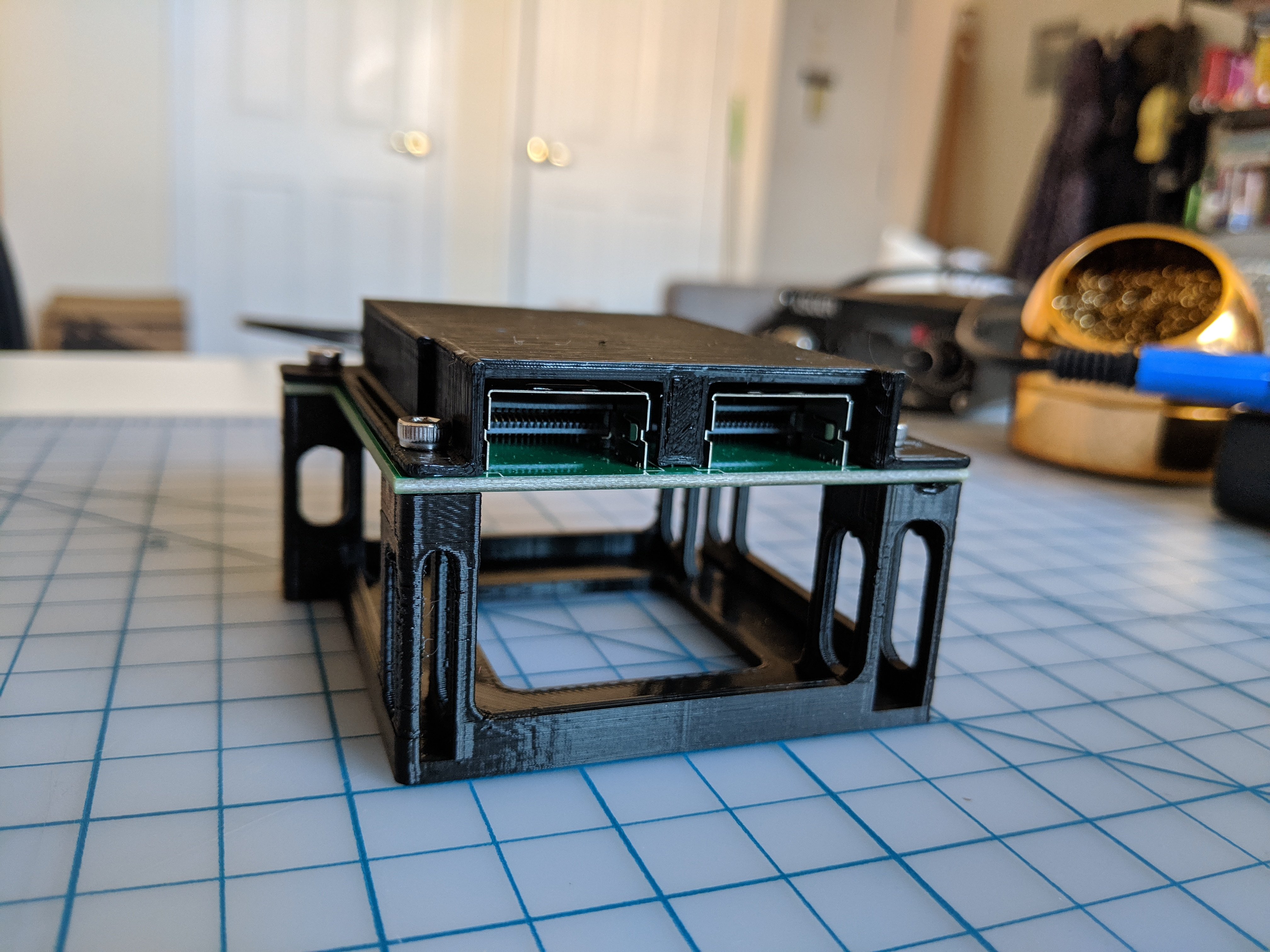

I mounted this SFF-8088 to 8087 adapter in the cabinet:
Here is inside of cabinet showing 8087 break-out cables:

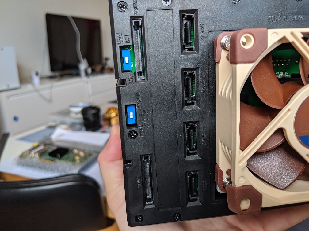

The SATA cables plug into the back of the iStar boxes:

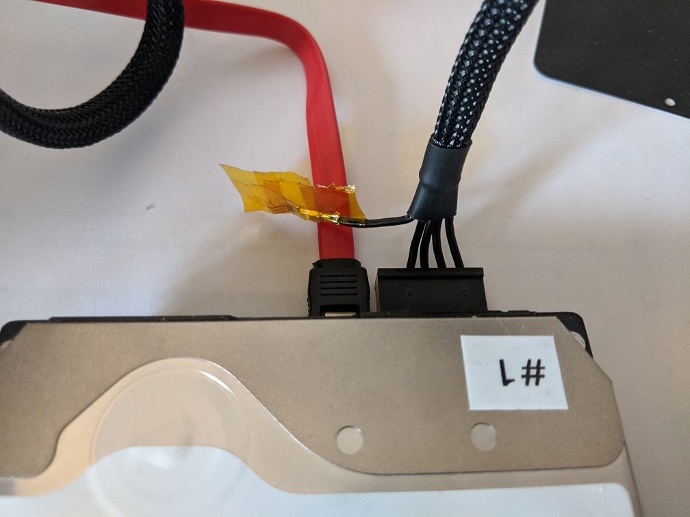

Are you sure the tape is working correctly? Do you have a molex to STA adapter? If yes use that.

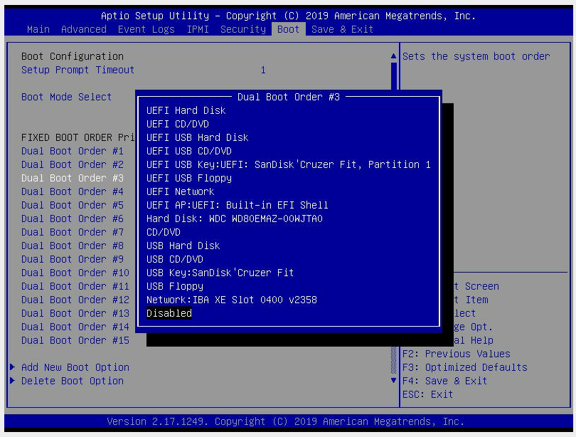

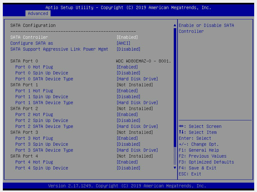

I'll swap for the molex now. I'm sure this doesn't matter but the disk does show in the BIOS now. It didn't before when it was in the HBA (unexpectedly)
It wouldn't show up on the motherboard bios, only on the HBA bios.
Didn't have a molex adapter so i removed the pin.
tower-diagnostics-20200206-1430.zip

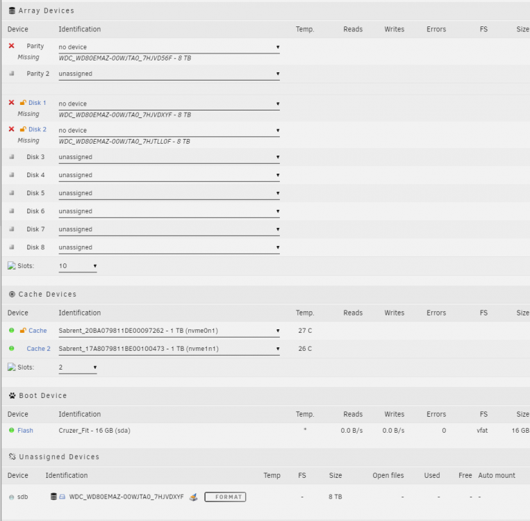

Good news? The drive now shows in Unassigned Drives!
Looks like SMART is still failing?
Edited by adminmat
I can see the drive (Disk 1) in "unassigned Devices" now. But I can not select the drive up in the Array Devices using the drop-down menu. When I click the drop-down menu arrow under Disk 1 the only option is "no device"

I've since removed the LSI SAS HBA from the server to see if that helped. Still have Drive 1 connected via MOBO SATA. It's still showing as an Unassigned Device although it has the same name as before which is still listed up in Array Devices.
Any ideas, anyone?
There will be some difference if it is still in Unassigned Devices.    If the names match then the reported size may be fractionally different which will cause Unraid to treat it as a different device.
