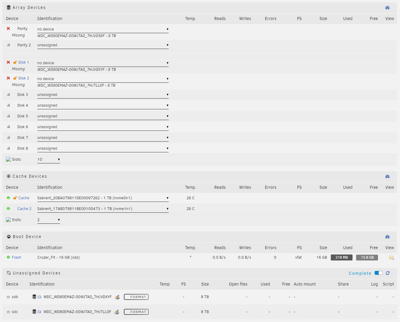

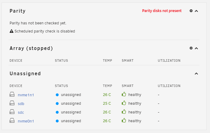

All Data Drives Missing: Please Help
7 minutes ago, itimpi said:
There will be some difference if it is still in Unassigned Devices.    If the names match then the reported size may be fractionally different which will cause Unraid to treat it as a different device.
So how do I tell unRAID to assign it back to being Disk 1?  I'm at a loss of what to do?
Is there a way to pull the data off Disk 1 if I connect it to another PC? It's encrypted so I'll need to un-encrypt it somehow.
If i install Ubuntu, can I un-encrypt it and copy the data to another drive?
Should I contact Limetech at this point?

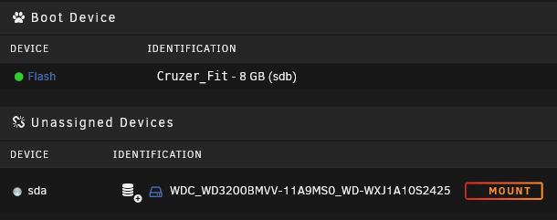

Added Drive 2 to a SATA port on the mobo. Drive powers up and also only shows in Unassigned Devices. I assume this will happen for the Parity drive as well.
How can three, 8TB Western Digital drives all go bad?   Still at a loss of what to do.  Posting config again.

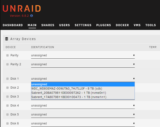

I am creating a 2nd USB drive for unRAID. I have currently been running 6.6.7. Looks like Limetech has removed all other past versions from the USB flash creator and the Download page. I assumed I should stick with 6.6.7 for this "recovery USB".
Where can I find 6.6.7?
Should I try 6.8.2? (only option showing)
Also, Should I pull my cache pool drives out before i boot the new unRAID USB?  I'm worried that pulling them out at this point may make them unrecoverable as well?
Edited by adminmat

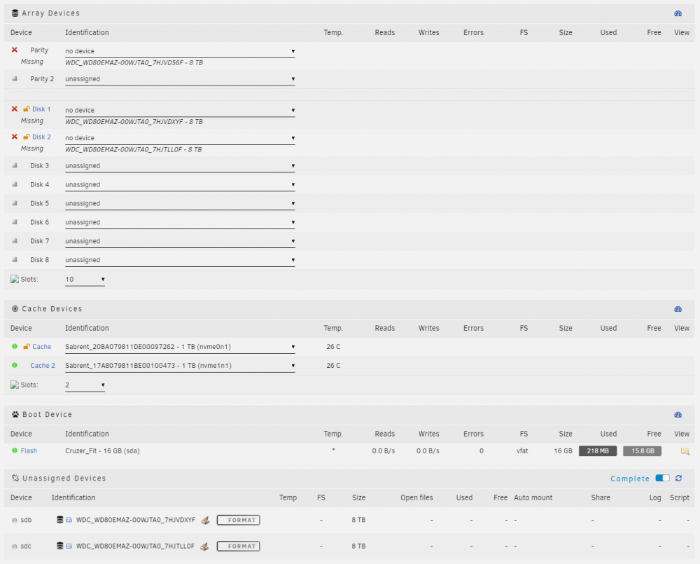

@Benson , @johnnie.black I went ahead and booted unRAID 6.8.2 on a separate USB. I left the cache drives connected and connected one HDD to the motherboard SATA port. It does show up in the drop down menu. I did not select any drives. I've since powered off the server.
What should I do next?
(I should add that when I watch the boot screen via IPMI I saw many "errors", "failed" messages with the previous boot USB as unRAID loads. I did not see them this time)
New Diagnostics attached

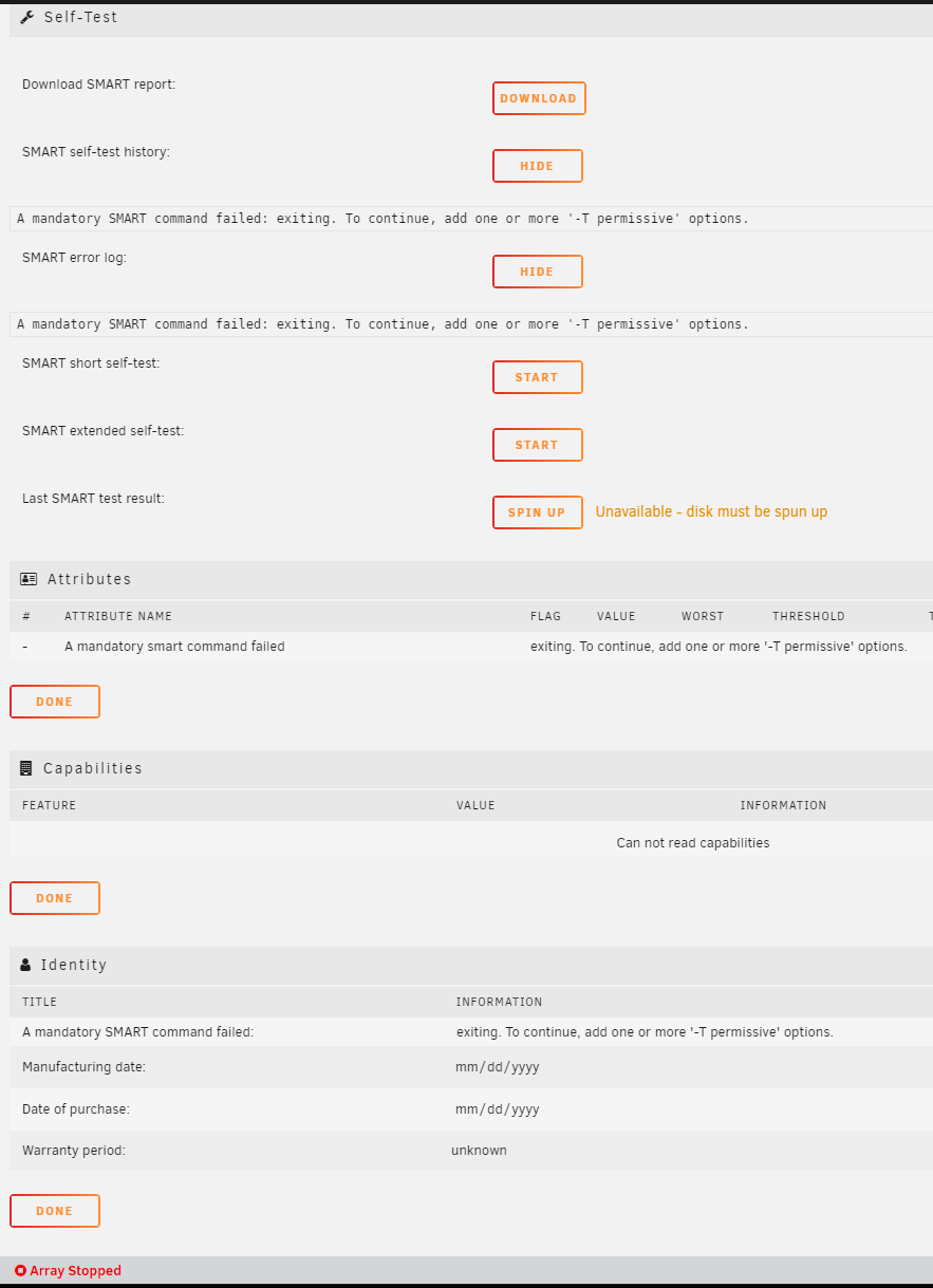

The error should due to Unraid try to mount those disk in original stick and new stick haven't, so no those error.
Bad sign was it confirm all three 8TB disks got SMART Log Directory table read/write error.

ATA_READ_LOG_EXT (addr=0x03:0x00, page=0, n=1) failed: scsi error medium or hardware error (serious)
Read SMART Extended Comprehensive Error Log failed
Read SMART Error Log failed: scsi error medium or hardware error (serious)
ATA_READ_LOG_EXT (addr=0x07:0x00, page=0, n=1) failed: scsi error medium or hardware error (serious)
Read SMART Extended Self-test Log failed
Read SMART Self-test Log failed: scsi error medium or hardware error (serious)
Read SMART Selective Self-test Log failed: scsi error medium or hardware error (serious)
May be due to those error, Unraid will identify those disk were bad.
Next I would suggest perform disk SMART short / extended "self" test to verify does disk can read the disk media, For extended test on a 8TB disks, it need ~20hrs to complete, pls don't do anything during extended test, otherwise it may interrupt the test.
Anyway, don't allocate any disks in new OS.
EDIT 1:
If disk media allow read and write then it means data may recovery.
If just SMART error made system identify it bad, does mask/block SMART data access can solve the problem ??
EDIT 2:
For extended test on a 8TB disks, it need ~16hrs
Edited by Benson

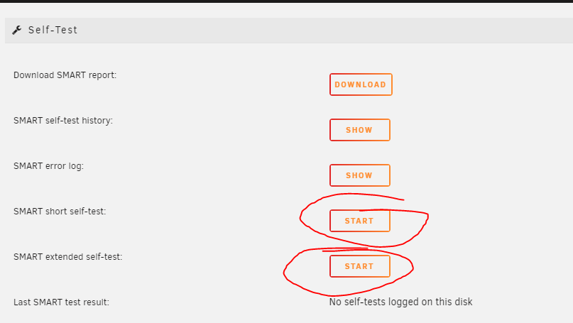

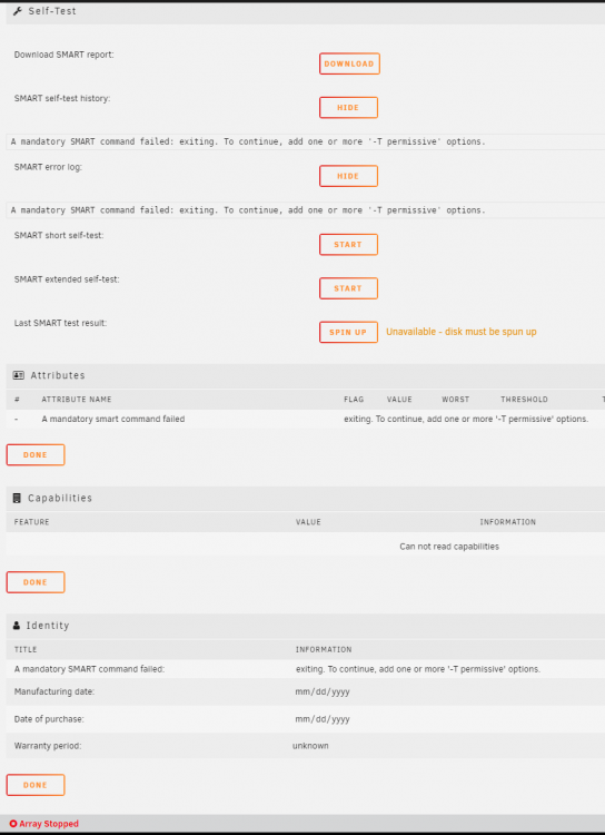

ok @Benson when I click on Start next to "SMART short self-test" and "SMART extended self-test" the start button changes to "stop" then immediately back to "start."  And nothing happens.  Is there something i need to do before i can start the test?
Nothing need to do before the test. This should be expected, SMART have error and won't allow to perform SMART self test.
I compare if disks connect to LSI HBA or onboard controller, Unraid also prompt error, so it really trouble. If no breakthrough method, then I don't think you could solve the problem.

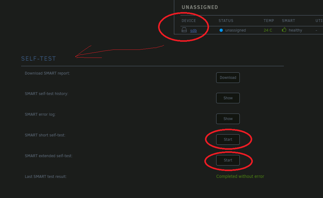

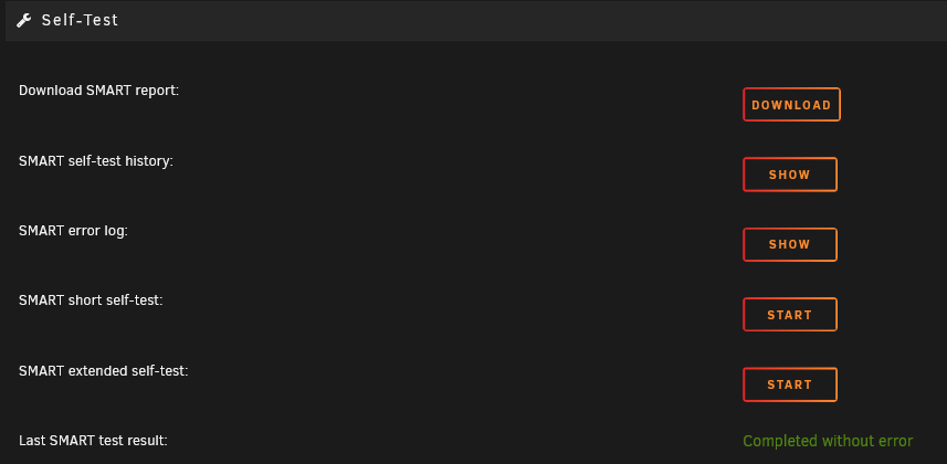

Do you have some USB <-> SATA bridge adapter ?? If yes could you try attach a disk to it and plug in Unraid and provide the diagnostic.
On 2/7/2020 at 4:48 AM, adminmat said:
Disk 2 is empty AFAIK.
Pls use this disk to connect USB-SATA adapter.

Yes. But wait some minute, because I will show a diagnostic for attach a USB disk for your ref.

Or I have those adaptec too, I can make some test instead you try on your hot data disk.
I connected the drive to it's Easystore board. Plugged in the drive via USB. I can't run the SMART test. Maybe the Easystore enclosure board has an effect?  Should i assign i to the array?
Edited by adminmat
I try two USB adapter, but all will passthrough the SMART data to Unraid. I want found some which won't passthrough the SMART data and see this would help or not for your case. BTW no advice in this moment, pls wait other party for advice.
sdb was Unraid OS USB stick
sda was a USB disk and all SMART data also passthrough
Edited by Benson
