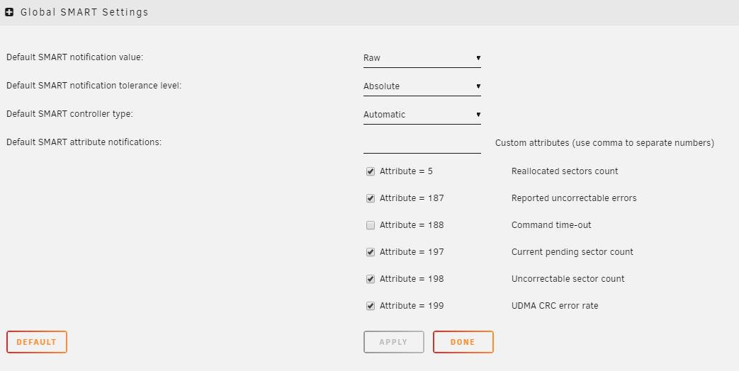

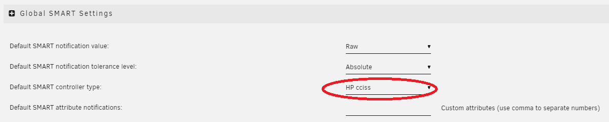

15 hours ago, adminmat said:
I don't know how to test this but I'd like to try.
The idea was set in "disk setting" -> "controller type" to some wrong setting, i.e. "HP cciss". I try this and reboot also can identify all disks ( no matter LSI or onboard), but no SMART data show anymore.
Pls test it in new Unraid and then check the log does no more SMART error, if positive, you may bootup orginal USB and set it and check again.

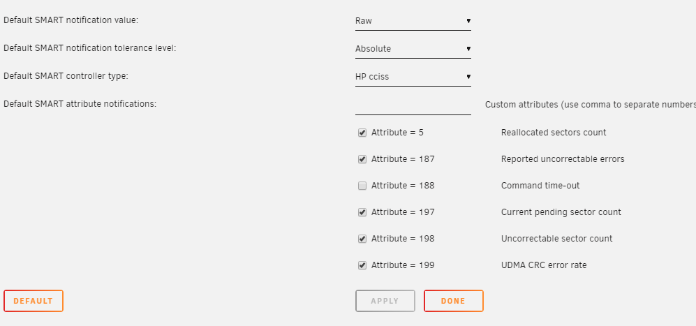

On other hand, does you feel disk was spinup ??
Below are ther error which show in your log
A few more things I've tried:
- I've tried changing the controller type as you recommended. It was already set to "Automatic." I changed it to a few different things from the list with reboots each time, then back to "Automatic" and a reboot and still could not run a SMART Self test.

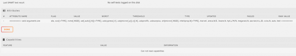

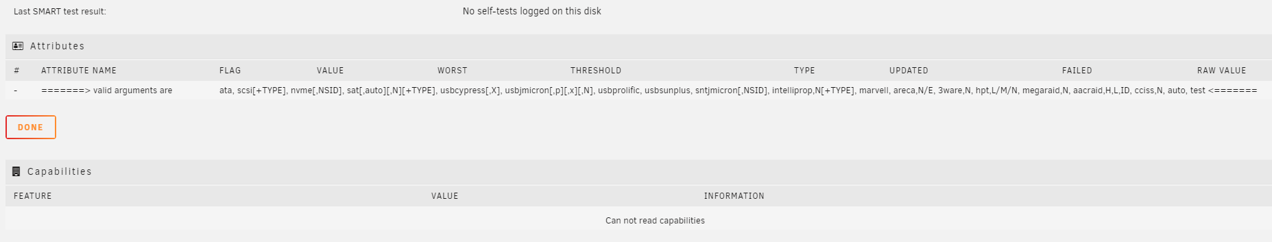

Target not on SMART self test, just hope unraid could identify those not a bad disk. That's why I need you check the log and see any good sign.
So this means I just run a diagnostics report after changing the controller type and rebooting?
Pls check or provide the log after you change the "controller type", if no good sign then I haven't suggestion. I also want to know does you feel the disk was spinup ?
I'll check the log tomorrow. I definitely feel the disks spin up. They don't stop spinning until disconnected.
Yes, pls check the log and post it here.
