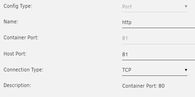

My container is configured as follows:
(This is a clean nginx container that is only being used to verify that the port-forwarding is working correctly.)
I've also tried using different ports than 81 and 444 without success (while updating the port-forwarding rules accordingly) as well as pointing to port 80 on the server instead of port 81, which should be the UnRaid GUI, but I was unable to access this as well.

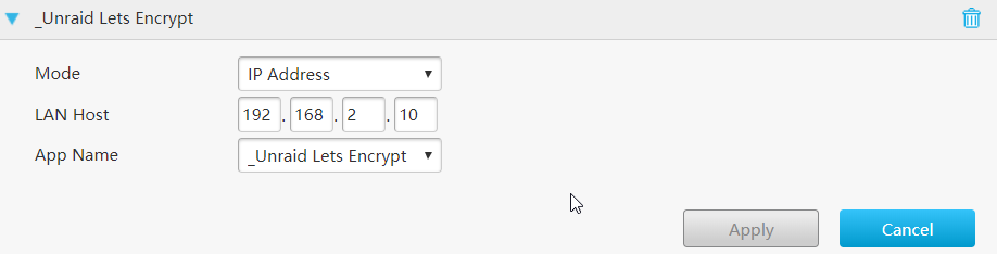

You assigned your server with a static IP address of  192.168.2.10   Did you inform your router that you had taken this action?  (Virtually all modern routers have a mechanism for removing IP addresses from the pool of addresses that the DHCP process can use.)
The router does not specifically know that the server is on 192.168.2.10, however the router is configured to only hand out ip addresses in the range of 192.168.2.50 to 192.168.2.255 (the first 50 being reserved for devices that require a static ip). The UnRaid server is the only device requesting 192.168.2.10.

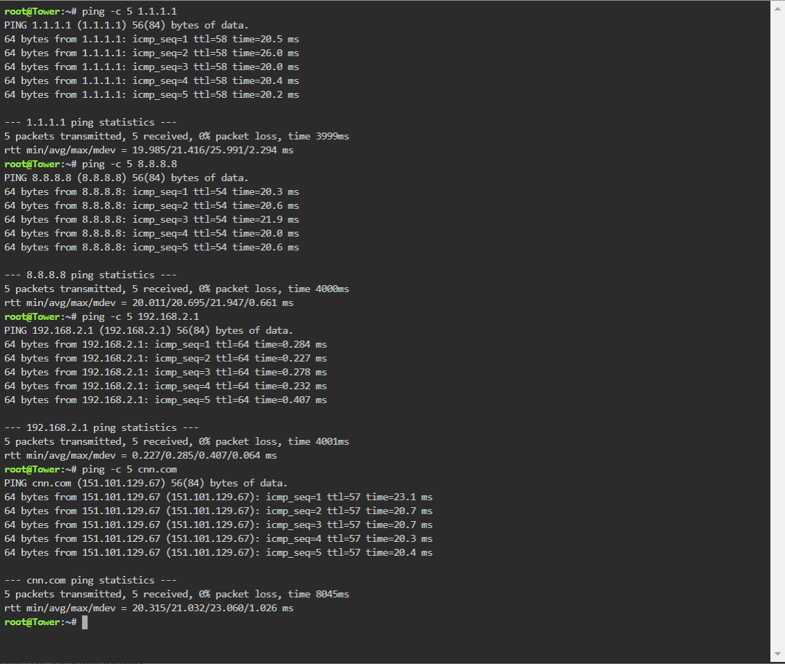

Try the following from the console:
ping 1.1.1.1
If that works, try:
ping cnn.com
As you can see your server has Internet access and appears to be working properly.  I would suggest that you now post about your problem in the Support thread for the Docker container that you are using.

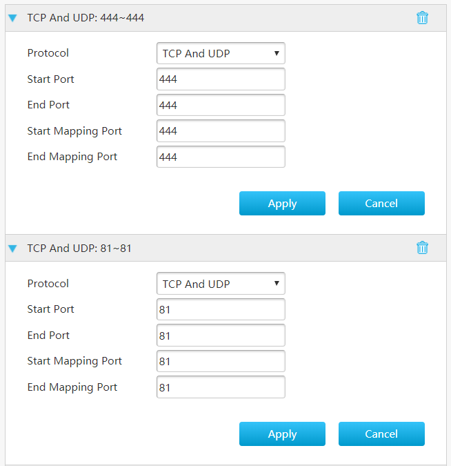

I am using a ZTE H369A as modem/router.
I currently have it configured to forward port 80 to port 81 and port 443 to port 444 on the server:
On yougetsignal it is showing that my port is closed however. I am unsure if that means that it is actually closed or that it just can't find anything running on that port.

When accessing the plain nginx container locally on port 81 it goes to the nginx "hello world" page, which is the expected behavior.
I just noticed too that the letsencrypt container is not configured correctly. I am pretty sure this wasn't the case before. I am also unable to change it now. (as you can see the container port is greyed out). Nevertheless, this is a secondary concern. The main issue right now it that I can't get the port-forwarding to work on the plain nginx container (if it works on that one, it will probably also work on the others if they are configured correctly)
I also know that I can't port-forward port 80 directly, since the unraid GUI runs on port 80, which is why I forwarded port 80 on the router to port 81 on the server.

I have changed my portforwarding rules to this:
When forwarding to my PC:
Port 81 (changed nginx config to also listen on 81) shows as open and I am able to reach the nginx server from outside my network.
When forwarding to the UnRaid server:
Port 81 shows as closed and I am NOT able to reach the nginx server from outside my network.
