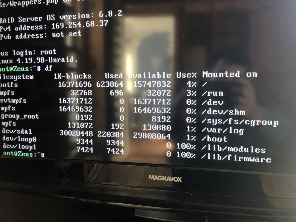

When I enter "root" at login on the server, it just goes to "root@Tower:~#" and it is not accessible via Web GUI.
It might be worth posting the output of the 'df' command so we can see it the USB stick is being mounted at Boot

Thank you for your support! Attached are the diagnostics of different boot attempts I've done (base network config, deleted network config, network config edited based on one of the comments of a similar post, and latest boot attempt).
I also attached a picture of the "df" command (didn't know how to copy that over to my windows computer).
