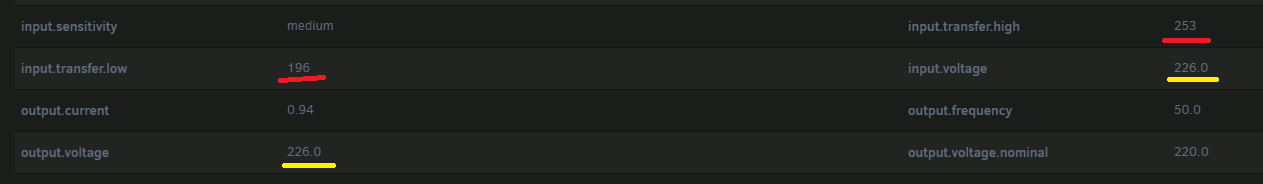

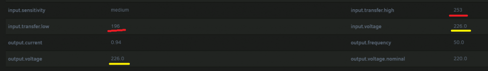

Below are the setting of my UPS, you can see if input voltage under 196 or over 253, then it will trigger UPS to battery mode. My interactive UPS was in standby, so output voltage will be same as input voltage.
Edited by Benson
