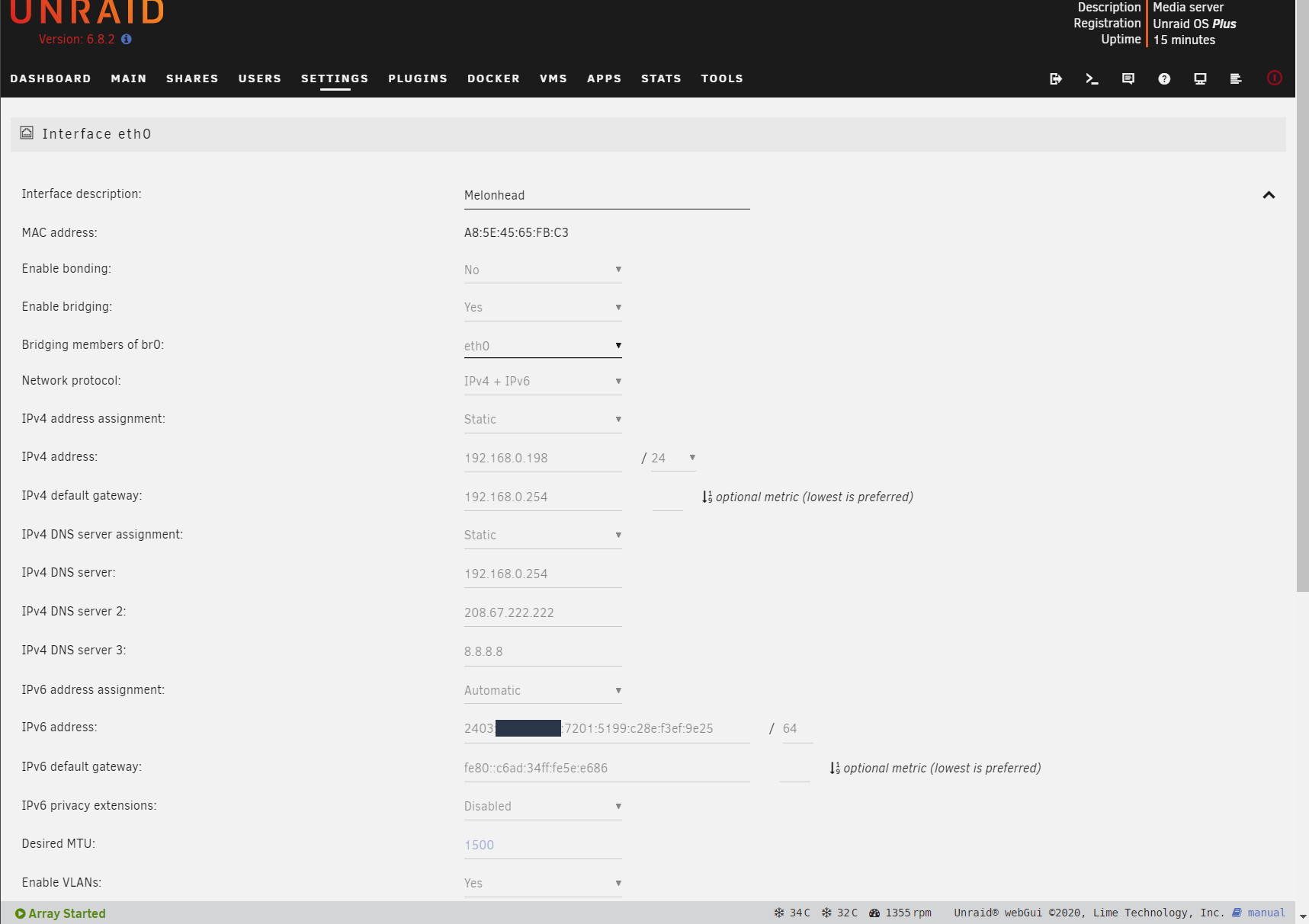

Here's my network settings:

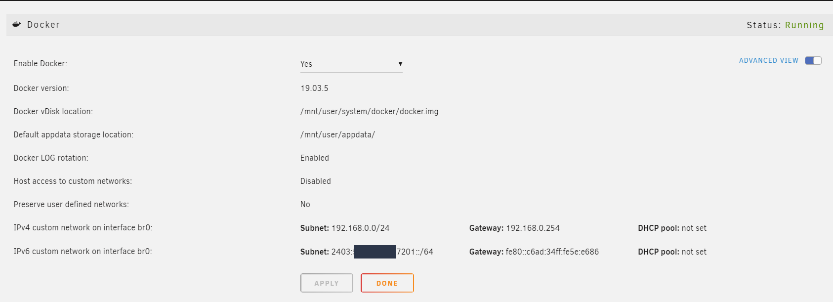

Here's the docker settings:

Docker doesn't like a link local address as gateway address.
Configure your router with an IPv6 address in the same subnet as the hosts, which can act as the gateway, e.g. 2403:XXXX:XXXX:7201::1/64

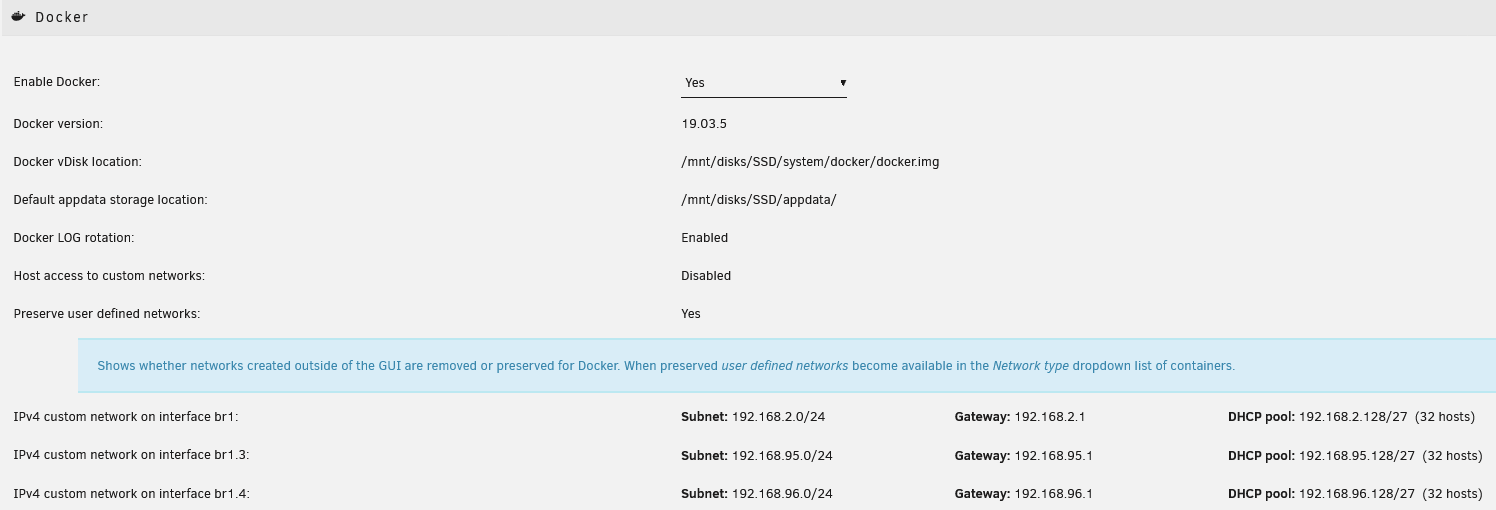

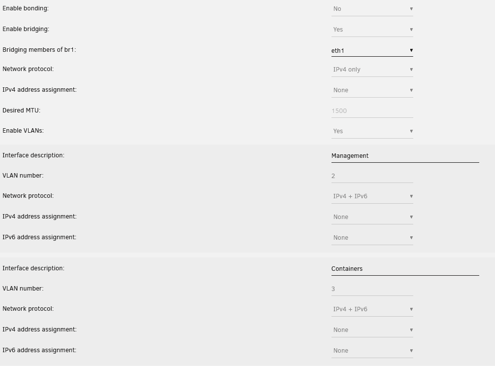

hmm. have the same network setup as @Kaldek
But I use a secondary NIC and configure it for no IP4 assigned. no IPv6 assigned either. (Turned on IPv6 but did not assign one) - the Containers VLAN
and only IPv4 on the docker networks
Then I add this to all my containers
<ExtraParams>--sysctl net.ipv6.conf.all.disable_ipv6=0 --sysctl net.ipv6.conf.eth0.use_tempaddr=2</ExtraParams>
This then makes them have get SLAAC IPV6 addresses (disabling the privacy extension - temporary IPv6 address)
I suppose I can make them better but havent had time to tweak the network stack as I'm doing all this remotely.
EDIT just realized it might not even be necessary to enable IPv6 on this secondary NIC as the base eth1 is IPv4 only but a container there does get IPv6 address anyway
Edited by ken-ji
With Unraid 6.8 IPv6 will be disabled on the interface when it is configured as IPv4 only.
6.8? or 6.9?
6.8 (but it could be one of the point releases, I can't remember exactly when I added this)
I turned IPv6 on on all pertinent interfaces just as I updated to 6.8.3 - and I don:t see any adverse effect, other than Unraid trying to assign it self a bunch of IPv6 addresses. I:ll see what happens if they are disabled at a later date. However, the Docker extra params I:m using is still ok for my needs as the container still gets a class one IPv6 address that participates on the LAN without interference from Docker (or network config for that matter)
