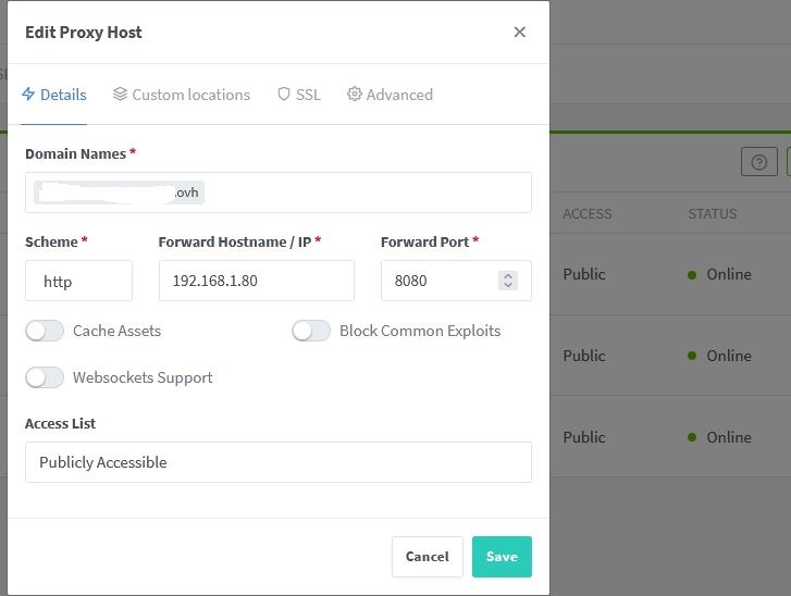

Hello, swag is nginx, but no prob, I just tried with NPM.
domain works, connections from outside to my apps work (subdomains and domain)
wordpress works with wordpress.mydomain.com in local (not via internet)
deleted Mariadb and wordpress to redo install using wordpress.mydomain.com (local because not reachable via internet)
I don't understand where is the problem.
looks like I'm missing something special in nginx
when I try wordpress.domain.com I have a blank page saying nothing found but when I look at the adress it displays https://wordpress.domain.com:8080 so it looks like nginx is working but wordpress not displaying the page....
How did you redirect in NPM, should be to your internal address eg. 192.168.1.100:8080. Looks like you it asks for the domain:port, shouldn't do that.
You shouldn't need to have any special settings for nginx, NPM takes care of it.
I don't understand your "wordpress works with wordpress.mydomain.com in local (not via internet)"?
Kru-x
redirection to internal IP. it works for another apps so it should be the good methode.
on my lan, if I type wordpress.mydomain.com:8080 I go to my wordpress
if I try wordpress.domain.com via internet(other computer, other network, other building) I get a blank page
Looks right, first try to empty your cache in your browser. Still not sure how you can reach your domain on your local network eg "wordpress.mydomain.com:8080" should not work , but 192.168.1.80:8080 should work.
Try to delete both folders again especially the DB, then see if you can reach the WordPress install by your local IP (don't install anything from your local IP), then try to reach the WP installer from your domain and install from there if it works. Holing my thumbs. 🙂
if I delete both folder, localy, I can reach WP (after creation a new db) via 192.168.1.80:8080
but if I use a computer on internet, I can't reach anything from wordpress.domain.com... blank page
if I try from wordpress.domain.com:8080 from my local computer, it works.
NPM conf is ok since I can access Guacamole and Tautulli without issue on other sudomains.
something is wrong on WP part, but I can't understand what

Kru-x
I found my problem.
it's from my dns provider, something is wrong.
if I point dev.domain.com to my wordpress, it works through internet.
thanks for the help ;-)
