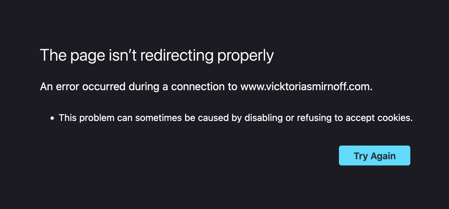

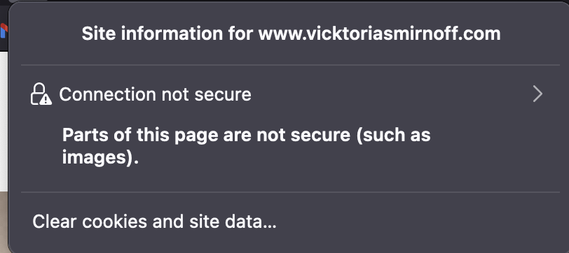

Hello again,
I managed to create a second wordpress container for a second website.
However, I am facing a small problem.
When I configure NginxProxyManager to Force SSL for the www subdomain, the website fails to load showing this error message:
1646129143_Screenshot2022-10-29at12_39_02.thumb.png.0c7b8b3c5647800ca517ebca227af949.png
If I disable Force SSL, the website loads using the https URL, but with a browser site info saying that the connection is not fully secure, and uploaded images are now properly displayed:
Anyone has an idea how I can fix this?
Edited by mjeshurun

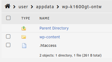

Hey,
Ported my test WPress site (was on a ubunut 20.04 vw + mariadb + apache2) to this WP docker container and moved de database to the mariadb container (from lscr.io / linuxserver) repo.. Bit tinkering. Got both containers on a custom network so wordpress can easily see the database). Was quite easy to do  - had to import a sql backup I make earlier.
Got some question tho..
The container-path points to /var/www/html - which is fine I guess, but also includes the wp-content (which holds the user-data like plugins, themes, uploads). I believe that wp-content should be the only thing on appdata - the rest (imho) should be part of the wordpress image.. I can now temper with the wordpress installation. Normally when you restart the container the container is destroyed and recreated. Could you explain that? What if we receive an updated container?
Would it be possible (or even recommended??) to add a volume to /var/www/htlm/wp-content > appdata/wordpress-site1/wpcontent and a link to the /var/www/html/wp-config.php to appdata/wordpress-site1/wp-config.php.
Planning on have 3 sites running (test, "live" and an internal which is total different)
I mean - that is the power of docker right? - one image, multiple containers with diff settings leaving the same files to the image itself
Edit:
Yes - that does actually work - I did not find anything on the official docker hub page but this kind of thing normally works as I've done quirks like this myself with my own dockers. To test it a bit further - I stopped the container, pruned it, removed the image. wp-content stays (ofc it does). Then I reinstalled the container from the template (hooray for unraid to save those templates) and I could just visit the site right away. Did found one weird thing. My "live" site (k1600gt.nl) renders well but the version running from the docker does not render a couple of blocks like it should. I checked - nog weird 404's or php error soooo not sure.. Might be a php8 thing since the live site runs 7.4 something.  The live one and the docker one are exactly the same - i restored a back of the database and content into the dockers and fixed the url's,
Edited by sjoerd

Hi sjoerd,
I can follow your thinking and I wonder myself, but WordPress updates internally and gets updated on the fly, thus you always have the latest version keeping it like it is. Guess they update the docker container for a new install. I think you get in to more trouble to do it that way, than not.
Question back, as I see that you are installing new instances. Do you get a problems in "Site Health" on a new install? Eg. open tools/settings/Site Health and see if you get any recommendations of faults, I have a few pesky ones that I don't know how to solve. like "The REST API encountered an unexpected result" & "your site could not complete a call back", doing my head in!
Regards,
Kru-x
19 hours ago, sjoerd said:
Hey,
Edit:
And after reading your post thoroughly :~(): the container only copies the files the first time to the folder, any subsequent restart docker leaves the existing files and only adds files missing, thus if something changes in the file docker will not override it. But then as you said you should leave all file AS IS except for the wp_content, so you have a point.
The read and write access will be different in the container and WordPress wouldn't be able to update the files internally so the internal update would not work, you would have to wait until the container is updated I believe, so you would most likely get in to heaps of problems and I wouldn't recommend it, but then I am not an expert so I could be wrong.
Kru-x

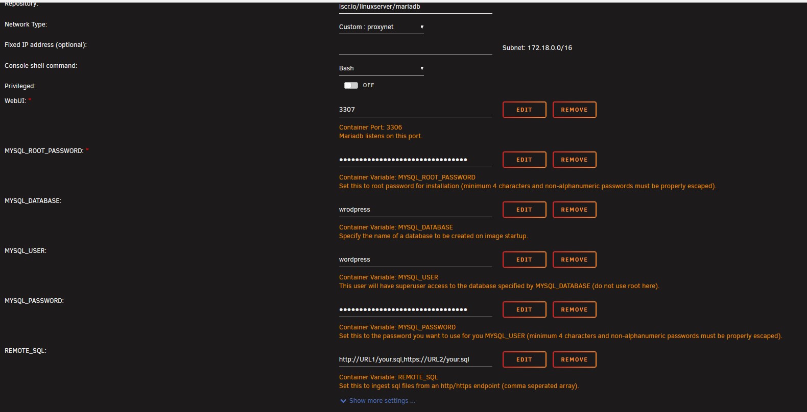

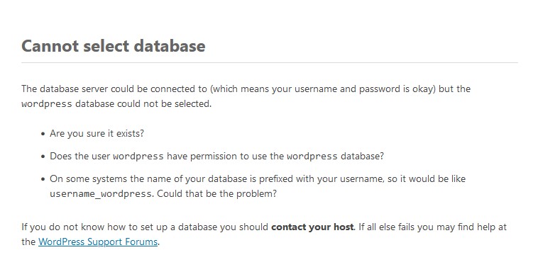

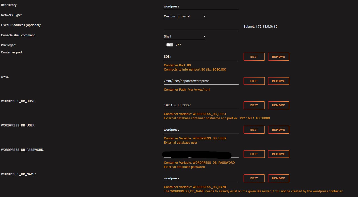

Hi I have an issue where I get "Cannot select database". I'm using a second instance of mariadb from linux server (other one is being used by nextcloud). I'm not sure what the issue is as it says the username and password are correct but that it can't access the database still. Thanks in advance. sorry If I'm just doing something dumb.
http://192.168.1.1:8081/wp-admin/
wordpress setup
mariadb setup

Have you given the user "wordpress" full read and write access to the "wordpress" db in mariadb? Sounds like you haven't,
Kru-x
