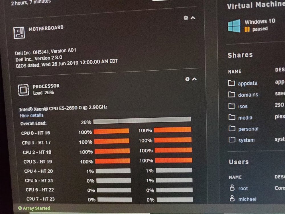

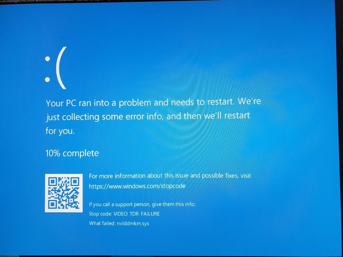

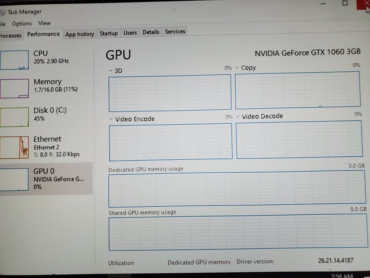

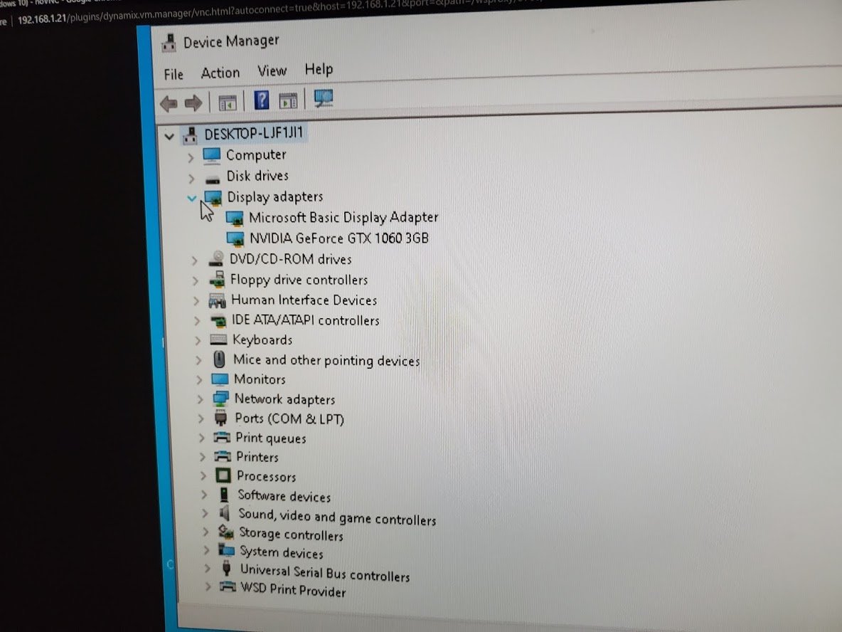

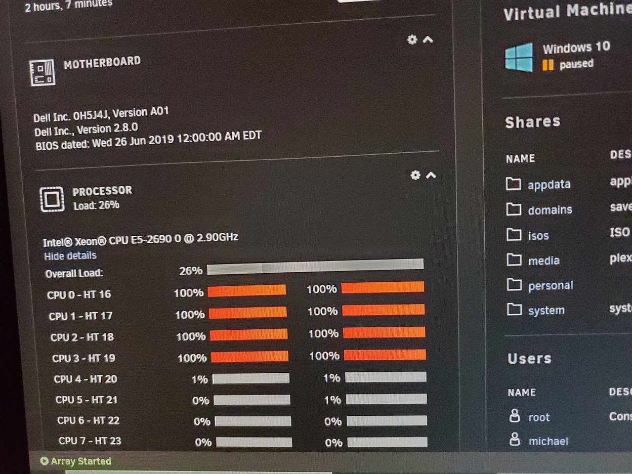

I then tried using VNC as the first Graphics Card and the 1060 as the second. It boots up and as seen in the photos attached, I can see the 1060 in the device manager and task manager and it seems to be working fine. However like in a minute or so it crashes with the BSOD as shown in the picture attached.
Also when it crashed the cpus are maxed out for some reason.
