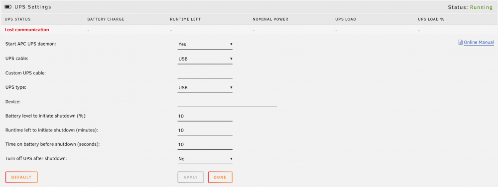

Hello!
I have an EATON 5E 2000i USB UPS. I connected it to my UnRaid server with USB cable. The server sees the USB connection, I verified this on TOOLS/System Devices.
Bus 001 Device 026: ID 0463:ffff MGE UPS Systems UPS
I constantly get UPS Alert Communications restored with UPS notification and the APCUPSD show that the communication lost.
The notification is coming non stop.
I verified the UPS on another Synology system with the same USB cable, it Works perfectly. Can somebody help me with this?

Have you tried another port?
Yes
Try a USB2 port...
28 minutes ago, Frank1940 said:
Try a USB2 port...
I have only USB 3.1 Gen1 or Gen2 port. Both of them have the same issue.
Bus 001 Device 001: ID 1d6b:0002 Linux Foundation 2.0 root hub
Probably on a motherboard header. Don't know if it would help or not.
Is Synology using APCUPSD?
I found an adapter for the internal USB 2 header. The behaviour is the same.
I don't know what is the built in Synology UPS based on.
I guess you could try the NUT plugin:
After some configuration NUT worked.
Thank you!
