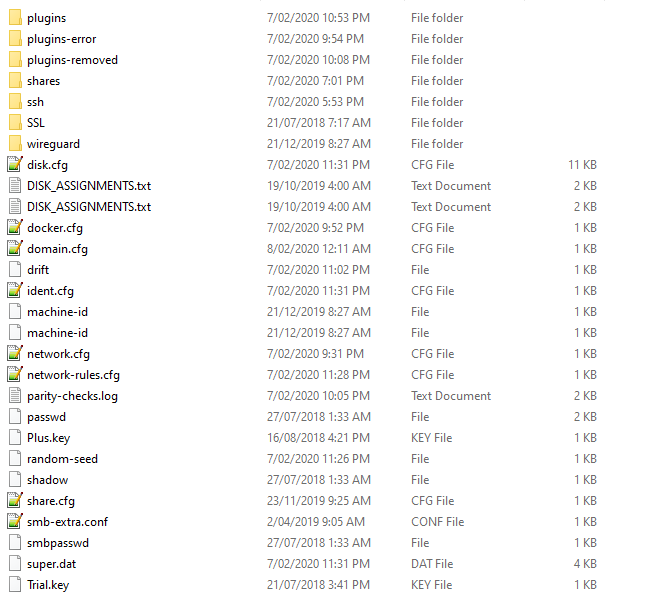

You flash drive is missing the go file, it should be on the config folder, extract from an Unraid downloaded zip.
Do you have .FSCK files on your flash?
Thanks heaps for you assistance. Go file was missing and there were FSCK*.REC files on the USB flash.
I have moved a copy of the go from a backup of the flash drive.
Oddly there are duplicates of DISK_ASSIGNMENT.txt & machine-id files:
I will remove these duplicates and give the system a reboot.
