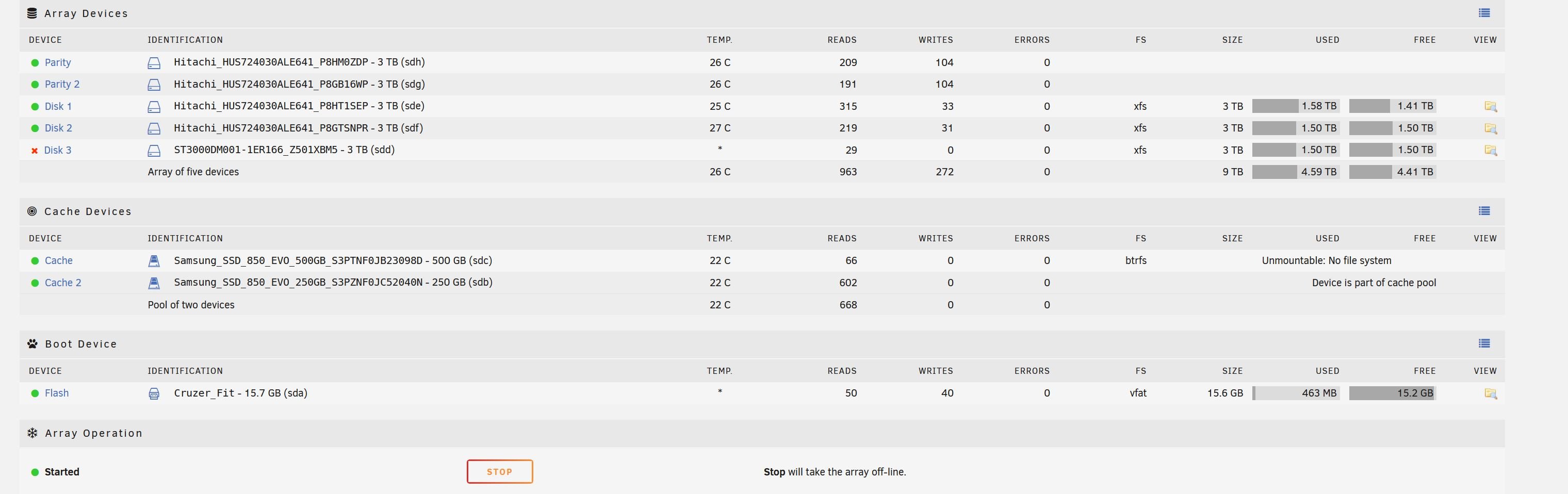

Disk3 is disabled, but the emulated disk is mounted. Your cache is not mounted though and that is probably the reason for the other problems. You should be able to see these things on the Main page but you did not mention it. Post a screenshot.

Screenshot of my main page is attached.

The rebuilds won't do anything for your unmountable cache pool.

Pool was misconfigured, one of the devices was being removed, see here for some recovery options.
