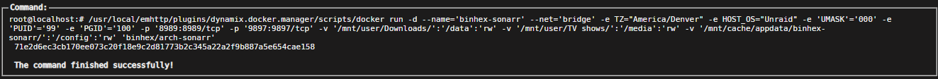

Here is the SONARR RUN script: I will get better ones
Edited by BigBirdie
Screen shots are unreadable
Sonarr run

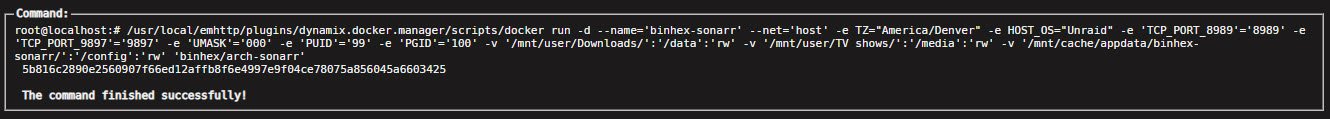

Here is Sonarr switching to Host (above is going to Bridge)

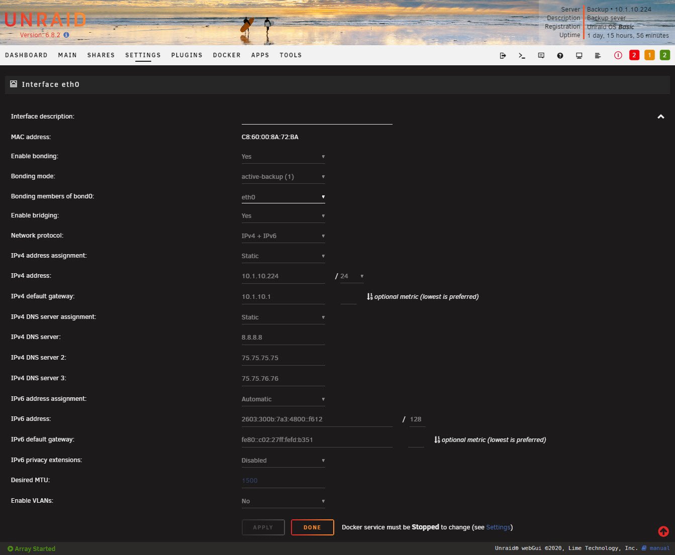

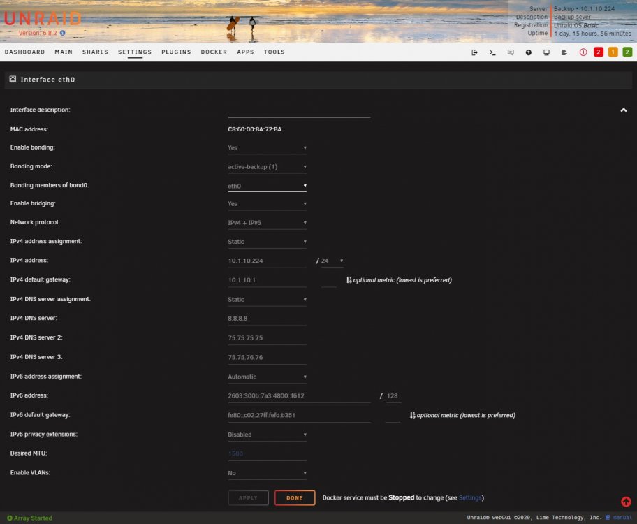

Here are the Network settings
