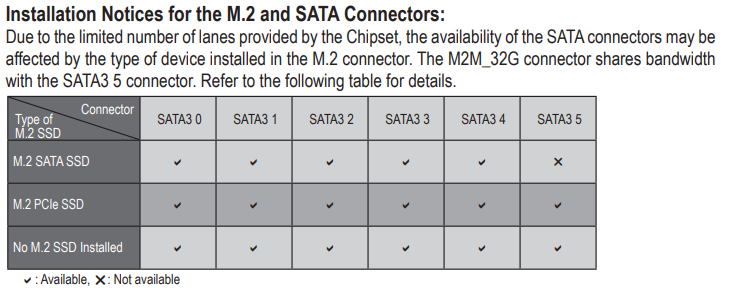

Does having an M.2 not usually mean losing at least 1 SATA port? M.2/NVMe etc are all quite new terms for me, so still learning.

There are two types of m.2 drive, SATA and PCI-E.  Sata is a regular drive on a gum stick and in some cases shared ports with existing sata controller so you lost one if you used m.2.
The b360 / b365 has a good number of PCI-E lanes from the chipset so can operate a mix of PCI-E X2 and x4 gum stick drives which are independent from Sata. I have a WD blue in my gaming pc, approx 3 X SATA speed and very little price difference. Be aware there are both SATA and PCI-E drives labeled blue so you have to get the right one.

Yes that WD Blue should work just fine and like you said, you will not lose a SATA Port like that. So yes, you’ll need to look at NVMe M.2 SSD’s. Not sure if that WD is the best SSD for the price, some people with more knowledge might have better answers on that.

Some B360 do disable a SATA M.2  but only if you install a SATA M2 drive, no reason to do that this day and age.
