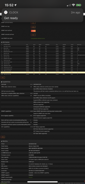

Is my hard drive going to die soon?
9CD057AF-0606-48F4-B0E7-638367871258.thumb.png.f952f272d7ae83725dcd7269d443d5c7.pngHi does this error mean my hard drive is going? What are the main things I should look for?

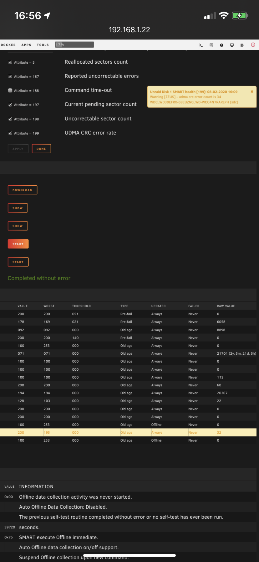

More data supplied
CRC errors are a connection problem, most times the SATA cable, but it can also be the controller, backplane, etc, start by replacing the SATA cable, and note that the attribute doesn't reset, so as long as it doesn't keep increasing the problem is solved.
Thank you I’ll give it a go.
