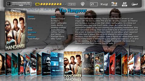

BTW, if anyone is interested in a great way of organizing your movie collection then you might want to take a look at this forum http://forum.wdlxtv.com/ it has a great way of using movie sheets along with the WDTV  Media Players.
Here's an example.

JDM - I've been browsing the forums for some time and you seem to be closest to what I am trying to do.  I have a UnRaid server working nicely with a vanilla WD TV Live Streaming Media Player.  But life with the wife would be easier with moviesheets.  After playing with Plex, I am thinking its okay for my Mac but not useful for the WDTV.  So now I am thinking of the B-Rad firmware hack, and wondering how much effort is there in making those movie sheets. Yours looks good - so what exactly did you use, and was it a manual task...?  I have nearly a thousand movies/TV shows and so I do not want to have to plug along manually with these if I can at all possibly avoid it.
If anyone else has a slick method for this - please let me know....
MJS

See http://forum.wdlxtv.com/viewforum.php?f=18
Most folks use ThumbGen to create movie sheets. It's quite powerful and can be set up to run in automatic batch mode. There are lots of options and a bit of a learning curve though, so you would want to practice a bit in manual mode to get things the way you want.

Mike:  Do you have any questions or need any help?
sorry - I was away last week - but your post and the link is very helpful. I just wanted to know what I was venturing into before going down this road, but you've given me a good insight,  - thanks
Mike
