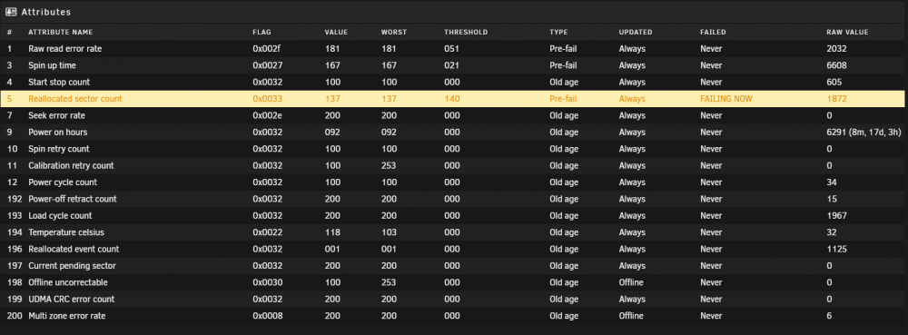

Hey
Just logged onto the GUI to find a data drive is failing/failed due to Reallocated sector count (see image) and also attached SMART report.
Unraid GUI is flagging this drive as disabled and content emulated.
1st question is: could this be getting reported in error? 2 weeks ago I added a new drive and these errors have only just come up - could this be a sata cable issue from when I was adding the new dive?
Otherwise - assuming the drive is failed and it's reporting correctly:
From my quick look online I should take this as dead and get it RMA'd
I'm now trying to figure out best method to get this drive out of the array given the following information:
  • My 6 SATA ports are all being used.
  • I have 1 parity drive
  • 2 weeks ago I pre-cleared and added 1 data drive to the array- it is still empty.
With regards to the last point - do I have an option to remove that empty drive from the array, keep parity and then follow the normal process to replace a failing drive?
Thinking about it I'm not sure if that is any better than just using unbalance to transfer from the emulated drive to this newer drive & then removing the failed one from the array?
Any help appreciated!!
captain-smart-20200208-1754.zip
