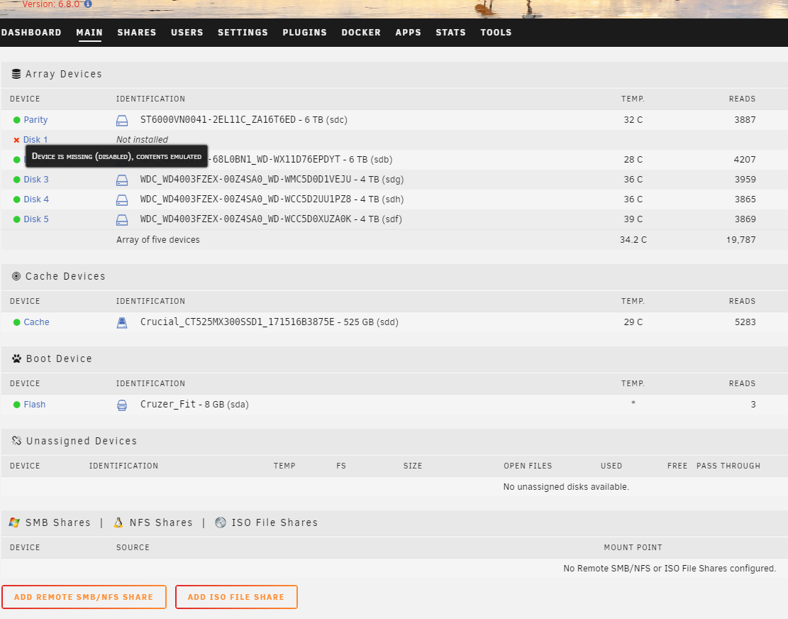

Disk is showing as not installed.
Device is missing (disabled), contents emulated.

The Drive shows as missing/emulated, but I can get to the contents.
From other devices it appears as the drive is still there.

if the disk is being emulated correctly (using the combination of parity plus ALL the other good drives) then you want to follow the procedure documented here to get the physical drive back into a working state and the array protected again.
So basically replace the drive with a new one? Pull the old one and replace with a new and let it rebuild?
Normal replacement
This is a the normal case of replacing a failed drive where the replacement drive is not larger than your current parity drive(s).
It is worth emphasising that Unraid must be able to reliably read every bit of parity PLUS every bit of ALL other disks in order to reliably rebuild a missing or disabled disk. This is one reason why you want to fix any disk related issues with your Unraid server as soon as possible.
To replace a failed disk or disks:
  1. Stop the array.
  2. Power down the unit.
  3. Replace the failed disk(s) with a new one(s).
  4. Power up the unit.
  5. Assign the replacement disk(s) using the Unraid webGui.
  6. Click the checkbox that says Yes I want to do this and then click Start.

I already pulled the drive, and the drive successfully rebuilt on a replacement.
As far as diagnosing the drive that was giving me trouble... Should I put in a spare slot, and run some diagnostics? Or am I better off adding it to a different computer, and trying to analyze it from outside the array?
You could start by posting a SMART report, before or after running an extended SMART test.
