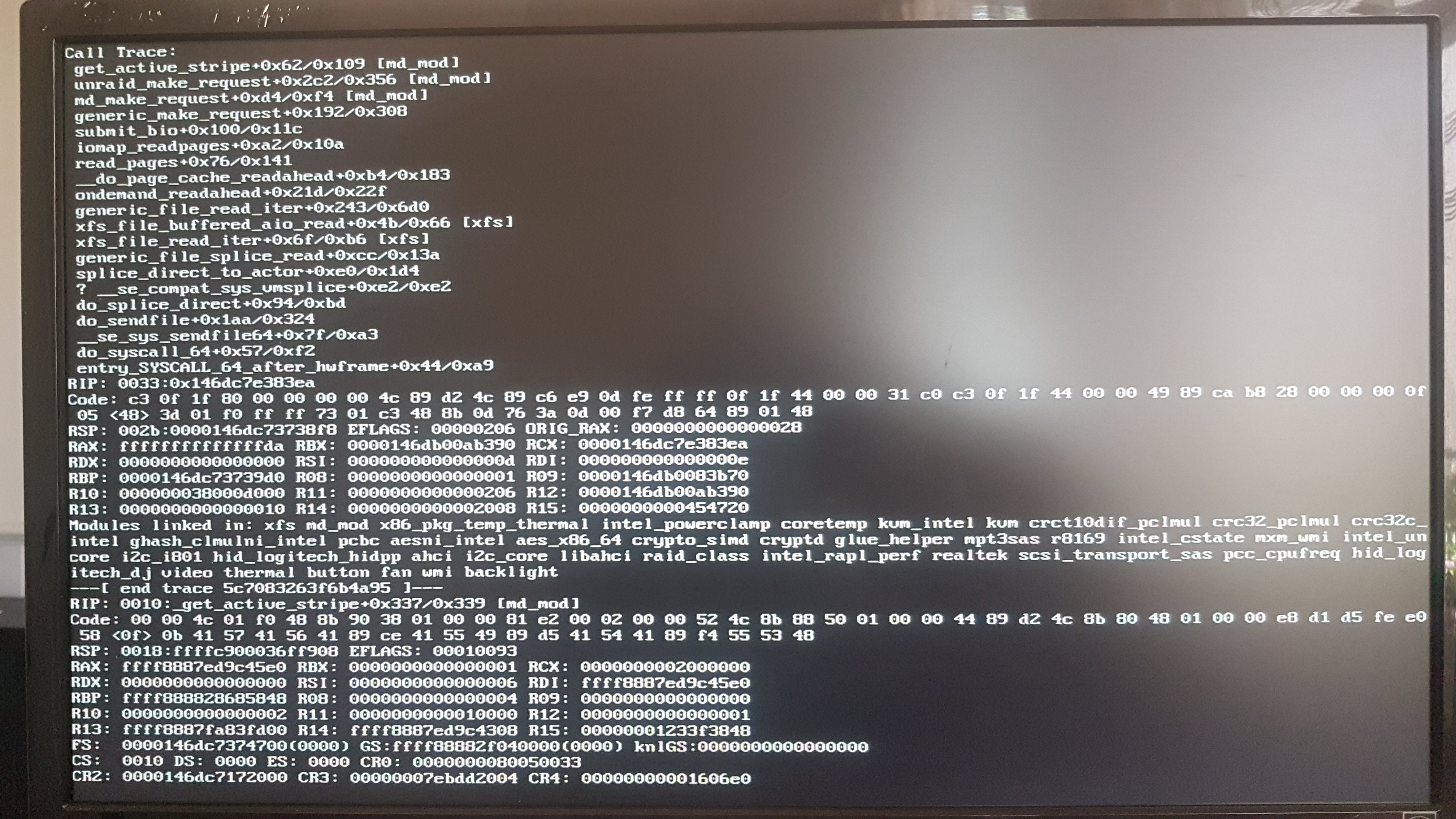

Attached is a photo of console monitor attached to server during one crash last week.  When it happens ts unresponsive to direct attached keyboard.  Requires hard reset
Try running in safe mode for a few hours with dockers/VMs stopped, if it crashes like that it's likely a hardware problem, if it doesn't start enabling the plugins, dockers and VMs a few at a time.
